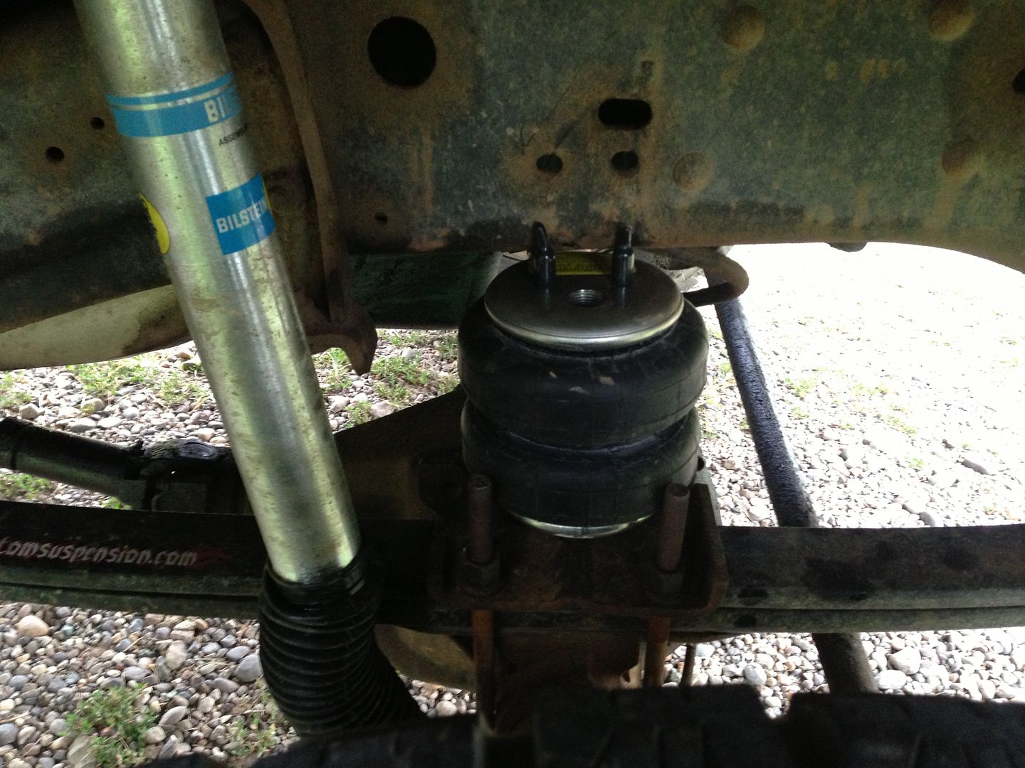

And my airbags came in, they're smaller than I thought they were, making mounts are gonna be easy. :)

I hope that bag works for you. The small cross section may make it ride hard. What were you doing with springs? Removing all but 1 to use as a strut to hold the axle? I can't remember and didn't feel like going back 3 or 4 pages to look. :oops:

They're rated for 2500lbs A piece at 100psi, my front axle has 3500lbs over it so I'm hoping they won't be too pumped up. I'm actually thinking of having a spring shop bend me up a heavier set of main leaves to help locate it a little better. I've got poly eye bushings for it already.
I'm selling these paraboics and I'm going to need a leaf that is the right length for this height. The stockers ain't gonna cut it. :(

What I mean on the bags is I had them on the rear of my truck to hold it up because the springs were sacked. I had 40psi in them just to keep the truck level, it raised it about 3-4 inches. It rode harder than hell, there was no give when I hit a bump. Larger diameter bags work better because there are more inches of surface area to support the load.
Something else that may help, I just remembered an article in the TDR mag about putting a Ping tank in the line to the bag. The tank acts like an accumulator to give the air more room to move when you hit a bump. The guy had about a 1 gallon tank on the line to each bag and he said it made a noticeable difference in the ride.

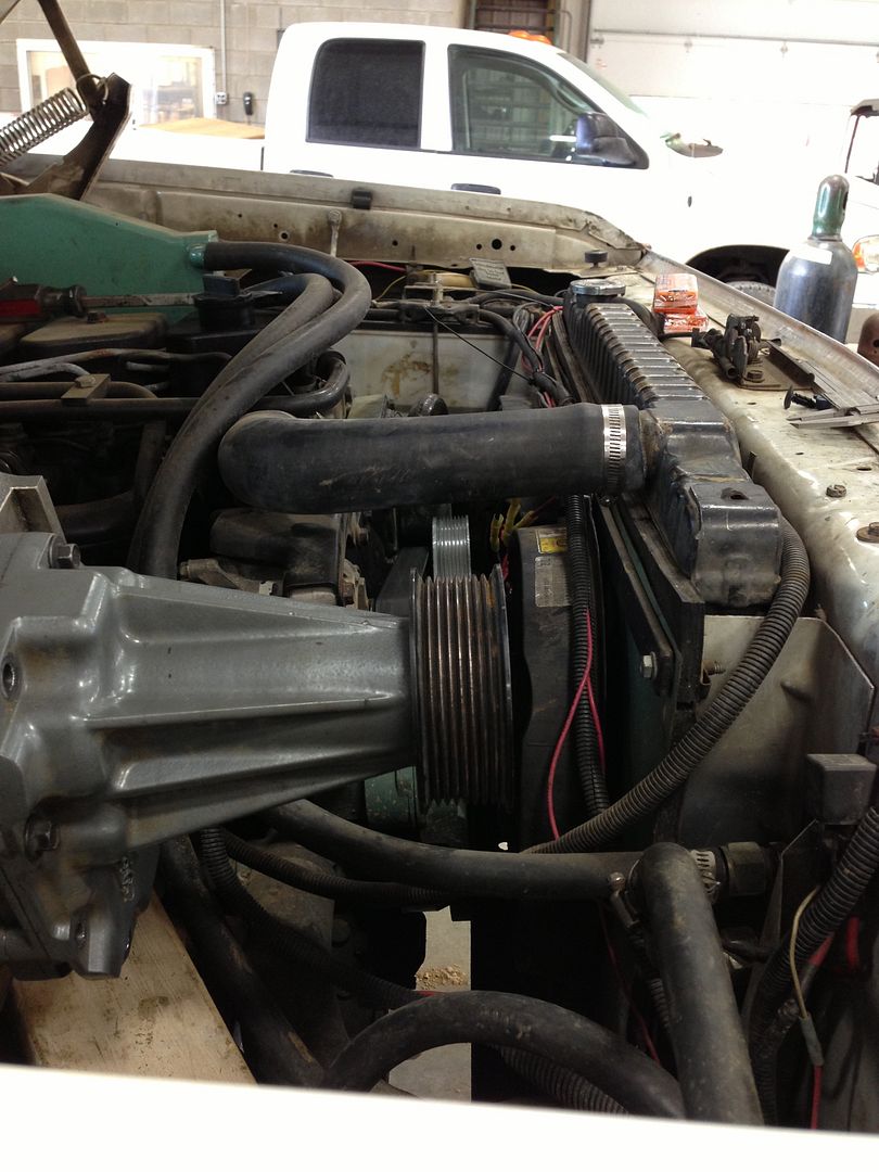

Messed around some tonight, pulled the fender off and farted around. On some advice from Carl over on CompD was looking into getting some more belt surface on the factory fan pulley. I look at rerouting and whatnot but it's not a possibility with the non-AC routing. Instead, I got to messing about with the fan mount orientation. I found that it can be rotated and flipped all kinds of ways on those holes above it in the head. I flipped it up here and I'm diggin' it. Clears everything even better than it before and I've definitely got room for a Fluidampr if I wanna spend the $$. 8)
I'll probably drill out whatever holes I can in the mount since it was suggested I not redrill the head itself.

Got my forward mount done, 3" angle iron cut and hammered around the alternator mount. It's tough enough to support the entire blower and mount by itself easily and I can rock the entire truck with it. I've got to figure out a rear mount as the one I had on there still let it wiggle around a bit.

Proposed belt routing, I've got the screwdriver where I plan to run an idler pulley and I'll have another Dodge tensioner right around where you see me holding that one. I've got to get my idler in place first to make sure there's no contact between the belt and the radiator hose, then I can worry about preventing contact between the inner surfaces of the belt where the tensioner pushes up.
