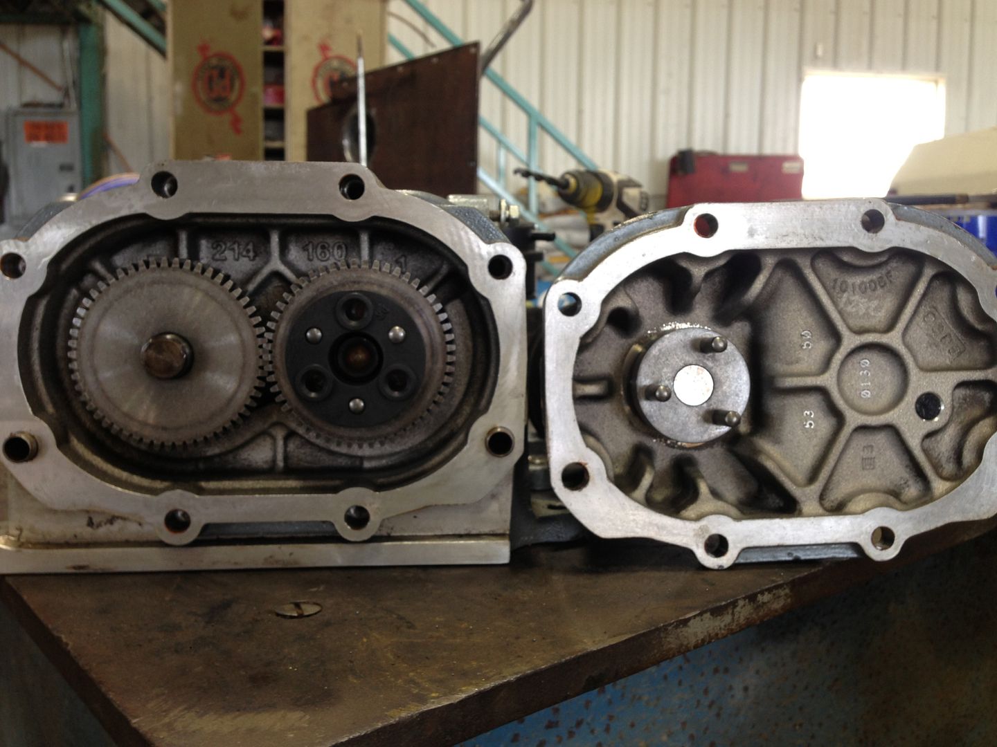

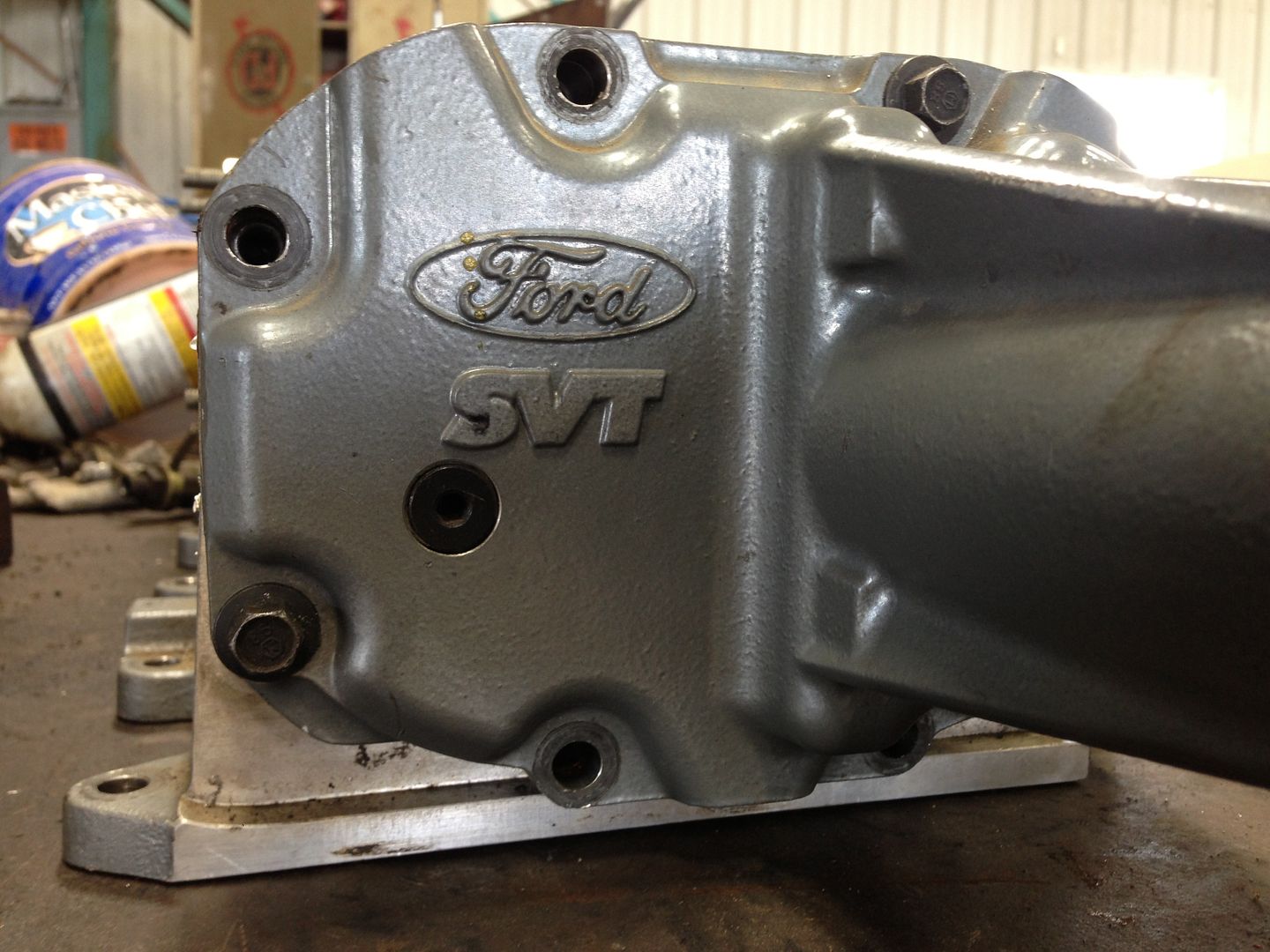

Postby Tacoclaw » Sat Aug 10, 2013 12:43 pm
Here ya go, Ellis.
Little black Allen plug is to fill at, dunno if it runs out or not but recommended amount is 8oz.
Inside the beast. Looks pretty low-stress IMO, maybe having a butterfly randomly opening and shutting off its air supply is rough on it or something but I see this thing living the easy life on a diesel.
