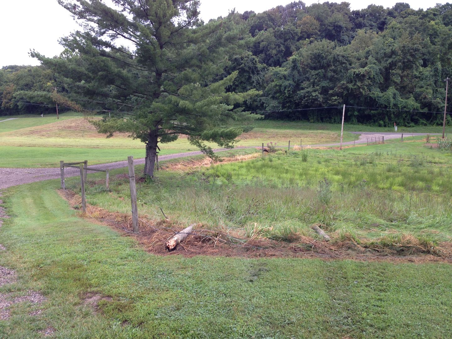

"Hey, man, I just want you to know how much I appreciate all the work you've been doing on me lately, so to prove it I'm going to roll out of the spot you've parked me in for 3 years, through two fence posts, and park myself in the everlasting wet spot down in the field where the tractor gets stuck every time."
:roll:
Not a single scratch on it, can't even see a scuff where those posts hit the bumper. I'm having starter troubles as well now, it's not wanting to start again. Some kicking of the column used to solve it but it looks lie I'll finally have to buy an ignition switch... At least it gives me an excuse to pop the hood in public when I have to jump the starter terminals. :lol:

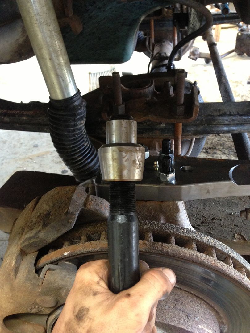

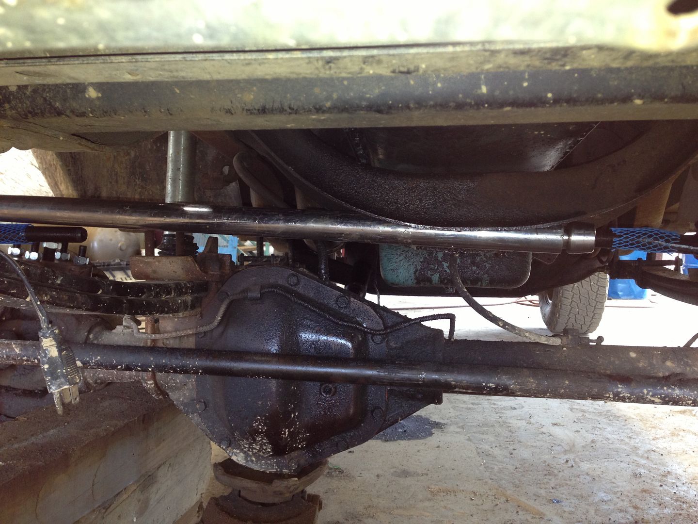

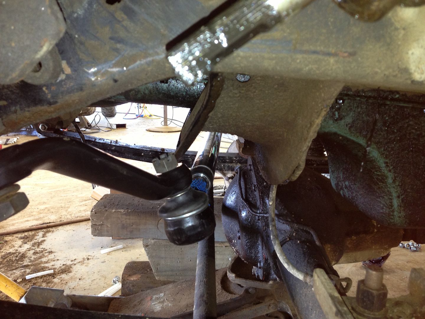

Postby Tacoclaw » Tue Aug 20, 2013 3:25 pm

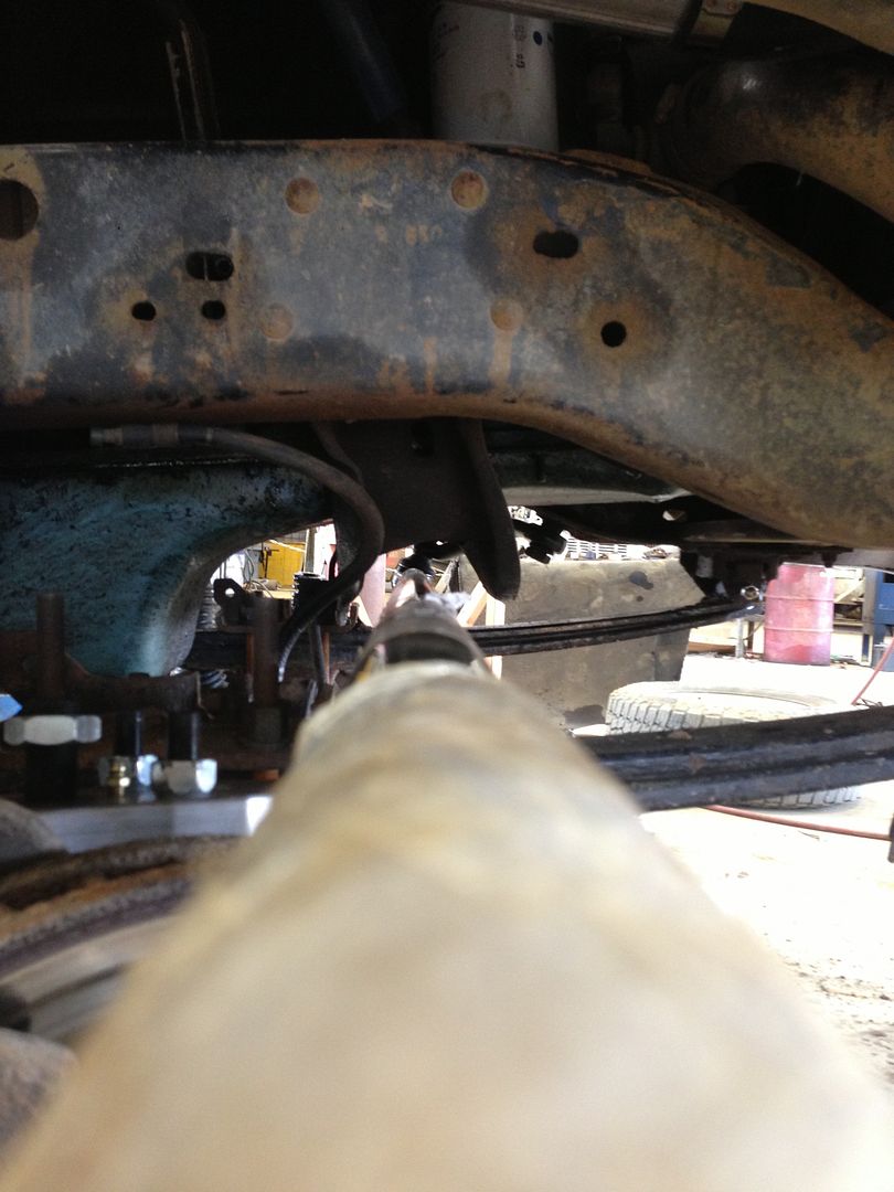

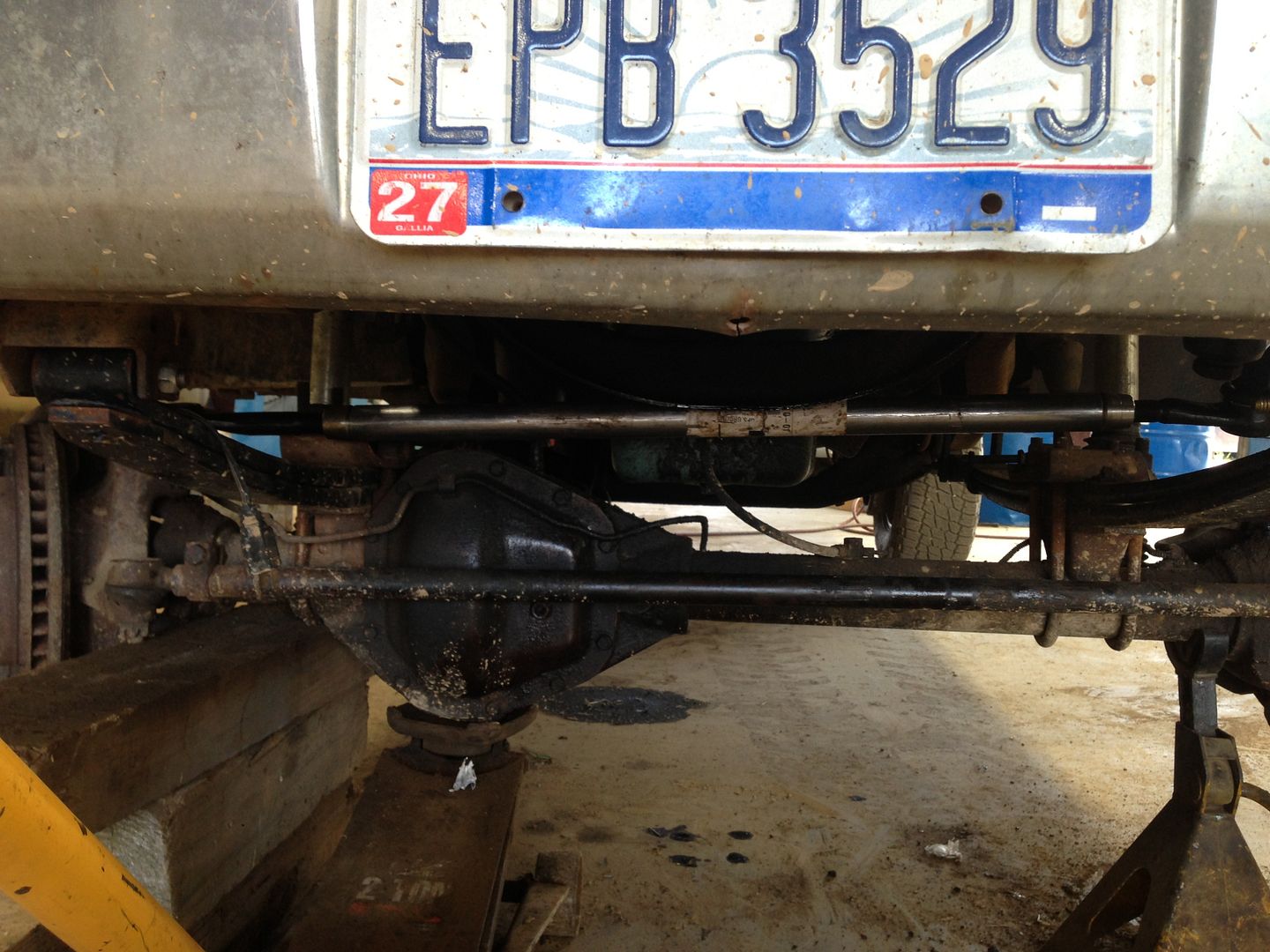

A couple pics of the crossover steering so far. Lessons learned as of quitting tonight are that the 2wd pitman arms seem to have a smaller hole than the 4wd ones and if you're trying to get a rod end out of its hole that you just loosely stuck in by hand it won't come free until your fingers are between it and something sharp and solid. I'm down 3 digits so far. :lol:
Any questions, ask away. I'll fill in some info when I get home tonight. Looks like the motorcycle for me in the morning. :grin:
:edits:

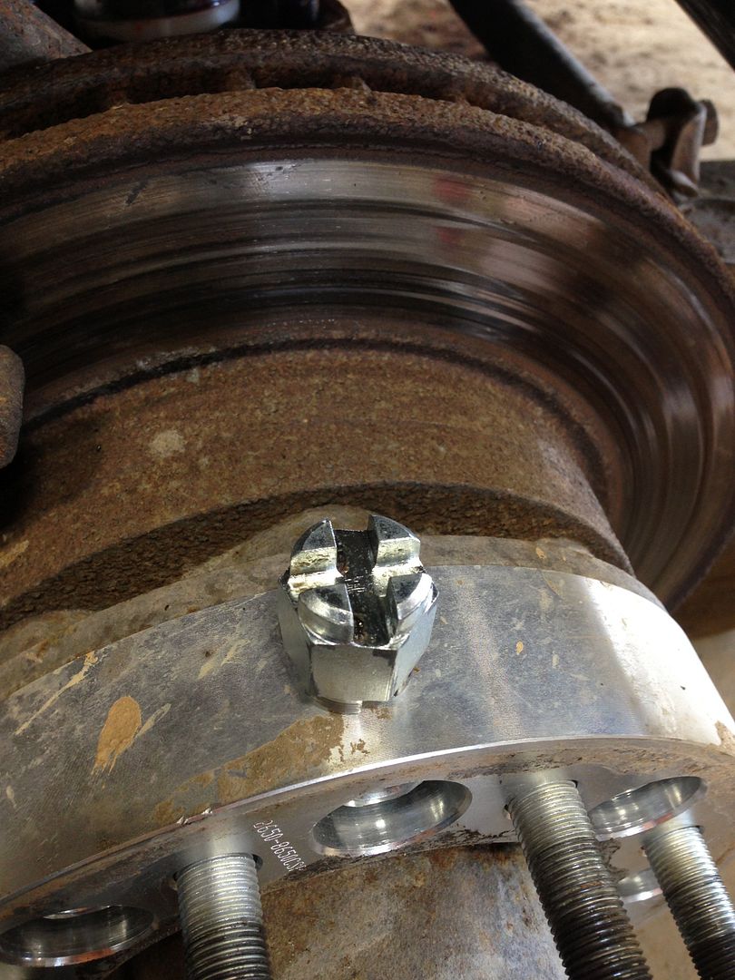

Here's some kind of lock that was sitting inside the brass kingpin bushings. The springless kingpin caps I'm using have a big washer that sits on the plastic part of the bushings and it would interfere with the locks so I pulled them out. I keep my truck pretty well greased and it seems to take about 800lb/ft of torque to break the brass parts loose so I'm going to pull them out. I'll keep them around just in case, but I doubt they're really necessary.
4wd Borgenson shaft setup with a 2wd steering location. Ain't gonna work. :(
This is the weld-in bugs they send you with the kit. No crap here, this whole deal is really nicely done. I think the tube they sent weighs more than my entire tierod and it's 1/2the length.

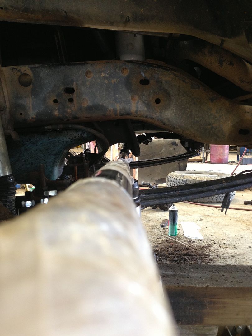

Postby Tacoclaw » Tue Aug 20, 2013 3:59 pm
More.

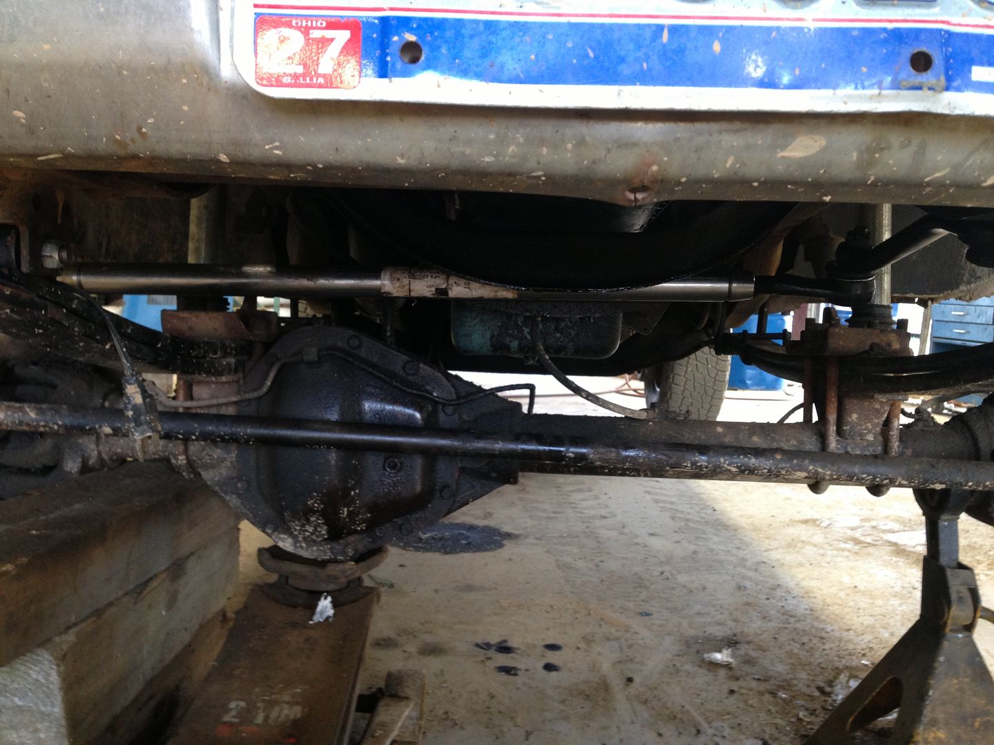

Postby Tacoclaw » Tue Aug 20, 2013 5:46 pm
Heh, how about a 2wd borgenson shaft, RC, you have access to such a creature? As you can see in the 6th picture down my 4x4 one ain't gonna make it anymore. :(
I took the steering box and shaft off Tyler's old 2wd but he welded up the slider piece that connects the shaft to the splines on the box. It seems to work, but incredible unsafe may be a bit of an understatement. :lol:
