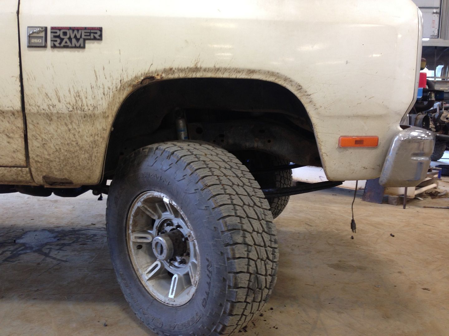

Also, I'm slapping the steering stops on the C's waaaaaay before I hit the internal box stops now. I've got to clean off all the crap and grease off my u-joints and see where they actually start making contact. Gonna see how sharp I can get it to turn. :grin:

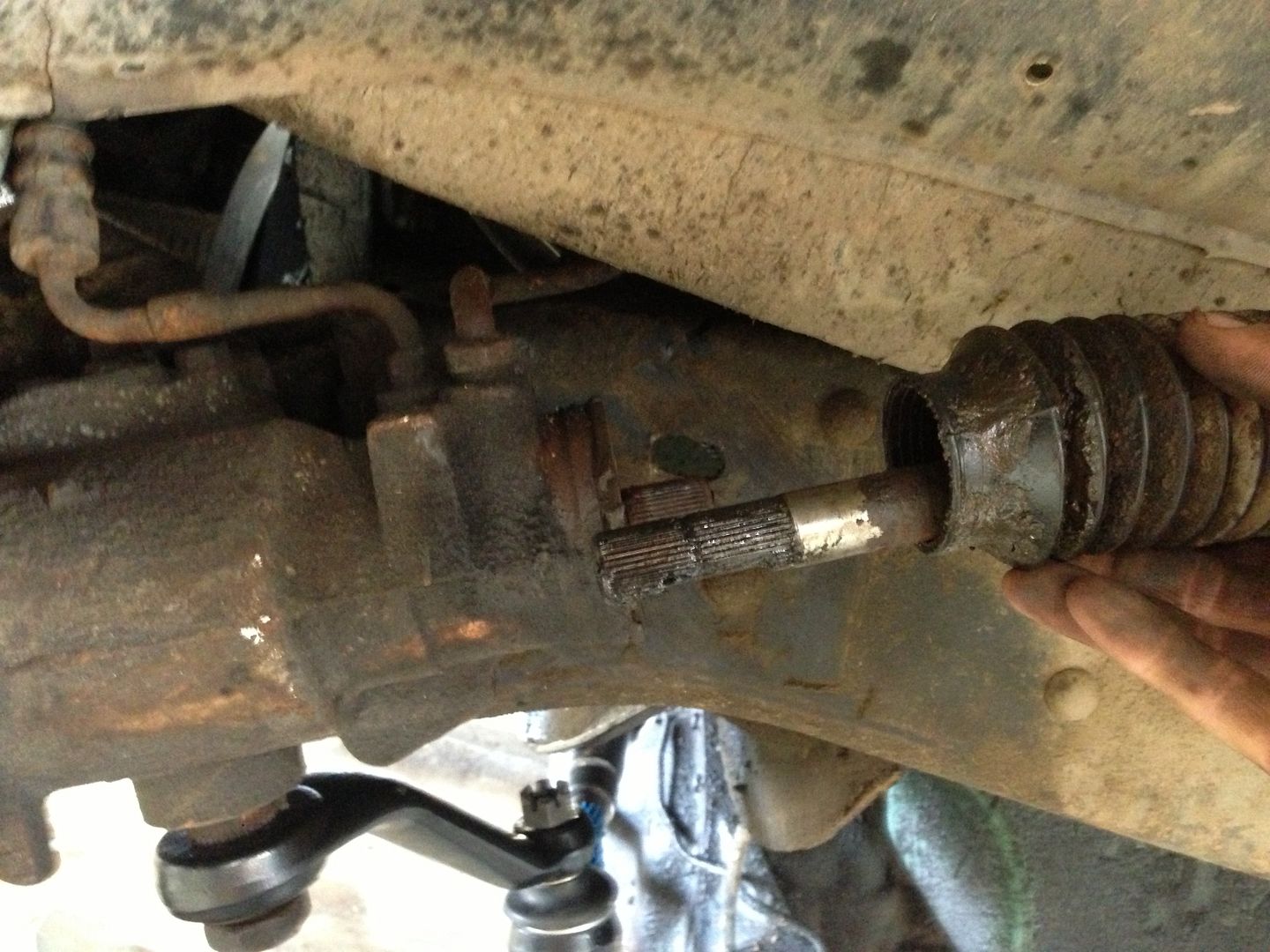

Aren't the 2wd and 4wd steering arms the same? I've never seen Borgeson offer one specific.
If they do, no issues there. But that would be new to me.
From the pic......is your shaft too short now?
Re: '90 W250
Postby Tacoclaw » Tue Aug 20, 2013 6:40 pm
I dunno, I know I couldn't get the tierod end through the 2wd arm very easily. It went through the new 4wd arm easily, I was able to shove it through clear to the taper, I couldn't even get all the threads through the old 2wd arm.
My steering shaft is too long now, the 2wd position rotates it counterclockwise in the pic, it's probably 1 1/2" too long now.

Tacoclaw wrote: 2wd borgenson steering shaft
'90 model D250, keep the rag joint.
Re: '90 W250
Postby Tacoclaw » Wed Aug 21, 2013 6:12 pm
Dunno what wild shaft they've got designed to work on either a 2wd or 4wd but I had to cut 3.5" out of mine to get it to work. Works like a charm though, so scratch the Borgenson, RC. Maybe some injector work or something when I finally get this blower sorted. ;)
The steering is super-tight now, I'm still working some air out of the system so I can't comment on it completely yet, but it's definitely upped my steering effort some. I'd say I lost at least 1/2 turn lock-to-lock on the wheel, so that probably explains it. Still pulls left some, but I'm guessing that's a tie rod adjustment issue...

The borgeson shaft is telescopes a long ways. It's really short fully collapsed. Glad you fixed it up yourself.

Maybe this is an older version or something but my Borgenson doesn't telescope at all. It's got a flat spot built into the splined portion that a roll pin sits in. On the shaft the flat section is elongated about 1.5", but like I said I had to take 3.5" out of it to get the roll pin to sit in the middle of the flat part.

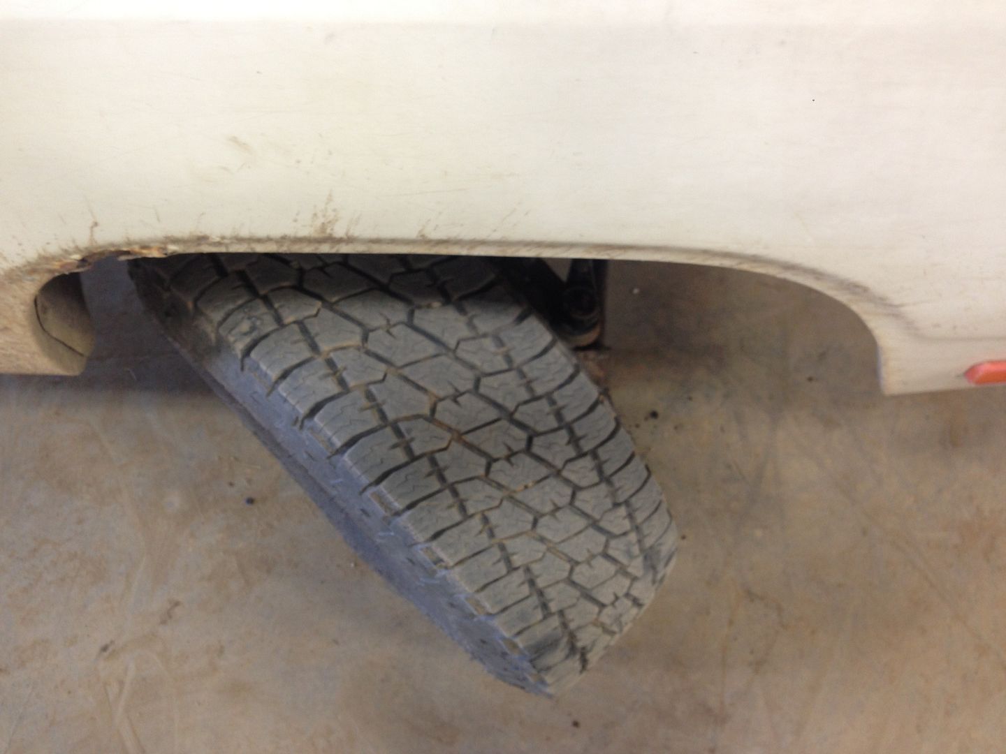

Dat lock. 8)
I pulled the steering stops to see what she'd do, way past u-joint bind to the right and just past it to the left. Gonna adjust stops to just before them and enjoy. :grin:

Shoot :shock: you might be able to parallel park with that much wheel turn :lol:

Oddly enough, I have barely any threads still out on my driver's side knuckle but the passenger side has almost all of them. Pretty much equal turning angle, I'm not sure what the deal is. ;?
