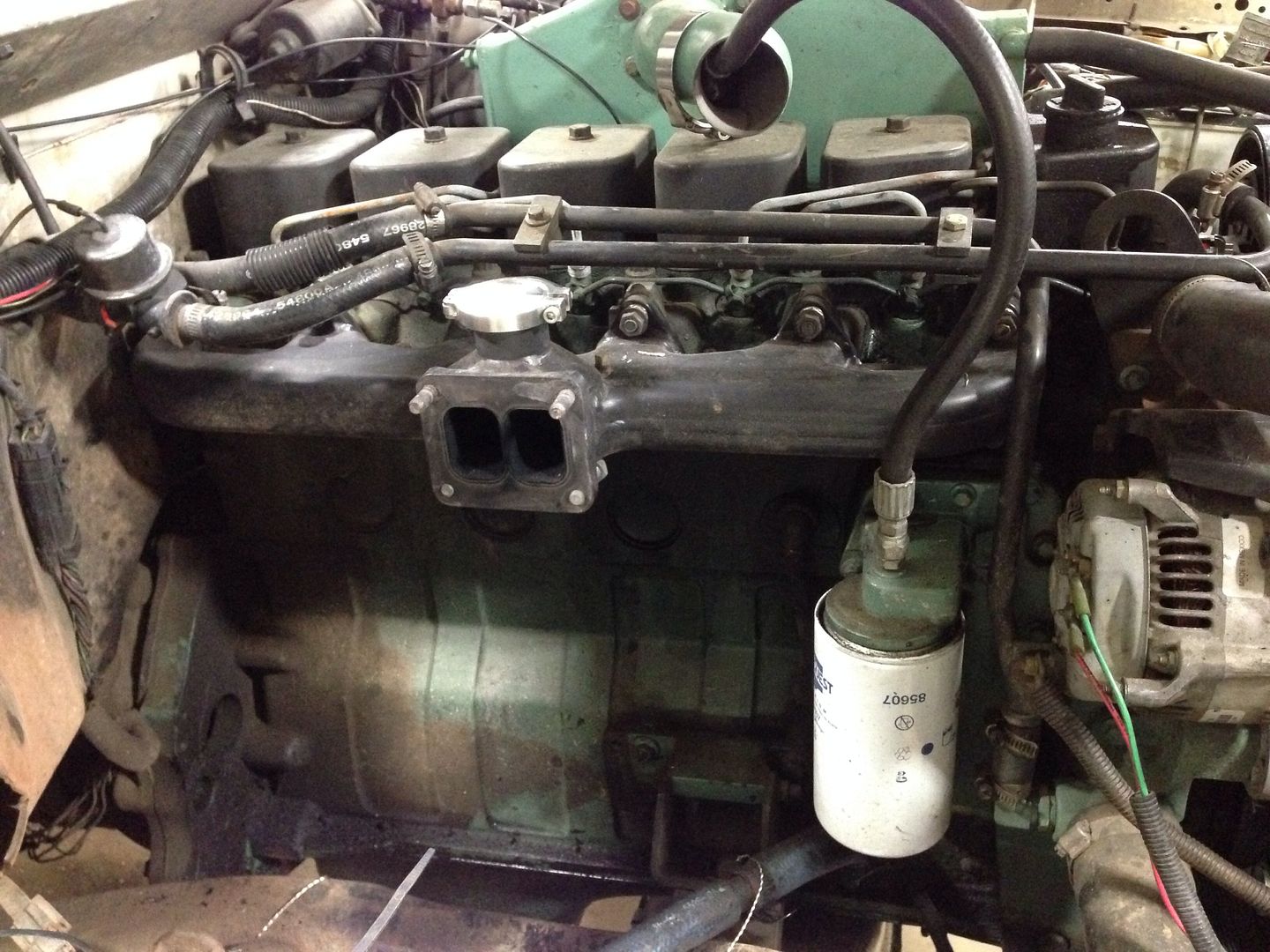

I've been putting off working/painting on this thing because I didn't want to take the dodge down for any length of time. My other DD needs tires and I don't feel like buying them, so it's dodge or nothing right now.

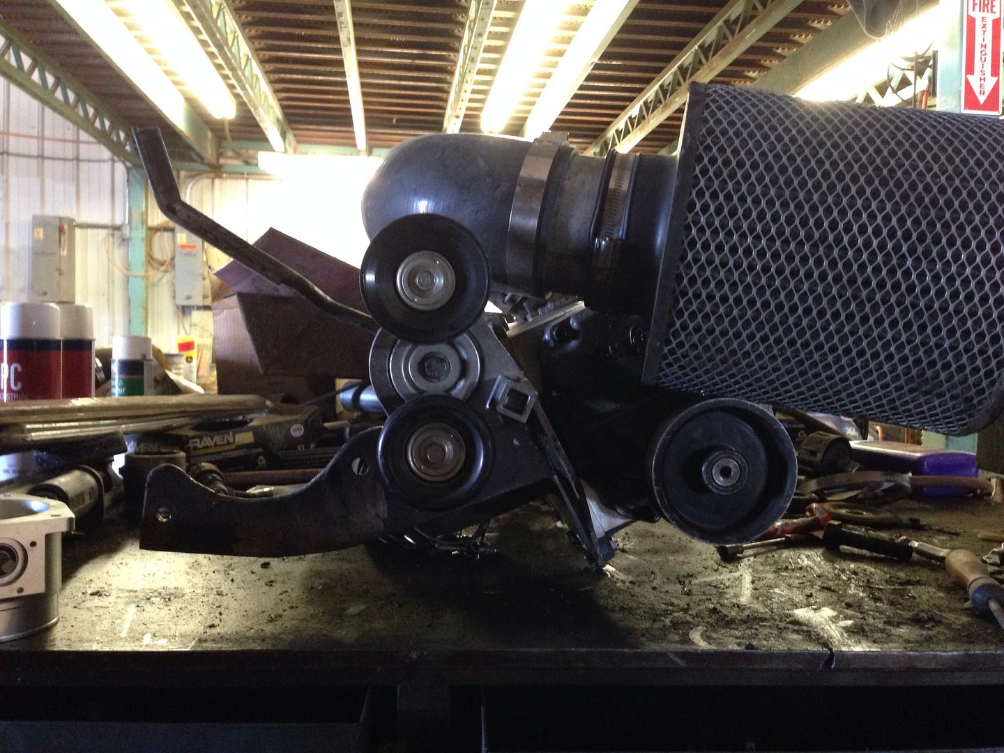

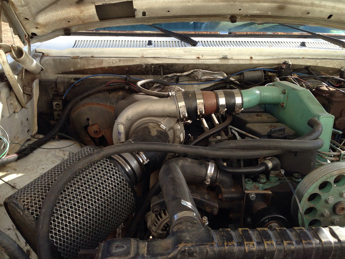

Then I just randomly remembered that there was technically only 4 bolts and a belt holding the thing on, so I decided to see if I was right after work this evening.
It took me 15 minutes to get it out of there and the filter stuck back on the turbo inlet. :lol:
So I'm back to a single turbo for now. I'm going to jump 2 teeth on te pump and pull the pump back to the beginning of the slots, while I paint all that crap. Here's some pics to enjoy. :)
Driving it back home as a single tonight was hella weird. I guess you never really knew what you had until it's gone, but this thing is a turd without that blower. You could drink a gallon of milk in the time it takes that turbo to spool, and it's hella smoky once at full song. Still makes 45psi, even with the AFC so choked down, but it's really falling on its face up top.
I'm gonna try to fan up my bypass as well while it's off, because once it's painted we all know it ain't coming off again. :lol:

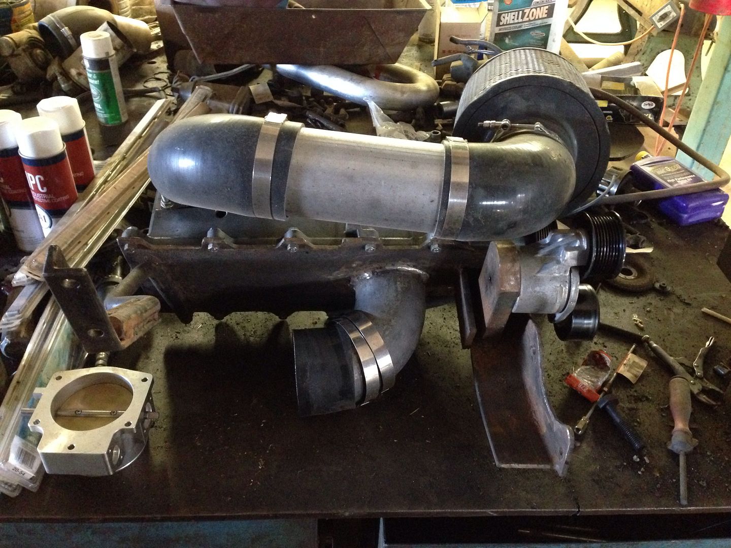

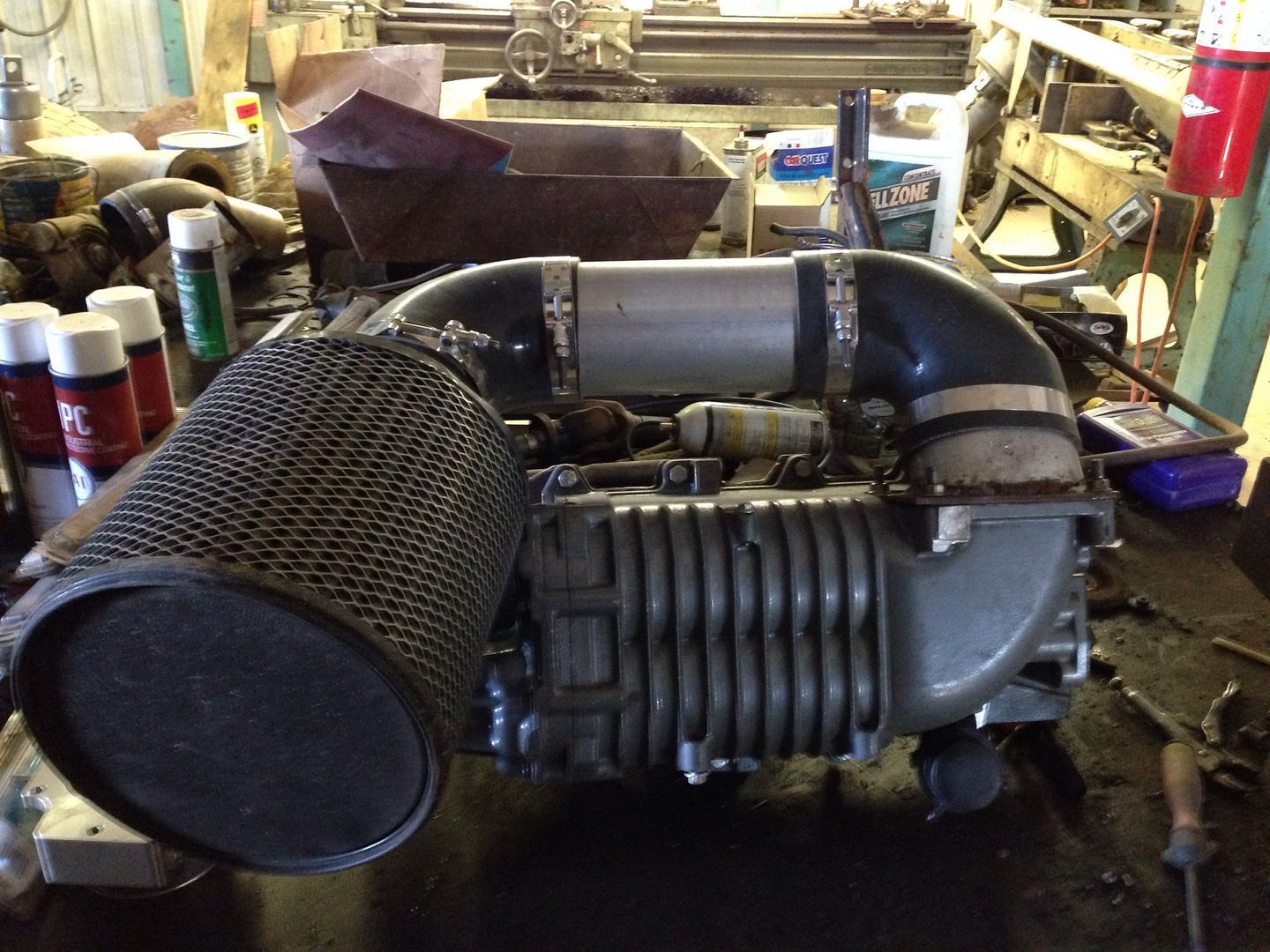

Extreme early mockup pic:
I'm figuring on welding a short, steel 45* pipe to the turbo inlet pipe, a short coupler to the TB, then making a plate off the blower inlet pipe for the TB to bolt to, all 4" holes. The flow path sucks balls, but it's all I left myself to work with so that's what it's getting.

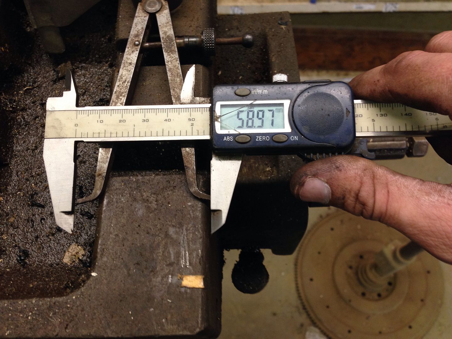

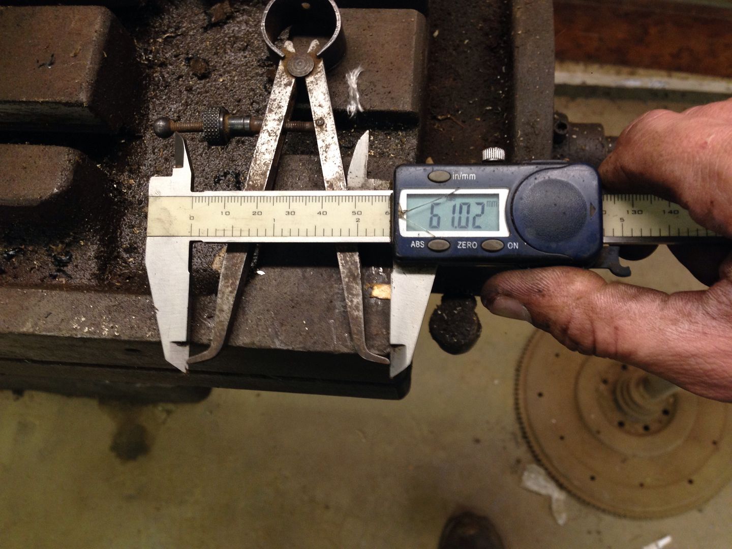

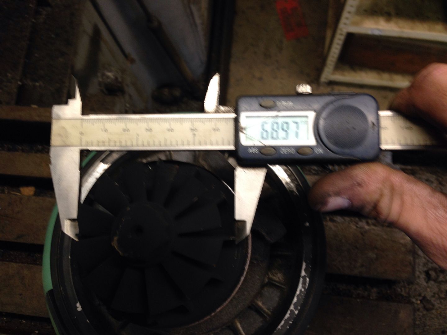

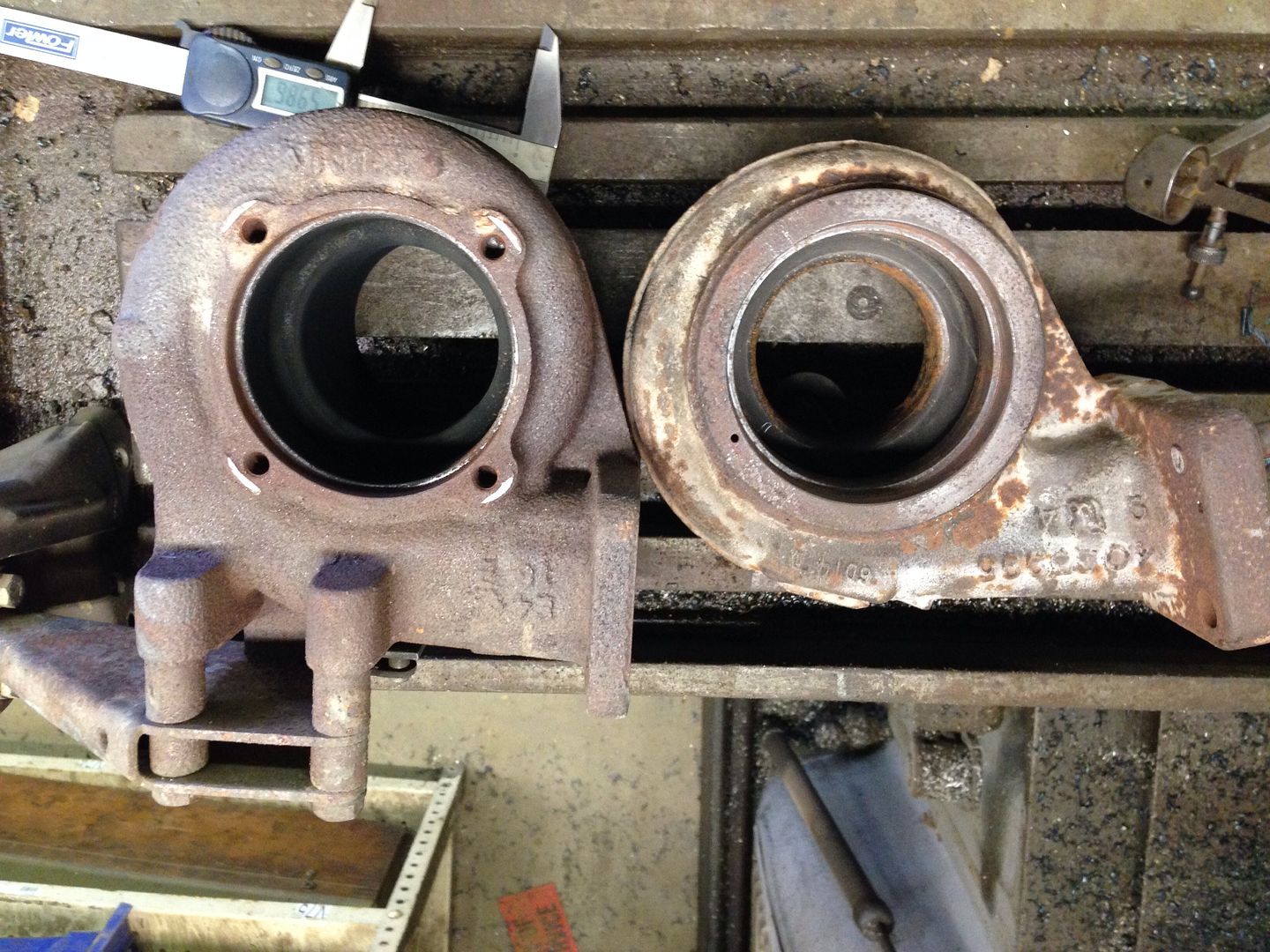

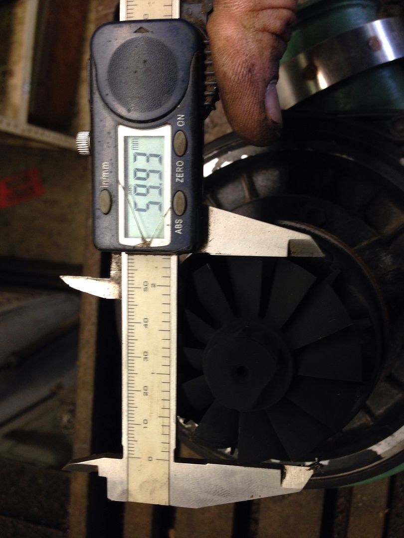

So, I'm working on a little side project for DodgeFreak. I'll let him explain the specifics, but it involves being able to fit an hx35 turbine wheel in his HE351cw turbine housing. I've got an H1C that I ran an HX35 housing on while I was between turbos, so I used its wheel to get my measurements.
Housing comparison:
Turbine housing exducer of 351cw:
Turbine housing exducer of HX35:
Measurement of H1c wheel exducer:
And inducer:
Looks as simple as boring out the exducer to 61mm on the 351 housing, nothing else will interfere in there that I can tell.
Thoughts?

Also, I didn't get any pics of it but the turbo is off the manifold and the blanket is ready to go on. I figured since I had it down this far I'd go ahead and do it. Pulled off my external 'gate and put my cover on, then started fitting the blanket.
I ordered some pieces of 4" exhaust piping to make a new intake setup, Carl informed me that he had little luck trying to make both inlets share a filter, so I'm piping for twin inlets now.

Postby Tacoclaw » Sun Nov 03, 2013 6:31 am
Grabbed a pic of where I stopped last night before I got started, it's always nice to see how dirty this thing gets.
And also a pic of my project while the silicone dries on the manifold blanket. This may have something to do with my troubles defrosting. :lol:

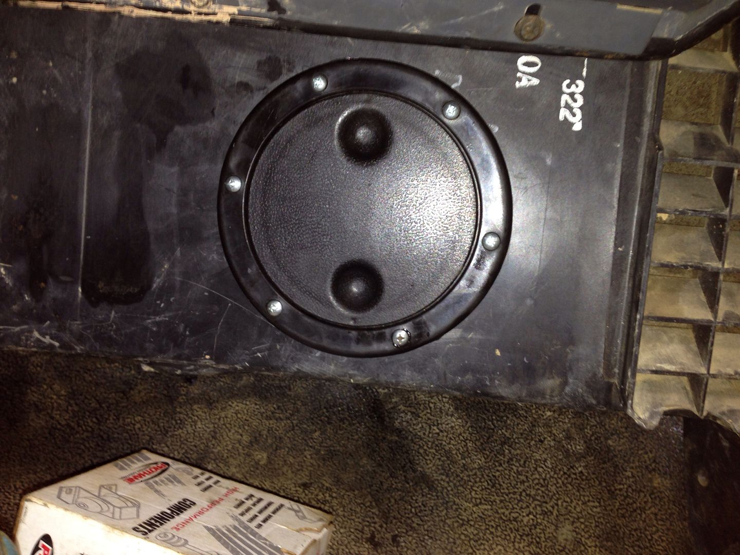

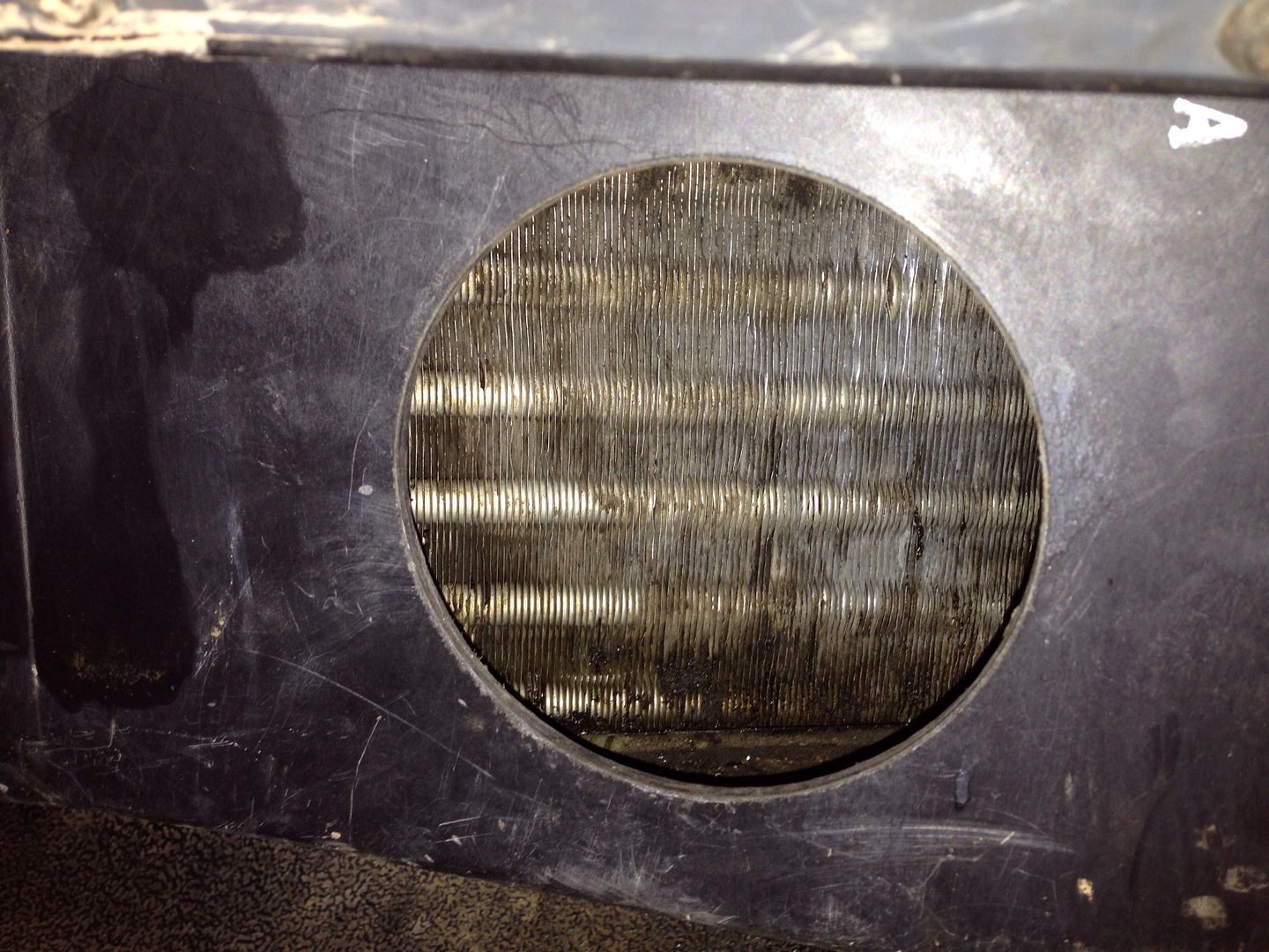

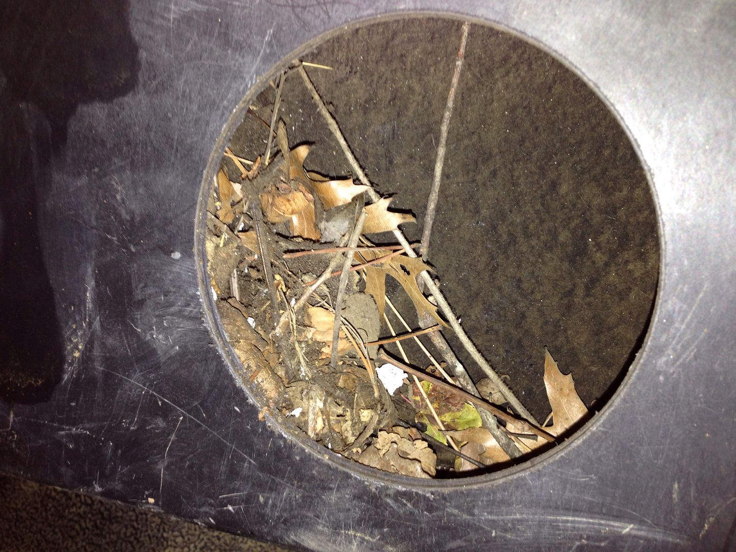

So, did you guys know that when you turn your fan on air is supposed to come out of the vents? I had no clue.
Big thanks to "Carrnut" over on DTR for this idea, it worked great.
8)
