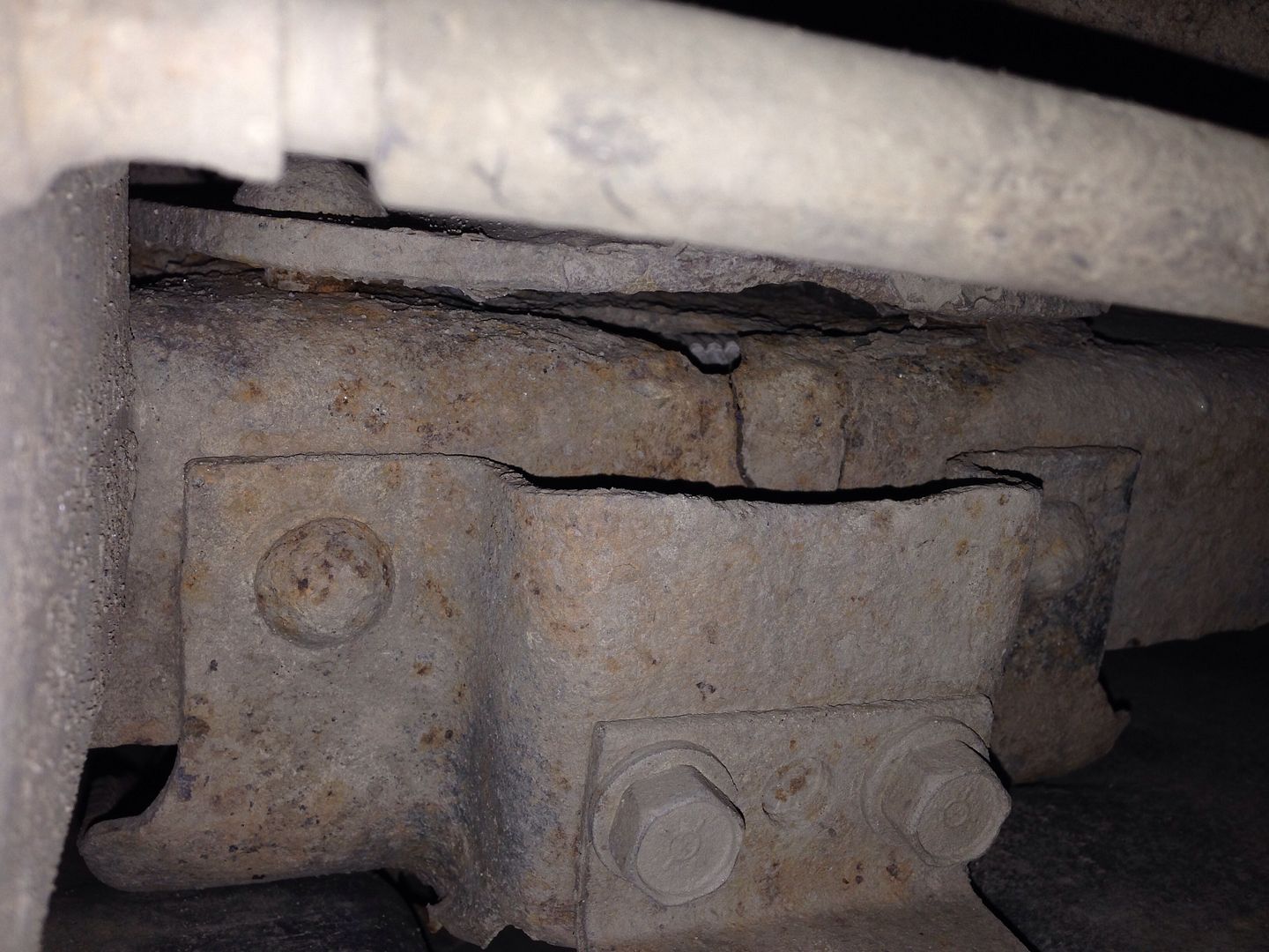

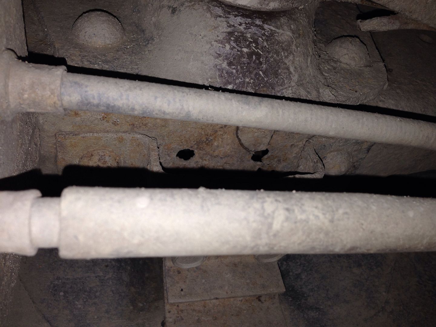

I also found this while I was rolling around under the truck, measuring around for a rear traction bar. I've cussed that damn fuel tank for years for not letting my oil leaks get to that part of the frame. Looks like trouble may be brewin'. :(

I'd say that frames broken right there! :shock:
Re: '90 W250
Postby Tacoclaw » Sun Nov 10, 2013 6:44 pm
Meh, that sthi'll buff out. :mrgreen:
Re: '90 W250
Postby PToombs » Mon Nov 11, 2013 6:46 pm
The crack or what it causes? :jumpsmile:
Re: '90 W250
Postby Tacoclaw » Mon Nov 11, 2013 7:59 pm
My bed and cab have had plenty of contact from my recent trail excursions, maybe if I'm lucky it'll just settle ever-so-gently into the pockets it made for itself and I won't even notice.
Orrrrrr maybe I'll find out how rusty my bed is when it's all that's holding my frame together. :lol:
Re: '90 W250
Postby DodgeFreak » Mon Nov 11, 2013 9:19 pm
Just put a little jb weld in there and itll be like new!
Re: '90 W250
Postby Tacoclaw » Tue Nov 12, 2013 4:22 pm
I guess I'll pull those Jungle shackle and springs off the RC frame and put them on the Dodge. I'll have to drop the tank regardless, so I'll try to patch the frame some. That'll also move the spring mount away from that spot, so hopefully it'll take some of the stress off of it. Another bonus is it'll let me try out the Chevy leaves, and possibly ditch the rear blocks.

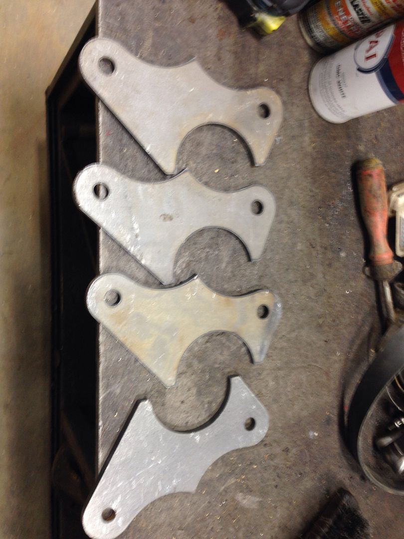

Also, I noticed my water pump was seeping from the weep hole, so I decided it was time to bag my front suspension. In going for a linked, radius arm setup. Going with adjustable upper and lower links, with poly bushings at all joints. ~48" lower links, 2" .250 wall square tubing, haven't decided on the upper materials yet. I want them adjustable so I'll be able to match them to whatever ride height I find the best.
I figure I'll just cobble up a bag mount off the current spring mounts, the only major interference I see is the brake lines and shocks. I've got a plan for the shocks, still mulling over the brake lines. Also need to make a track bar, but I'll figure it out once I get my ride height and caster set up.
