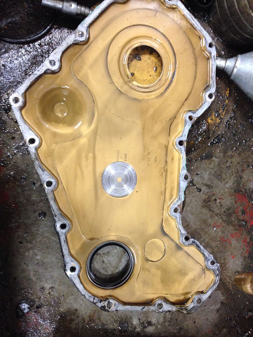

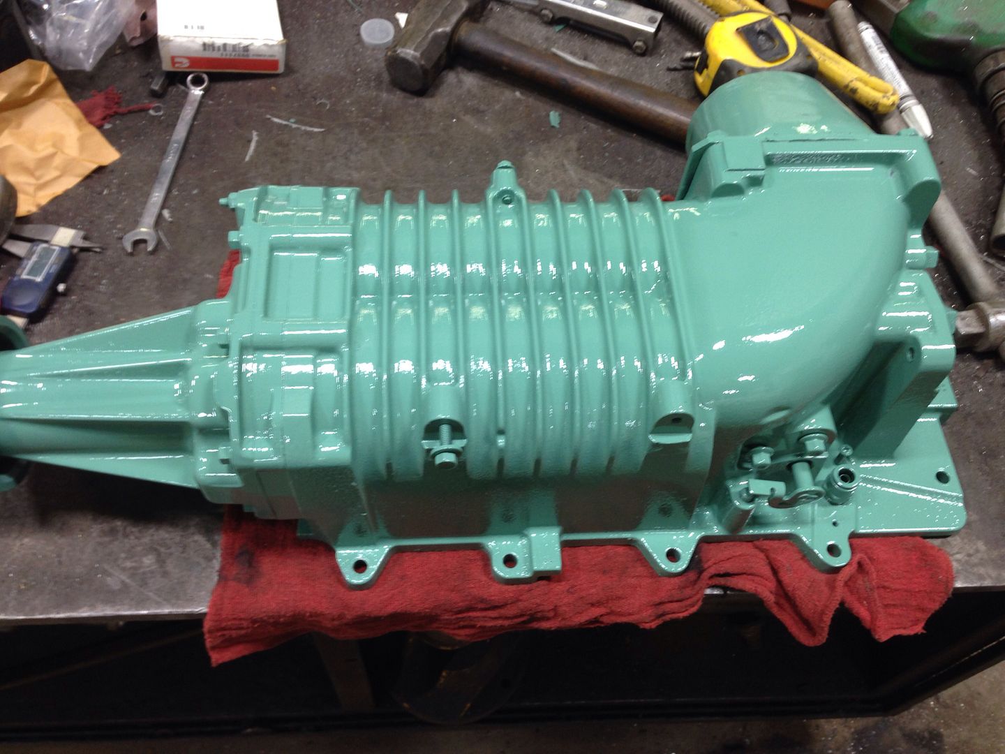

Soooooo, did some painting:

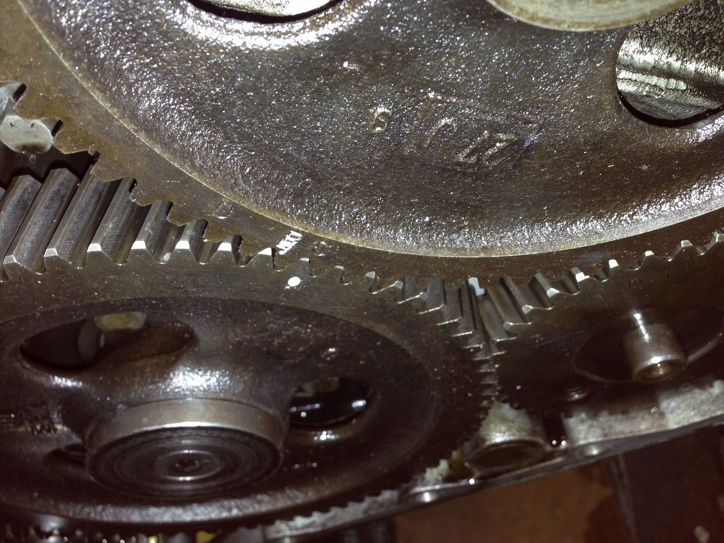

And some tooth-jumping. I think that cam retainer may be a bit thick. :lol:
The cam isn't walking, I checked.
I left the pump against the head, it sounds rattly on free-rev but unless it drives bad I don't feel like moving it.
Gonna grab some food while it all dries, then it'll be final assembly when I get back. :D
