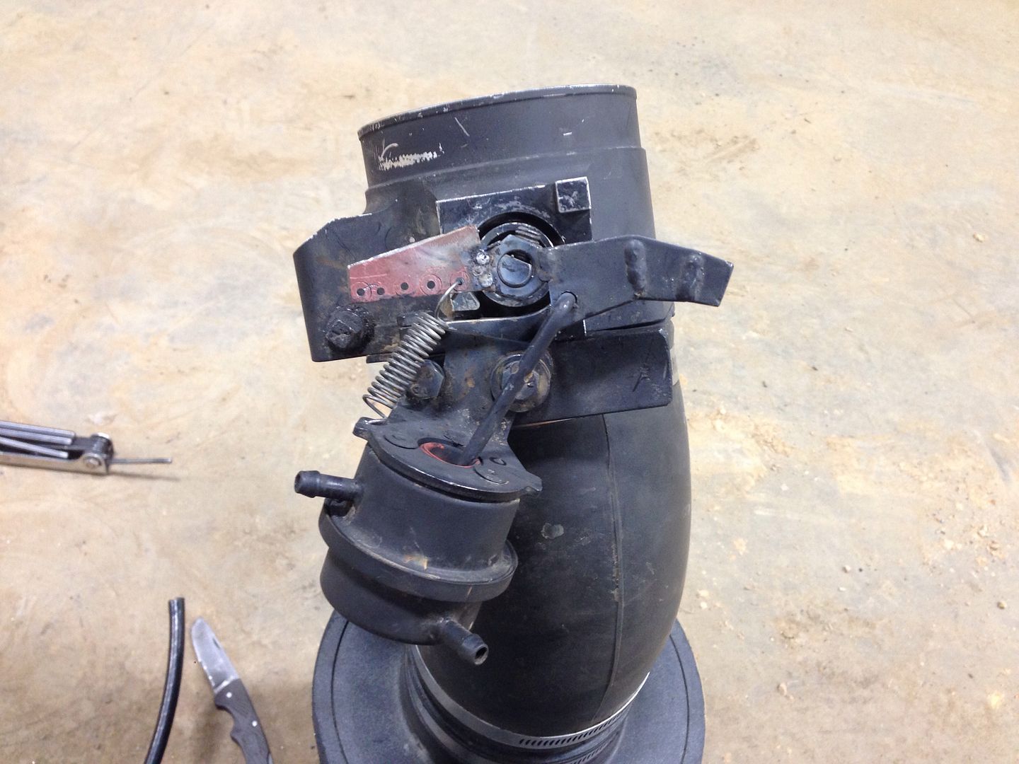

I've got to trek over to Hiney's sometime this week and have him run the camera for me. I found the return springs that the throttle body came with so I'm going to try to put them on tomorrow evening. Have it hold the TB closed longer.
Even a slight load will spool the turbo enough to open it up, and a 4" hole doesn't *kinda* bleed off boost. When that sucker cracks even a little it dumps all the blower boost. It still drives a lot better, I just think if I could keep the blower boost a little longer it would help spool the turbo that much more.

Postby Tacoclaw » Tue Nov 19, 2013 6:36 pm
I dug deep into the most desperate areas of my fab skills for this beauty. :lol:
It seemed to help a lot, idle boost is back up to 2psi and there's not as much of a gap between blower bypass and turbo spool now. I also brought the timing back down to the middle of the slots, and unhooked the AFC to make sure mommy isn't putting on a smoke show for everyone.
With no AFC, max boost is 20psi. It's not very wild up top anymore, but whether that's mostly because of the AFC or the timing drop I don't know yet.
I've also developed a belt squeak at any interstage pressure above 5psi. I blame this on the paint I put on the drive pulley, and as such will never paint anything I own ever again. :mrgreen:
