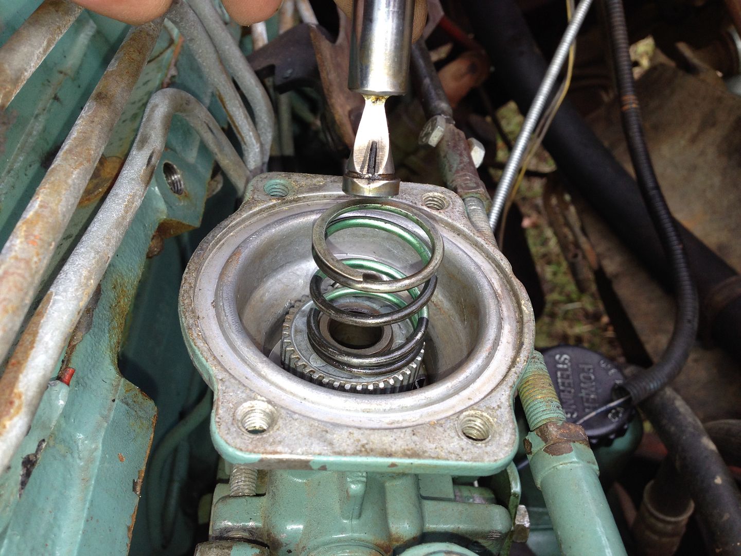

Postby Tacoclaw » Sat Nov 23, 2013 10:51 am
Bumping my fuel back up a little bit to see what happens, figured I'd document pin travel with the star wheel flipped. You can see, there's around 3 threads showing above it and I've got the green/black spring.

Postby ellis93 » Sat Nov 23, 2013 3:25 pm
Newb question..... What's the significance of the green/black spring? Heavier spring?

Postby cmann250 » Sat Nov 23, 2013 3:37 pm
ellis93 wrote:Newb question..... What's the significance of the green/black spring? Heavier spring?
It's lighter compared to the silver/no color Non-IC ('89 only?) spring. I have the silver spring and it's a stiff SOB.

Postby AHineman » Sat Nov 23, 2013 3:51 pm
But not quite as light as the green/pink IIRC.

Postby ellis93 » Sat Nov 23, 2013 5:10 pm
That's the one I have ,green/pink. Guess there's different springs for different year trucks?
Re: '90 W250
Postby AHineman » Sat Nov 23, 2013 6:07 pm
Pretty much I think. Some people may know which spring was in which number pump, but I just thought they were stiffer in the non intercooled trucks and were weaker in the later ones. I could have sworn I've seen Bill post about this before. Maybe he'll share some knowledge. 8)

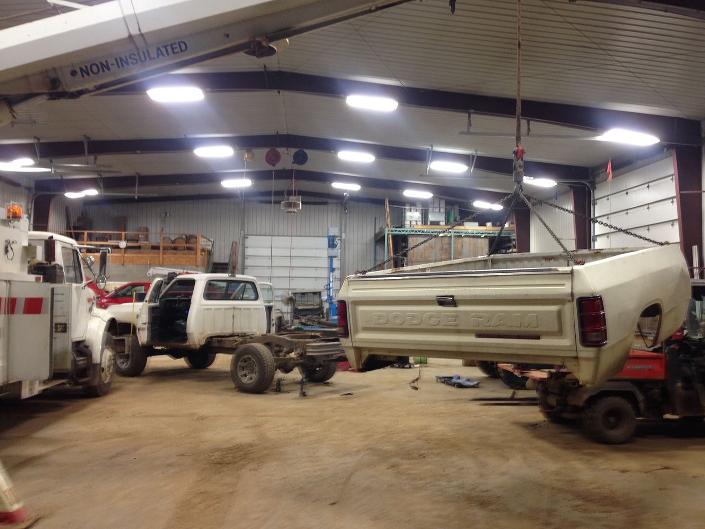

Re: '90 W250
Postby Tacoclaw » Sun Nov 24, 2013 10:35 am
Little update...
I was going to document the differences between the truck and RC frames, since that's what this shackle kit is for. My phone would be completely out of memory at this point, I have no whAt? clue what is going on. :lol:
It all bolted up perfectly on the RC frame, but this truck is trying to pull the DS apart just bolting up the rear hangar. On one side.
I think I may just be bolting up these hangars and running the hybrid leaves for now.

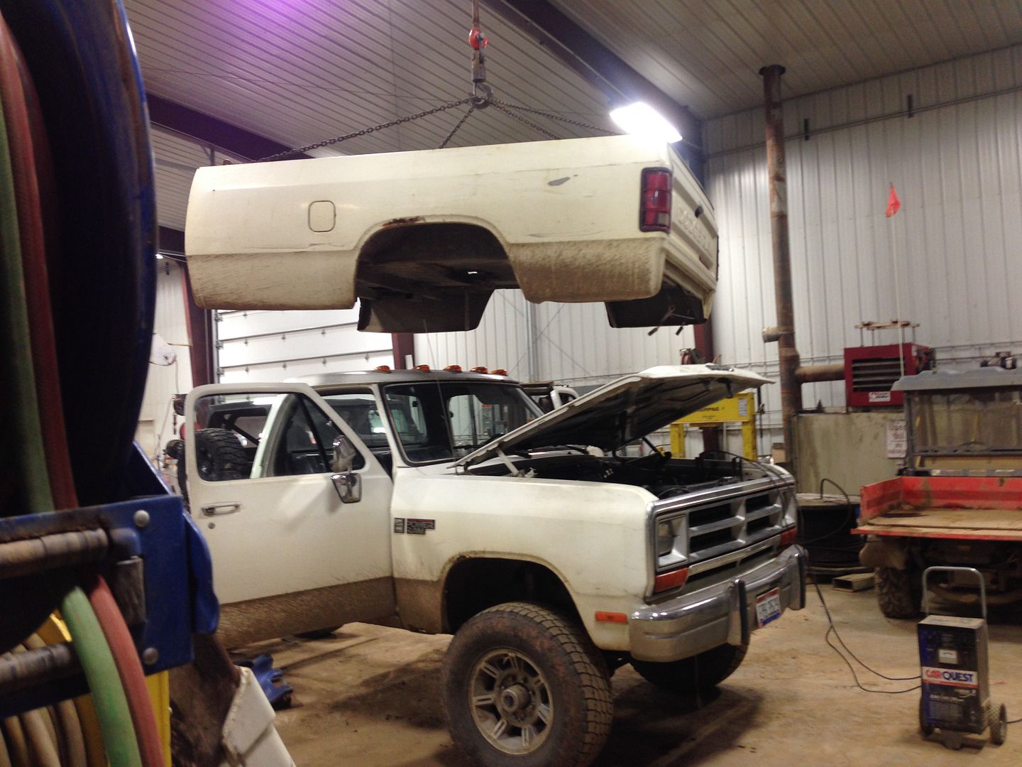

Re: '90 W250
Postby Tacoclaw » Sun Nov 24, 2013 12:40 pm
Pffffft, ain't none of that quitter talk here. I bolted the other spring back to the axle, knocked my side back ~1", the started drilling holes.
It ain't looking good for the e-brake bracket, and one of the bed mounts on the driver's side is getting deleted, but other than that it doesn't look too bad. I'm about to throw the bed on and double check everything.

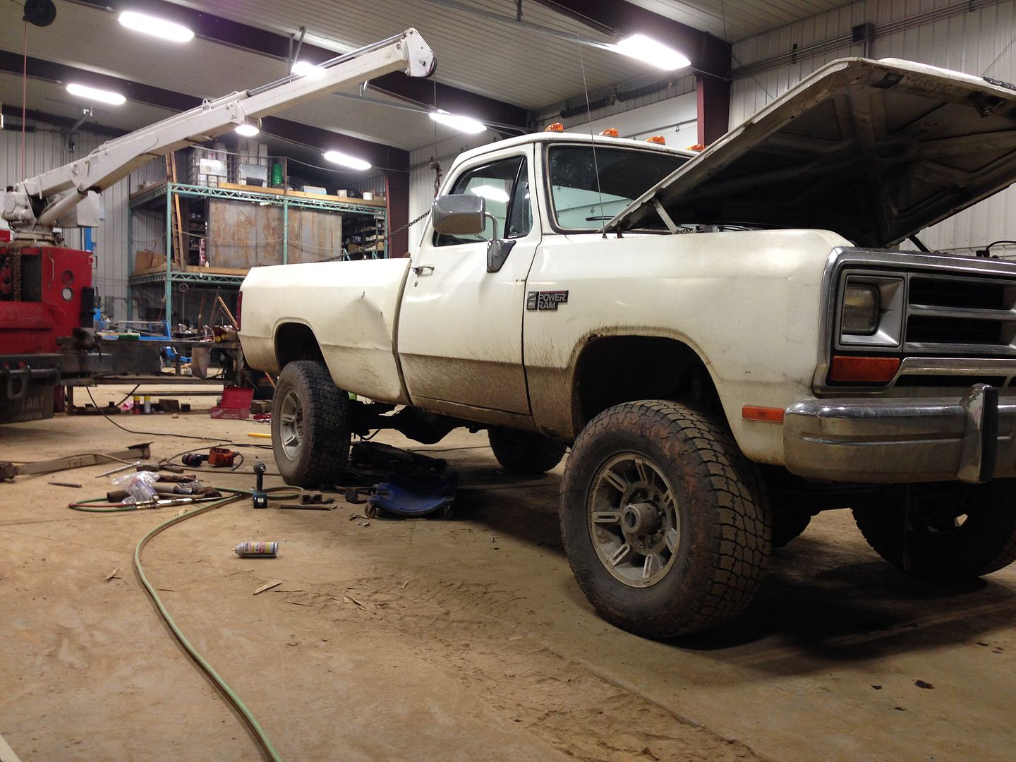

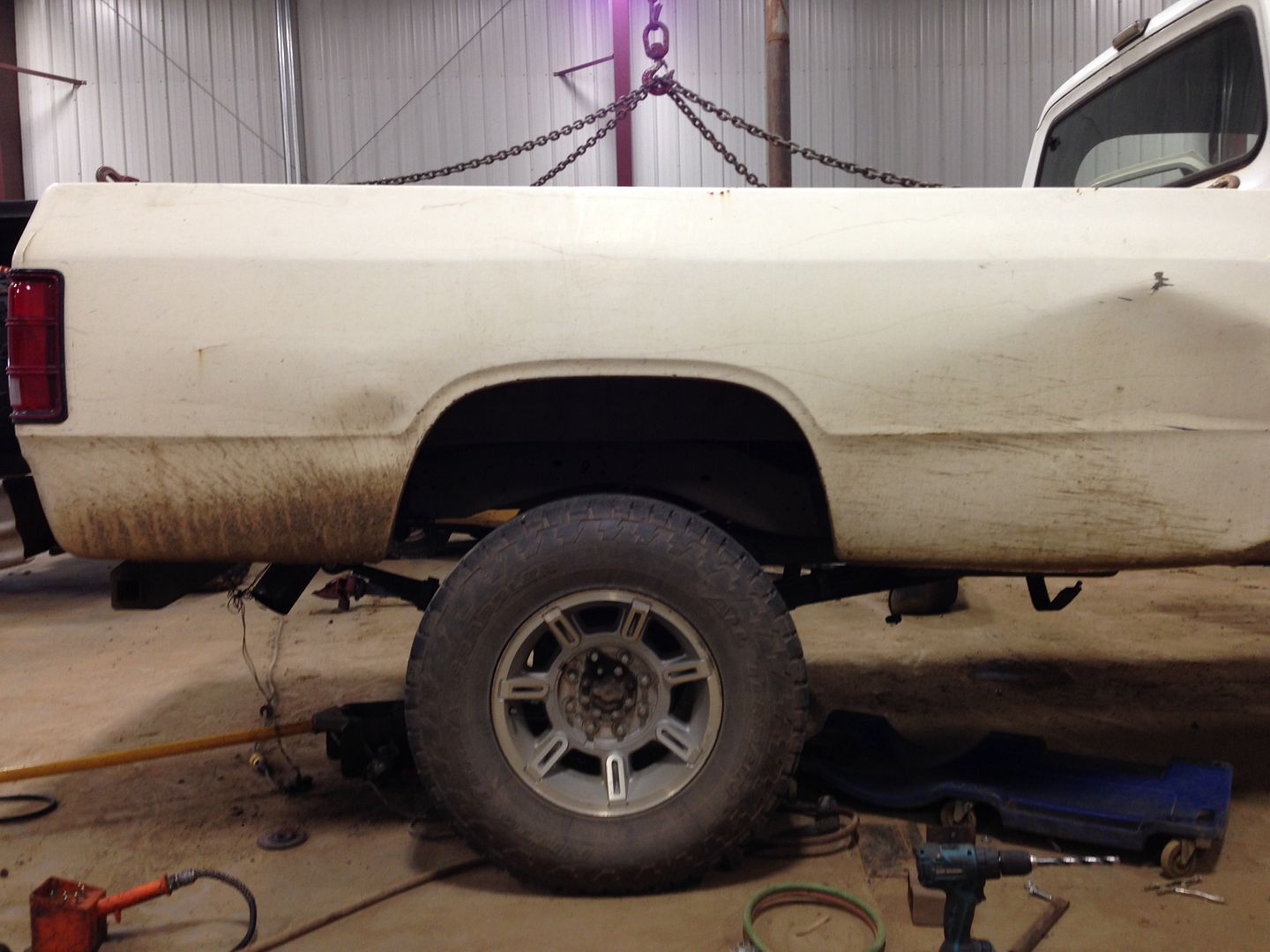

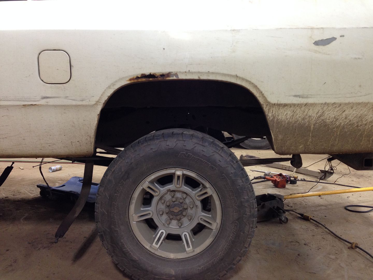

Re: '90 W250
Postby Tacoclaw » Sun Nov 24, 2013 1:47 pm
Probably gonna have to look into pulling a couple leaves, it sits nice but I can tell it's gonna ride bad. It moves about as much as the hybrid pack did when I bounce on it, but it wants to spring back to the original position while the hybrid would just stay down.
Some progress/daredevil work I have done. The wheel is centered back up, the one that's all wonky is the driver's side with my custom shackle flip. I'm thinking it'll pull the centered wheel forward about 1/8" when I kick the driver's side wheel back it's inch. We'll see.
Re: '90 W250
Postby PToombs » Sun Nov 24, 2013 4:33 pm
Did you fix that funny spot that looked like a crack while you were in there? ;)
