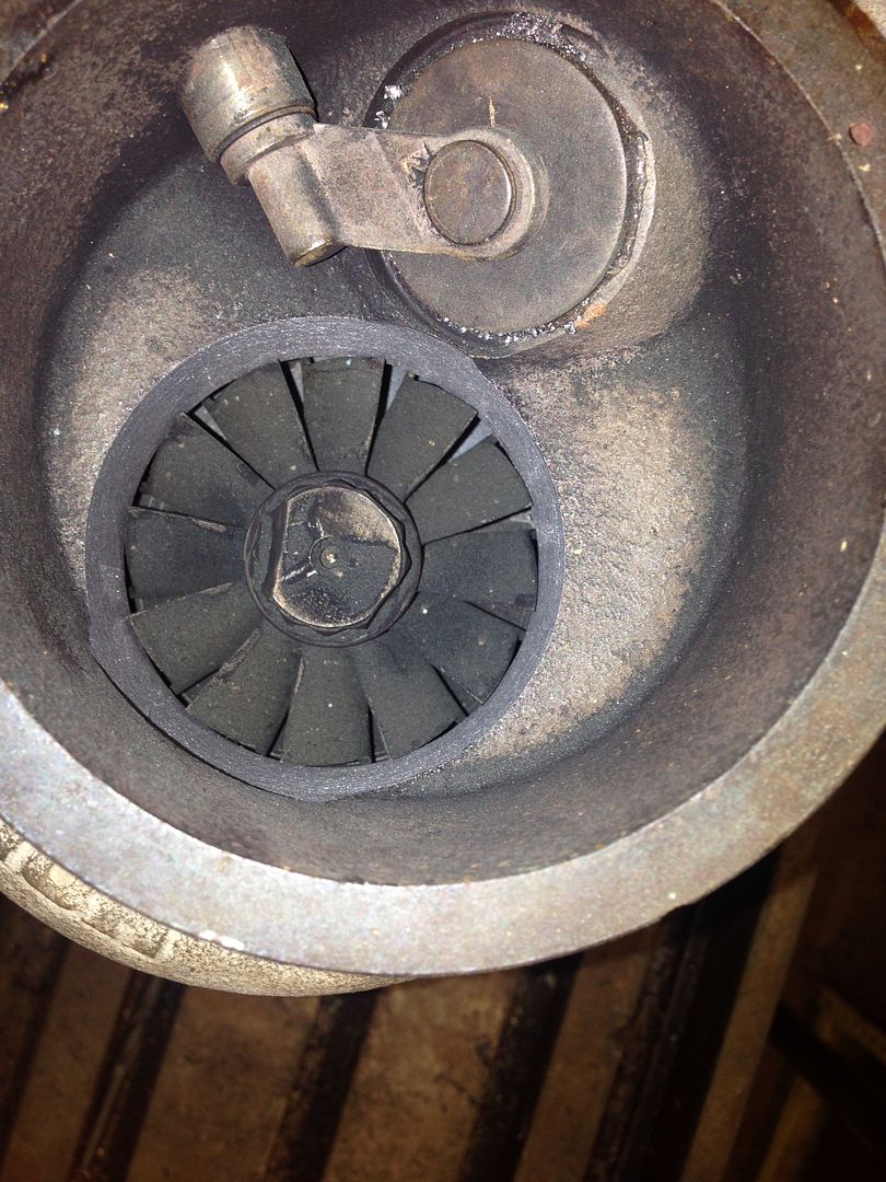

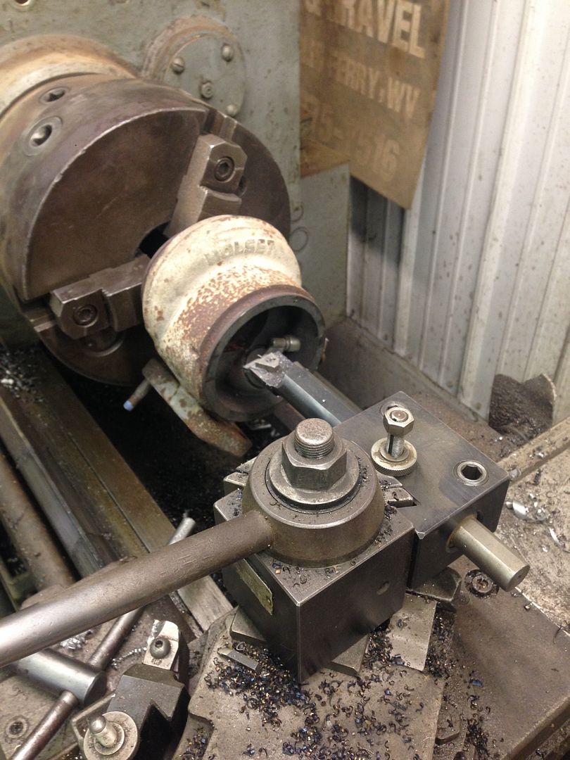

Test fit on the H1c, it fits with plenty of room to wiggle the turbine through its play, but it can't fully seat since it's a different mounting setup. Still better than 1/2 the blades in there.

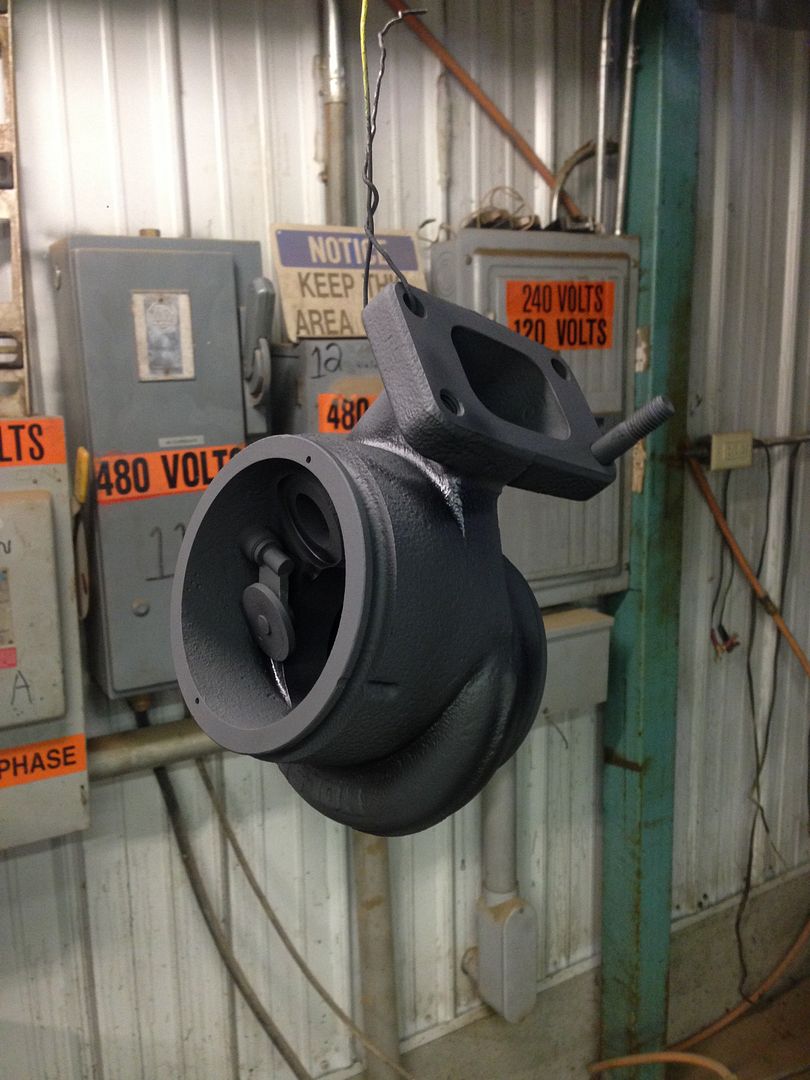

Post blasting
Post paint. I painted everything so it wouldn't get rusty, you'll just have to sand it off all the mating surfaces, mang.

Very, clamp the part that bands to the CHRA and it's already pretty much centered. Just a couple taps/turns to get it perfect. It was more of a mental thing than anything, this is the first thing I saw when I turned it on for a test spin. :lol:

Well, that was at 60rpm and my first spin was at 290, but still. I didn't think there was anyway that bar would go in there without getting destroyed. Turns out it was just an optical illusion, plenty of clearance once the bar was back inside the housing. I glued the WG flap laws with silicone but that was about it.

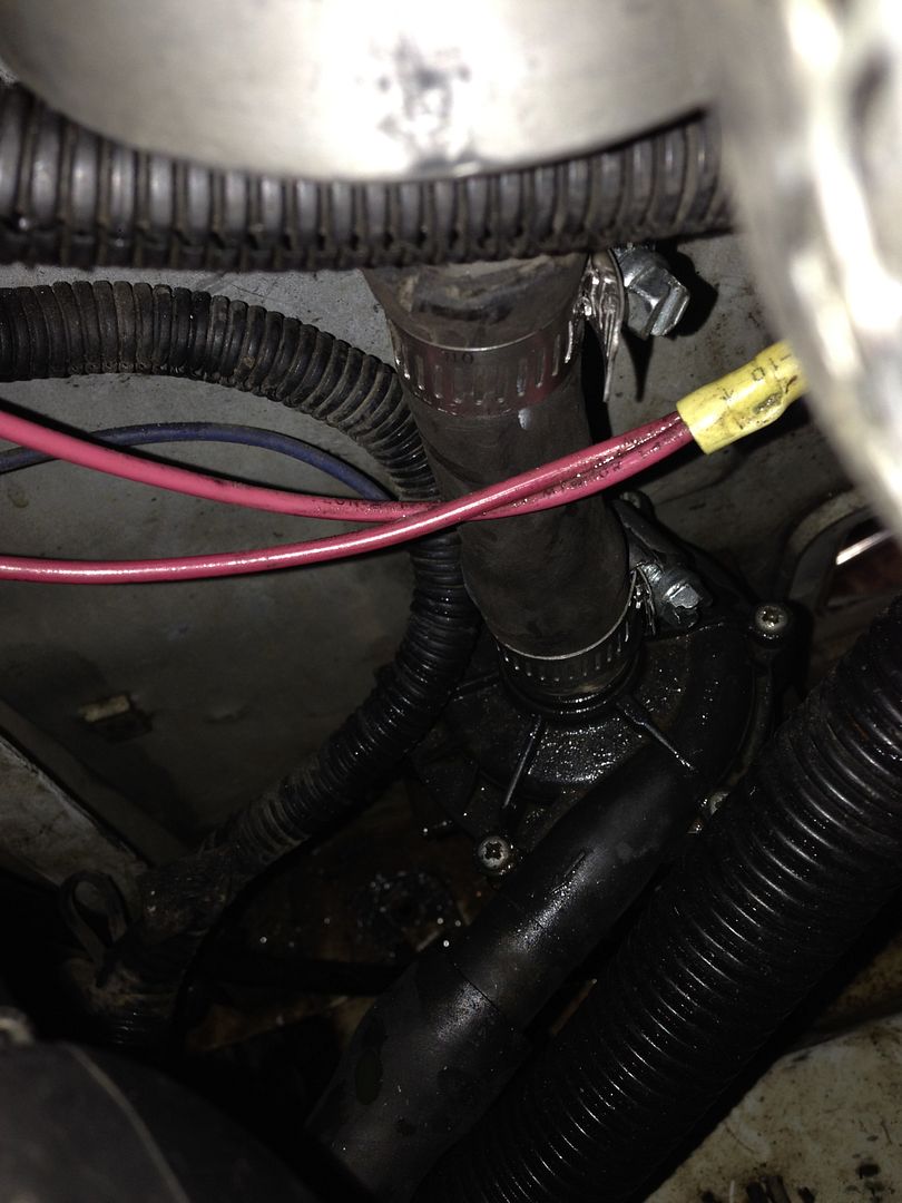

Finally have a working aftercooler again, bought a universal power steering reservoir and hooked hoses to places I assumed they went.
Now to get this bypass figured out and see what this pig has in it.

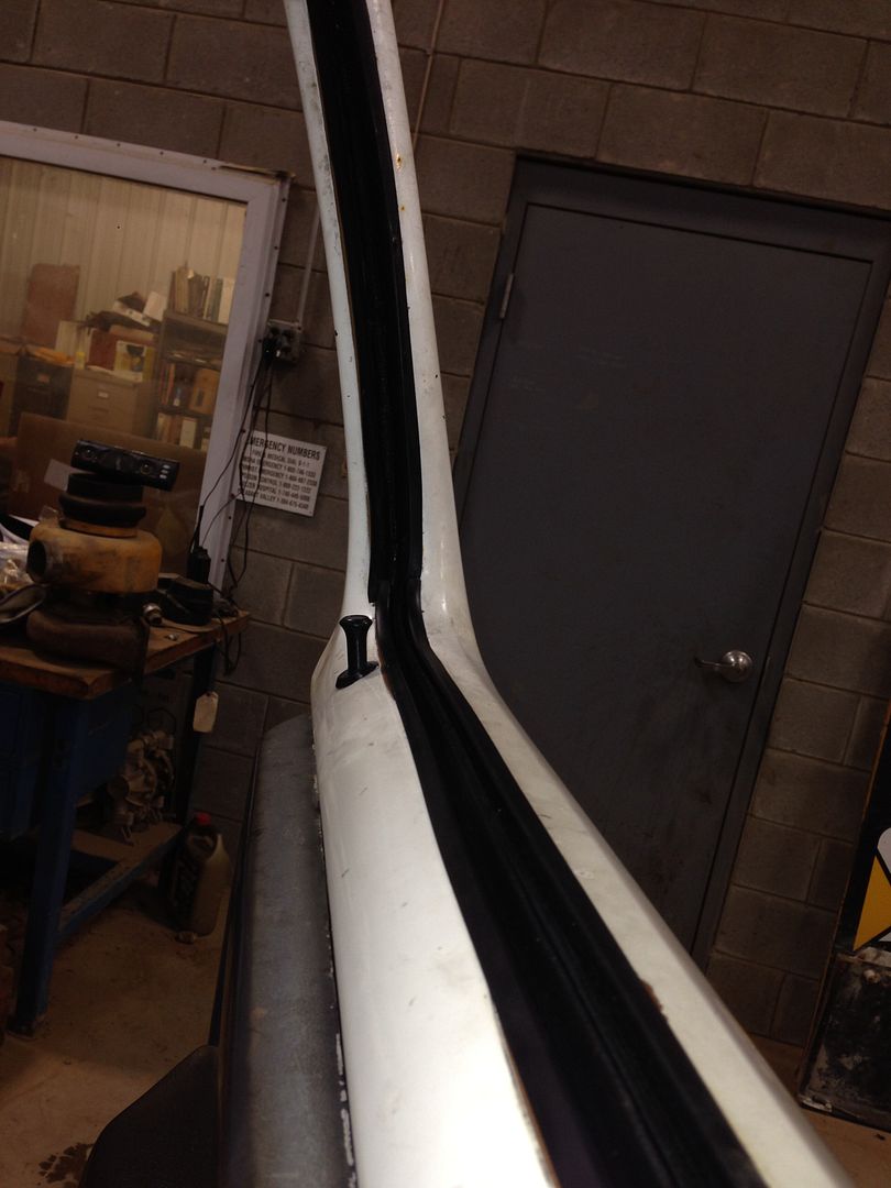

Anyways, I'd like to thank you, BC. Do you ever get tired of writing out epic how-to's? I used yours to do my weather stripping. No way I woulda tried it without it, I even had to peruse it for about 4 months before I had the balls to give it a shot. :lol:
I now have well-sealed windows. :)
Not a lot to take pics of, but my seals came apart in many pieces. All of them, even the ones that's definitely weren't supposed to. :lol:
All fresh and new. 8)
