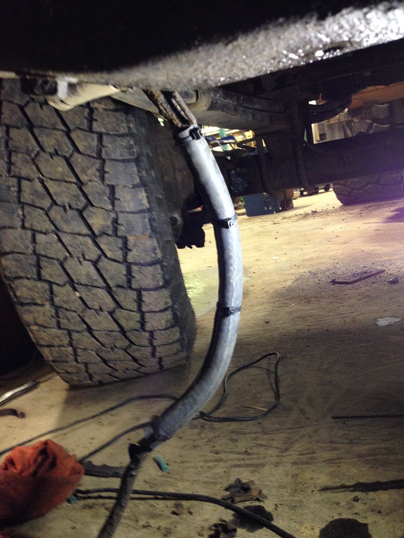

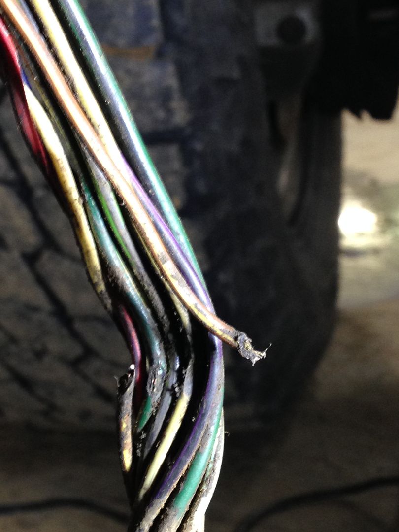

Then the usual BS wiring problems. :roll: Rubbed a hole in the harness where it drops down the inner fender and goes over the framerail to the rear harness. Lost the passenger brake light/blinker and ran up and down the harness 3 times before it showed it's ugly face.
Then I covered it's ugly face up. 8)
Then I found yet another Scotchlock surprise from the old man. :yuck:
Got it all patched up so far, threw a stiffer spring on the bypass, and hit the road. It boiled the tires off when the turbo spooled in 2nd, then ran it out through 3rd and 4th. It actually pulled 2 degrees of vacuum at 40psi (and 1500+*), but that's with that dirty-ass cone filter I finally put back on. I was running the bypass filter less before, it was 45 psi and I never saw it go over 1300* on a pull.
I'll put the smaller spring back on and try again before I buy a $60 filter. :lol:
Re: '90 W250
Postby DMan1198 » Sun Jan 05, 2014 8:49 pm
Man that's a lot of buggered wires. I like the covering. I had the ground on my drivers door do that. Lost all functionality of the door electronics. Looking at it After fixing it all the wires have some exposed wire, but I said screw it and wrapped the whole thing in electrical tape.
