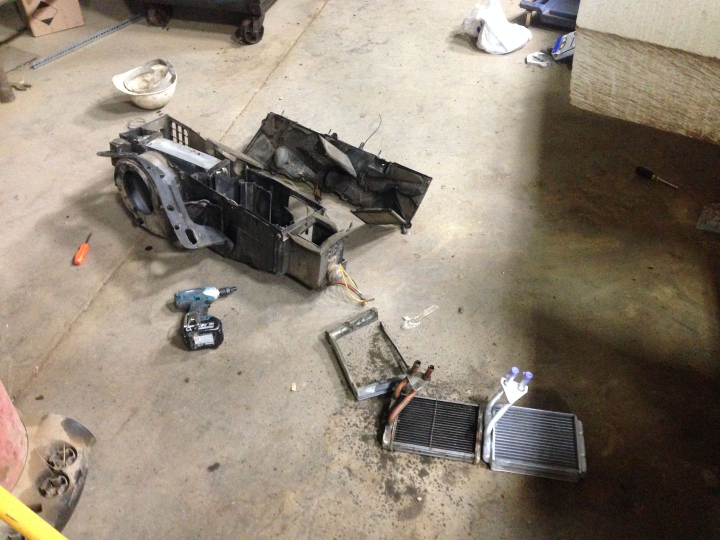

Postby PToombs » Sat Jan 11, 2014 5:31 pm
That new one looks quite a bit bigger than the old one. Will it fit?

Re: '90 W250
Postby Tacoclaw » Sun Jan 12, 2014 4:25 am
It was a much thicker core but it still fit height and width-wise. I had to cut the foam off the bottom so the hoses would fit back in the holes of the HVAC, but everything was fine otherwise.
Re: '90 W250
Postby Hansen01 » Sun Jan 12, 2014 9:13 am
On a scale of 1-10 how much of a pain in the a$$ was this lol
Re: '90 W250
Postby CumminsPower59 » Sun Jan 12, 2014 12:59 pm
I'd say its a 5-6, takes a fair bit of twisting and pulling to get the heater box out. Like taco said, the new aftermarket cores are a tight fit. Just did mine this fall...
Re: '90 W250
Postby Tacoclaw » Sun Jan 12, 2014 3:05 pm
Yup, not too bad at all. The worst part is the damn heat shield on the engine side. My blower is hanging in the way of everything, so I didn't bother to put it back on. I've got the header and turbo blankets, so my underhood is pretty cool.
