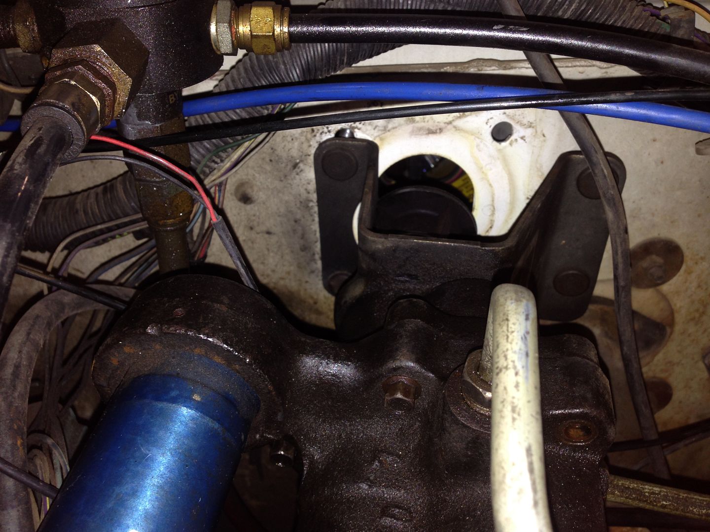

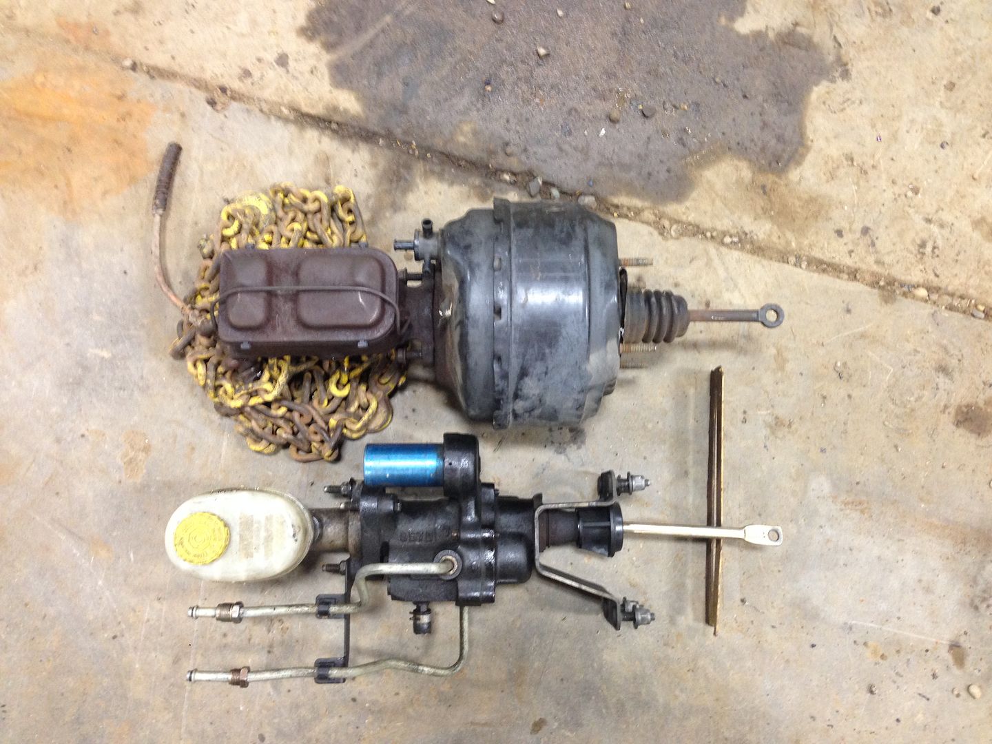

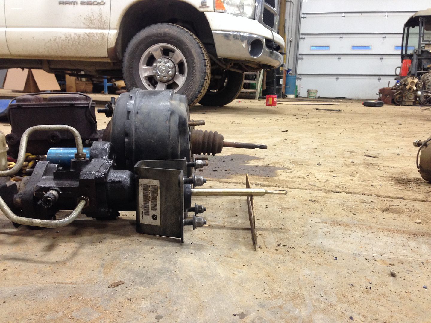

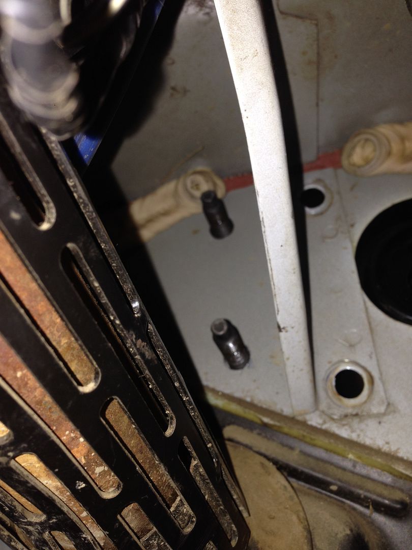

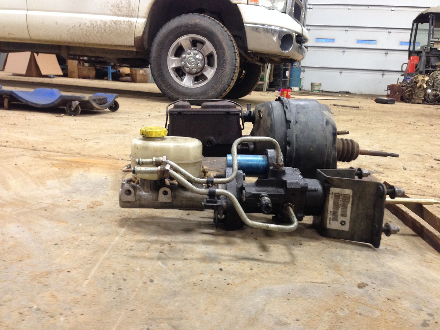

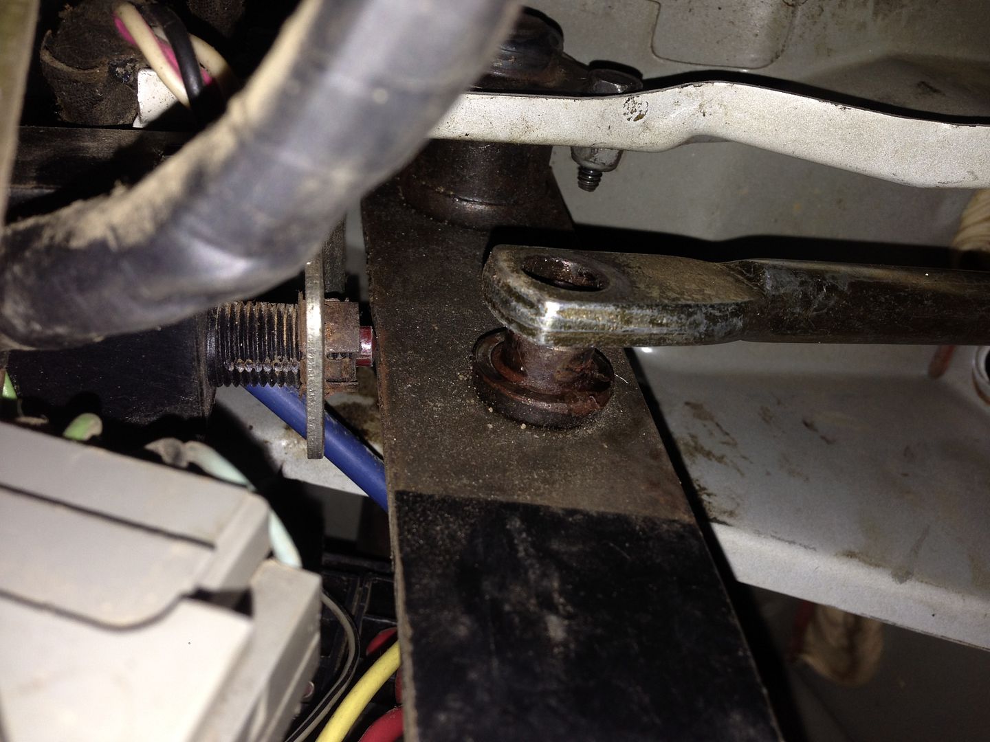

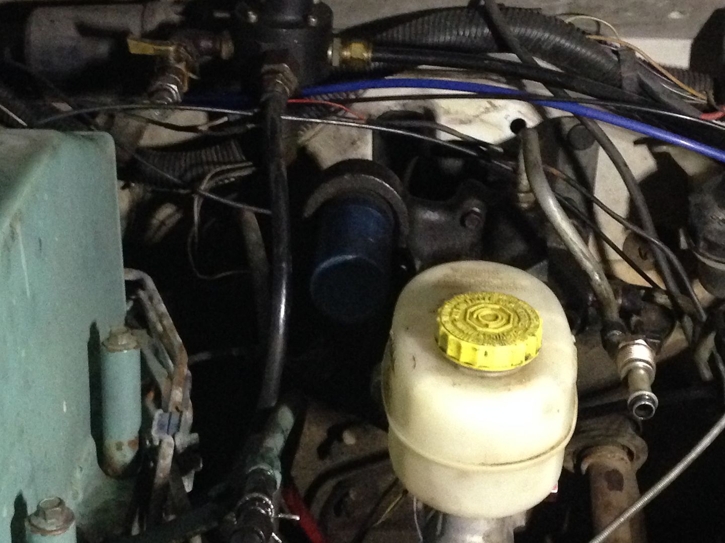

Postby Tacoclaw » Sat Jan 18, 2014 12:09 pm
Some pics thus far from my hydroboost install, here's some size comparisons.
Here's the mounting hole difference.
And the awesome view from under the dash, I can't wait to tighten those one hex at a time. :roll:
A shot of how far back the pedal would be if you just stuck it on and drilled out the hole. It shoves the switch clear out to the end of the threads.
And an overall shot of the clearances underhood. It clears all my cobbled crap so far. :lol:
