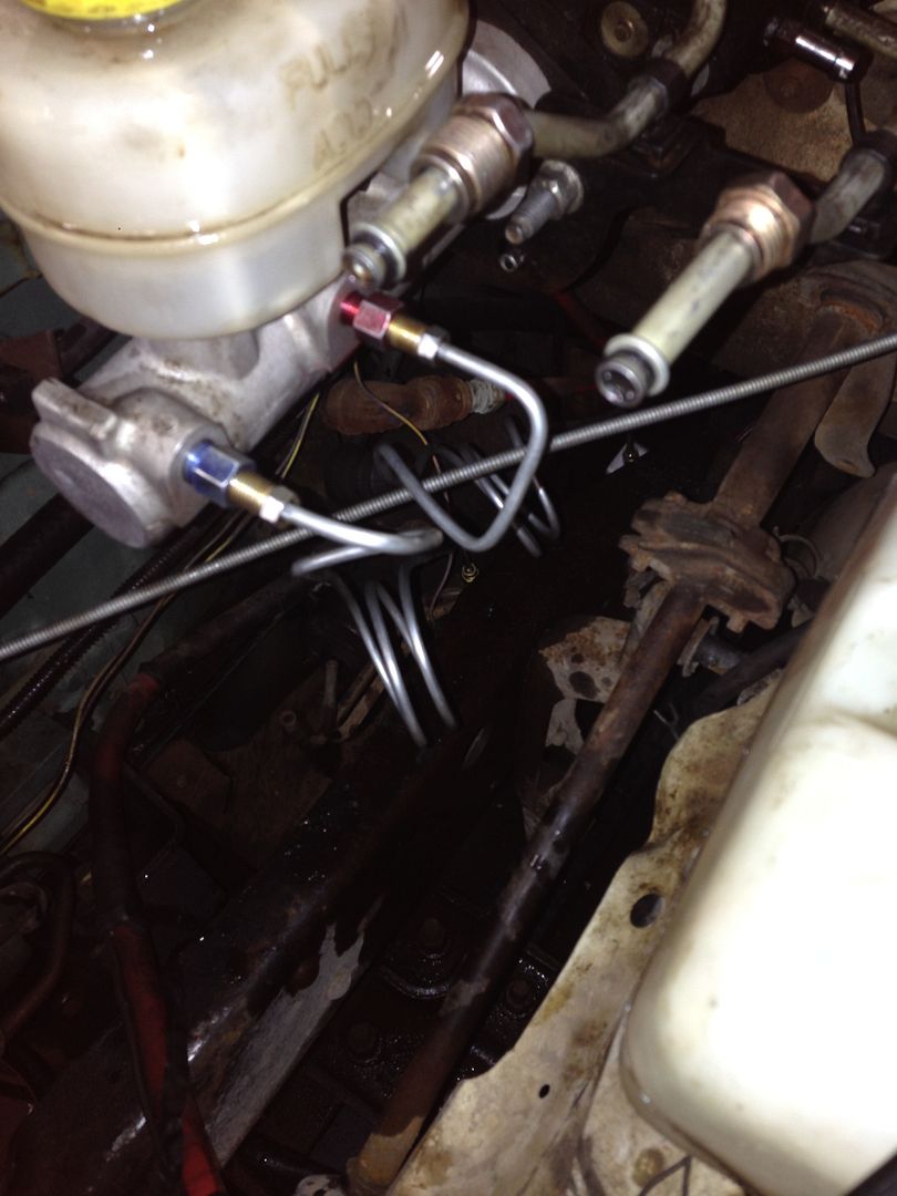

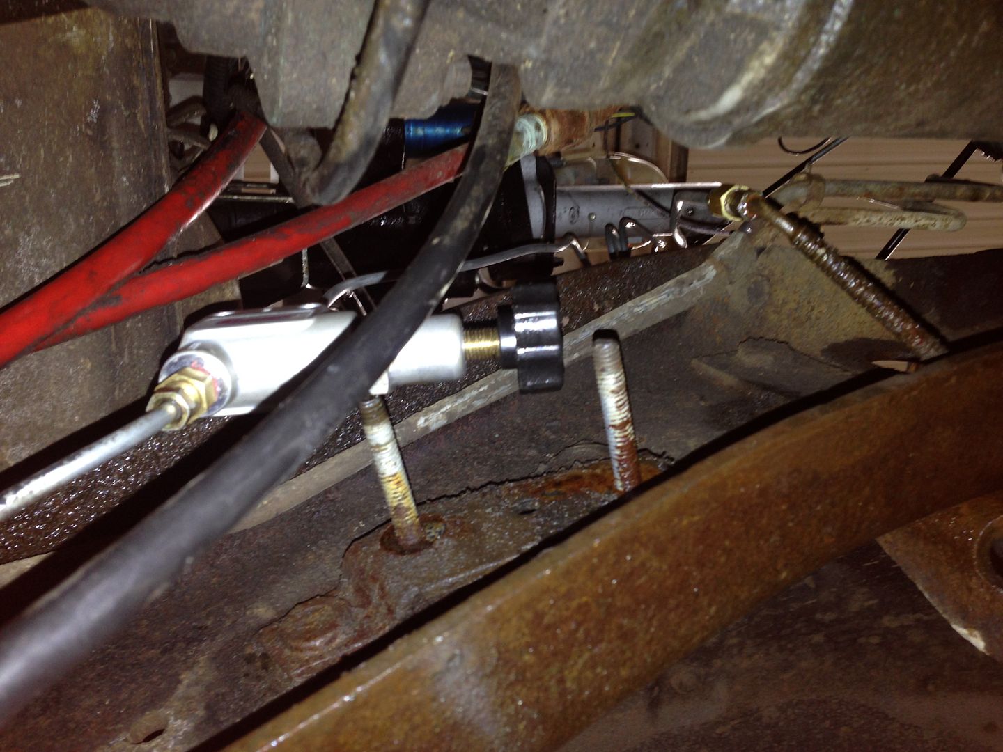

Got my brake lines ran and the prop valve in place. I'll yank the factory mounting studs and mount it solid off a spacer if it actually works.
I will say that just with my solo bleeding of the slaves into a cup filled with fluid, the brake pedal has resistance right as it comes off the stops. It's nuts, I've never had it do that before, even after a legitimate bleeding with two people doing it.

An adjustable prop valve would make them a lot easier though.......... :twisted:
Re: '90 W250
Postby Tacoclaw » Sun Jan 26, 2014 10:17 am
Ho-lee-sthi, is it possible to have a vehicle declared unfit for road use because the brakes are too good?
Even glancing at that brake pedal has the front brakes locking up like it's their job. I have to really put some pressure on the pedal to get the rears to lock up, even on ice, but I have the prop backed all the way off and aren't completely sure they're totally bled.
I still can't believe the brakes are that touchy now though, right off the light stop has the brakes starting to work.
