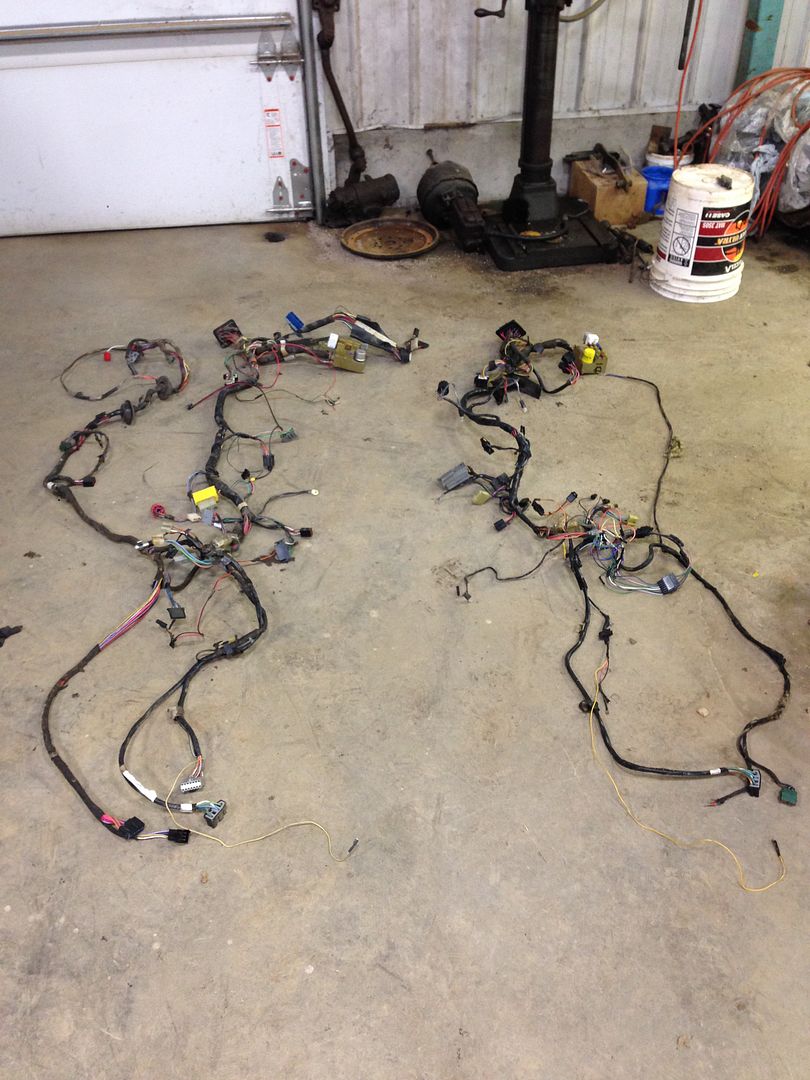

Postby Tacoclaw » Thu Mar 20, 2014 5:49 pm
I still don't have an underhood harness, but I went ahead and prepped interior for everything. Got the cruise wheel and wiring started.
Here's the diesel (left) and gasser harnesses laid out. The diesel isn't as bad as it looks, it's got the ABS stuff towards the bottom and I hadn't found all the plugins to pull the door harness so it's still on there. Decently simple so far, we'll see what happens when I turn the key.

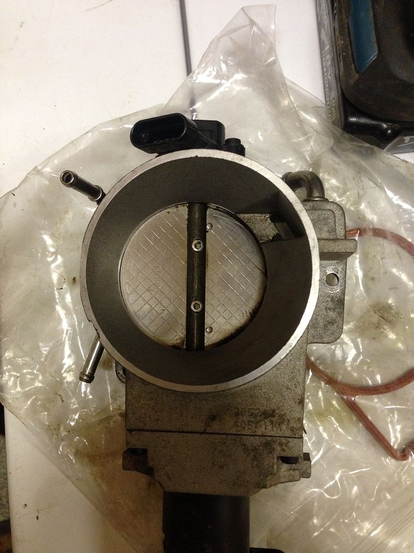

Postby Tacoclaw » Fri Apr 25, 2014 6:03 pm
Grabbed this off CL, factory throttle body off an LS1. Oughta seal up much better than the Chinese TB I'm running now. Gotta get it hacked up to work with my actuator and all full of pipe plugs to cap all the gasser crap.

Postby DMan1198 » Mon Apr 28, 2014 8:22 pm
I sure hope that works for you. Is it a 90mm unit?

Postby Tacoclaw » Tue Apr 29, 2014 2:51 am
Nah, whatever the stock size is on an ls1. I got all the electronic stuff off of it, once I turn out some steel to bolt back over the holes this thing should be pretty airtight. I can't see a bit of light around the throttle blade. 8)
Re: '90 W250
Postby DMan1198 » Tue Apr 29, 2014 7:18 am
Right on. Iirc ls1's had 60 something, 70 something, and 90mm throttle bodies depending on application

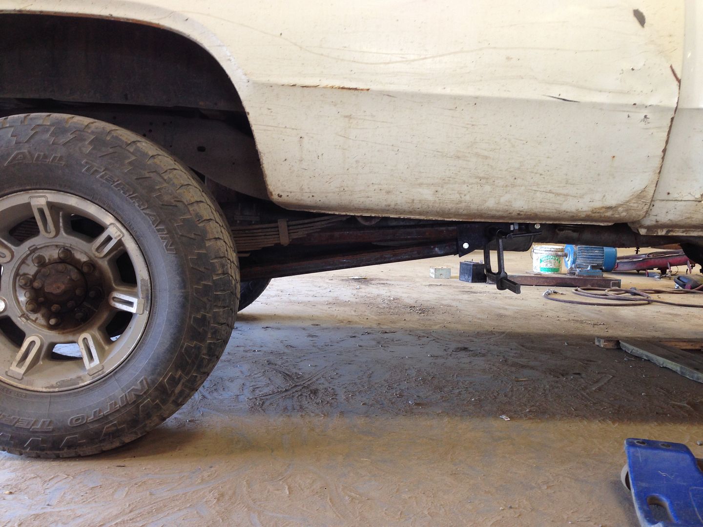

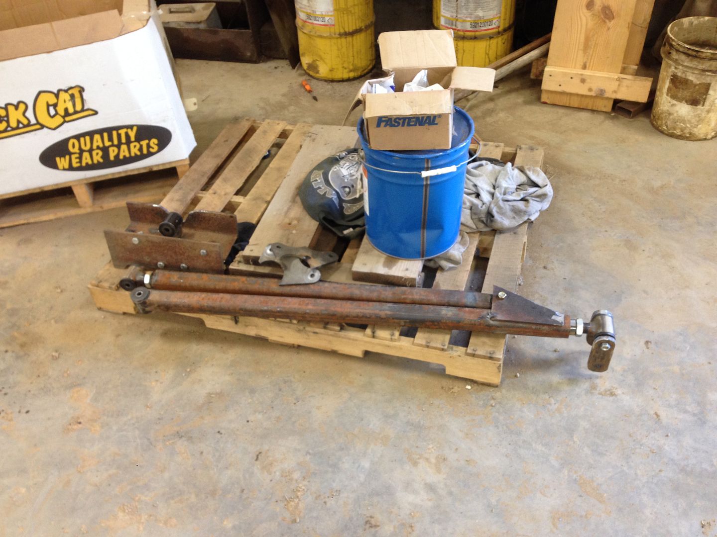

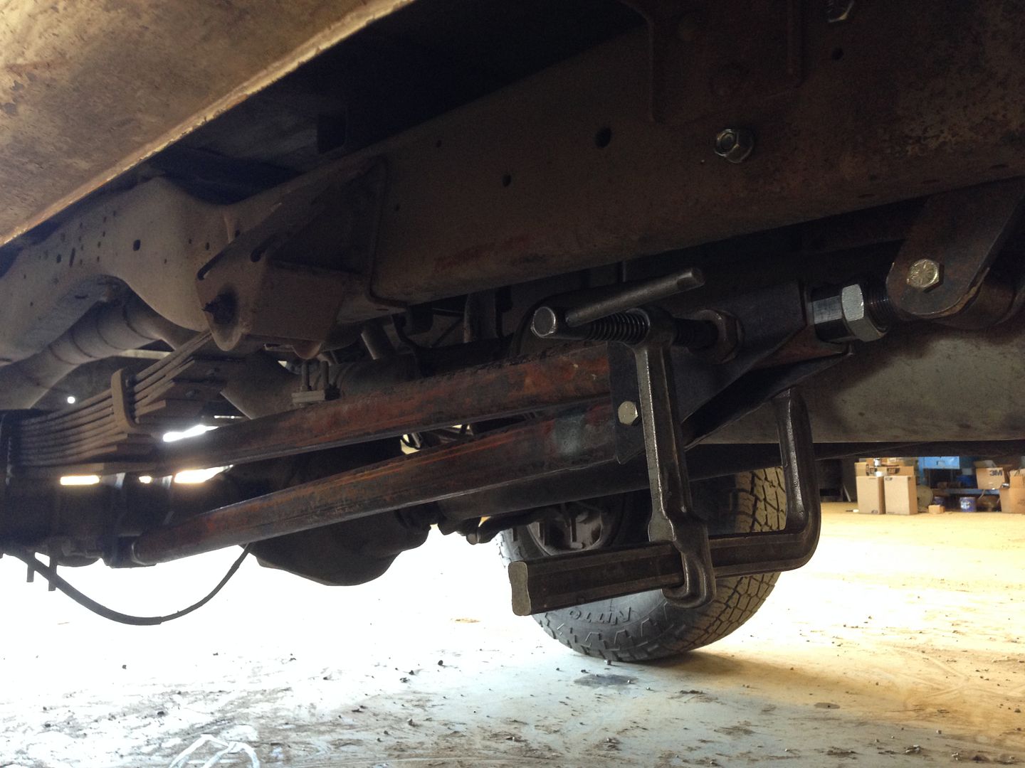

Postby Tacoclaw » Sun May 25, 2014 1:16 pm
Finally got around to making a torque arm. I cabbaged a bunch of stuff I had stashed away to redo my front end, so if that ever comes about I'll have to order more. It's all .250 wall square tubing, so it's heavy as hell. I already smashed the crap out of my finger with it. :cry:
It is currently awaiting finish welding from someone who can actually weld.

Re: '90 W250
Postby Tacoclaw » Sun May 25, 2014 1:32 pm
Some brand from the local spring shop, stock application for a 90's 3/4 ton Suburban.
I'm about to yank a leaf out of them and reset my shackle angle, that's why I figured it was best to et some support on this axle. It was still wrapping decently with those monsters on it.
