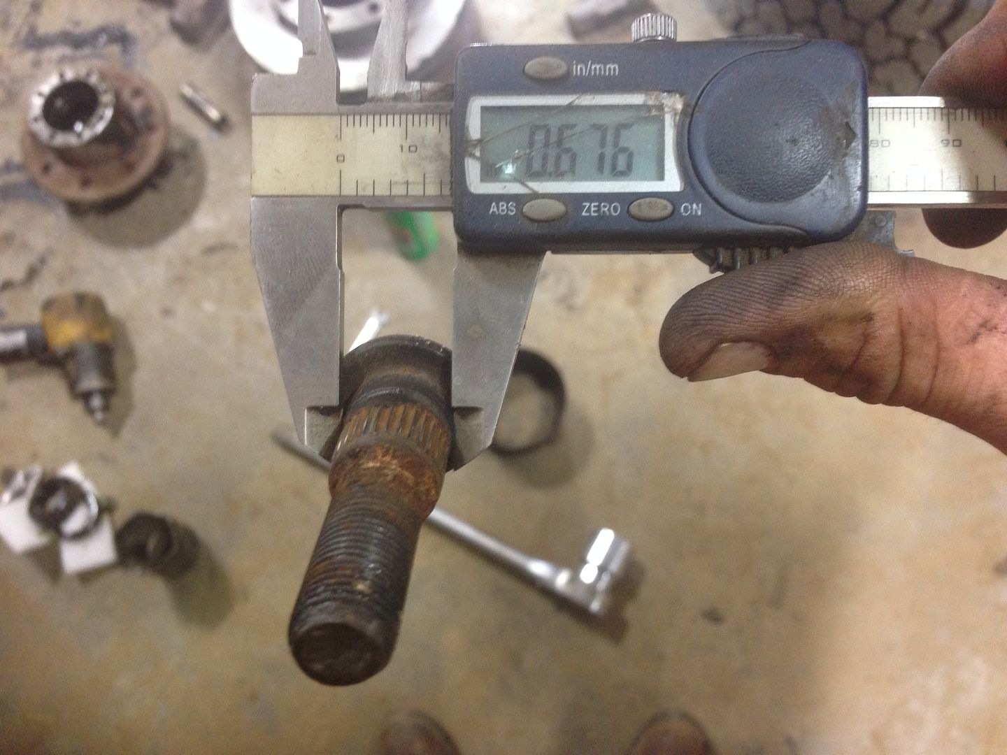

Just installed the disc brake kit from lugnut4x4.com Sunday, pretty straightforward install, just a couple things to note.
First, our axle tubes neck down just before where the backing plates bolt on and continue on to the end of the axle. The 3.5" brackets o got were a bit too big but I never measured the actual size of them. I will later and post itnup.

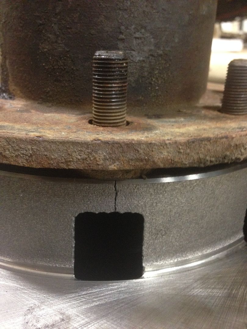

Second, my studs had a shoulder on them that the drum sat on. After cracking the casting on the first hole I drove it into I realized there may be a problem. Turns out the GM discs have a smaller hole than our drums, An 11/16" bit opened them up to the correct size, the shoulder's measurement was .678".

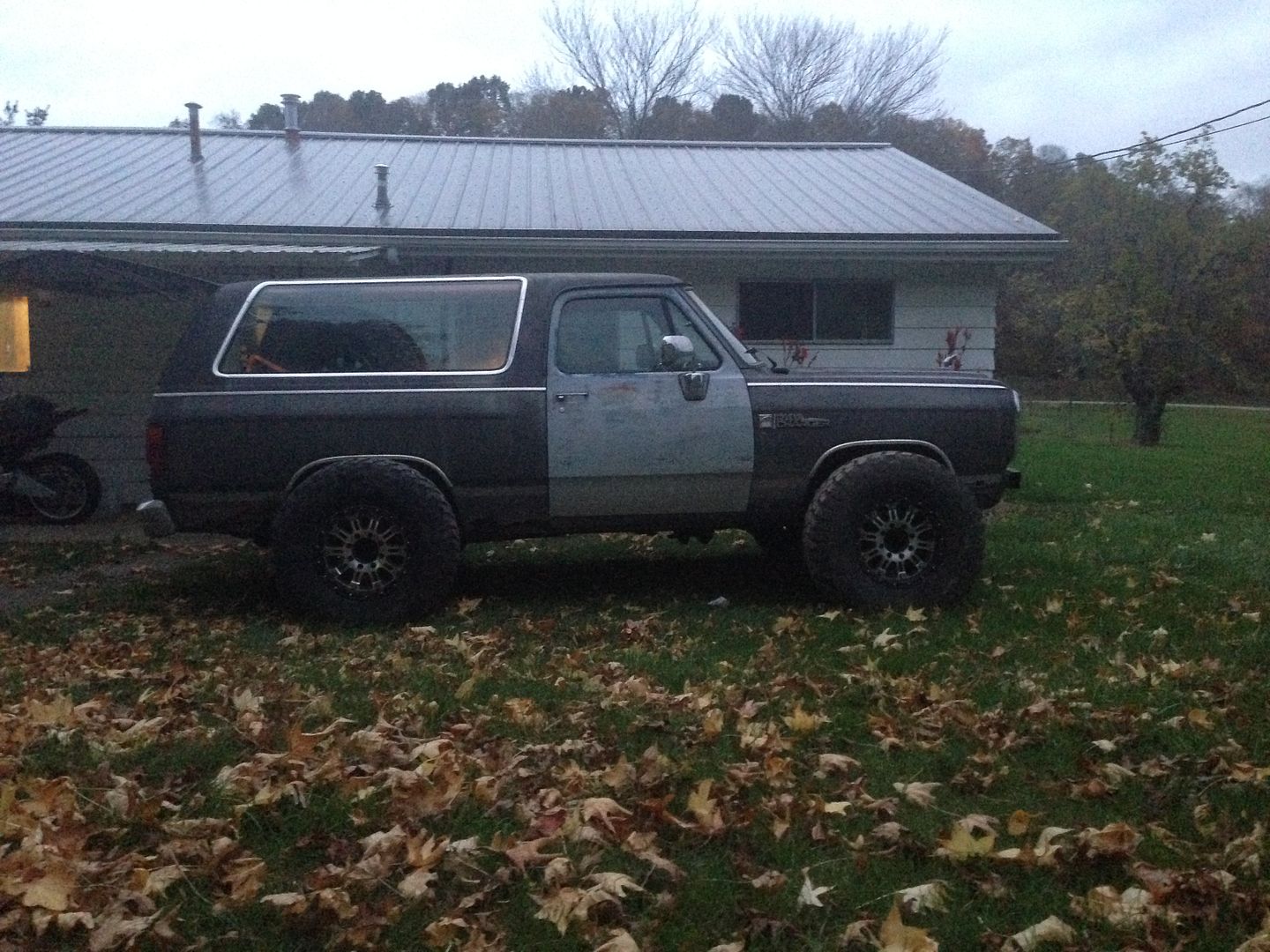

I also picked up a set of 37/12.5/17 KM2's that will be residing under it. 8)
I didn't want the wheels and dude didn't want to have them dismounted so he threw them in for free. :lol:
Re: '90 W250--'89/91/92 Ramcharger
Postby ellis93 » Mon Oct 20, 2014 8:50 am
Dude! Those wheels are fagtastic! I can't belive you don't want them on your RC. :lol:

Taco... just put JB weld in the crack :lol:
Postby Tacoclaw » Mon Oct 20, 2014 9:02 am
Hell with that, I'm running it cracked. I've got 7 more holding it. :lol:
I'm trustin the giant disc section and sandwiching of it between the hub and wheel to hold it together.
Ellis, as ashamed as I am to admit this, those bad boys are going on the old Dodge for a while. It's the only thing I've got that's tall enough to tuck those 37's. Then I'll put the nittos on the RC and start my fender massaging and leaf spring swapping.
