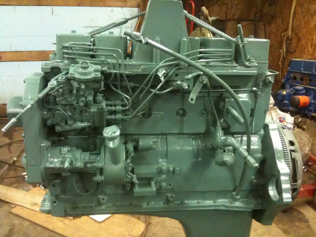

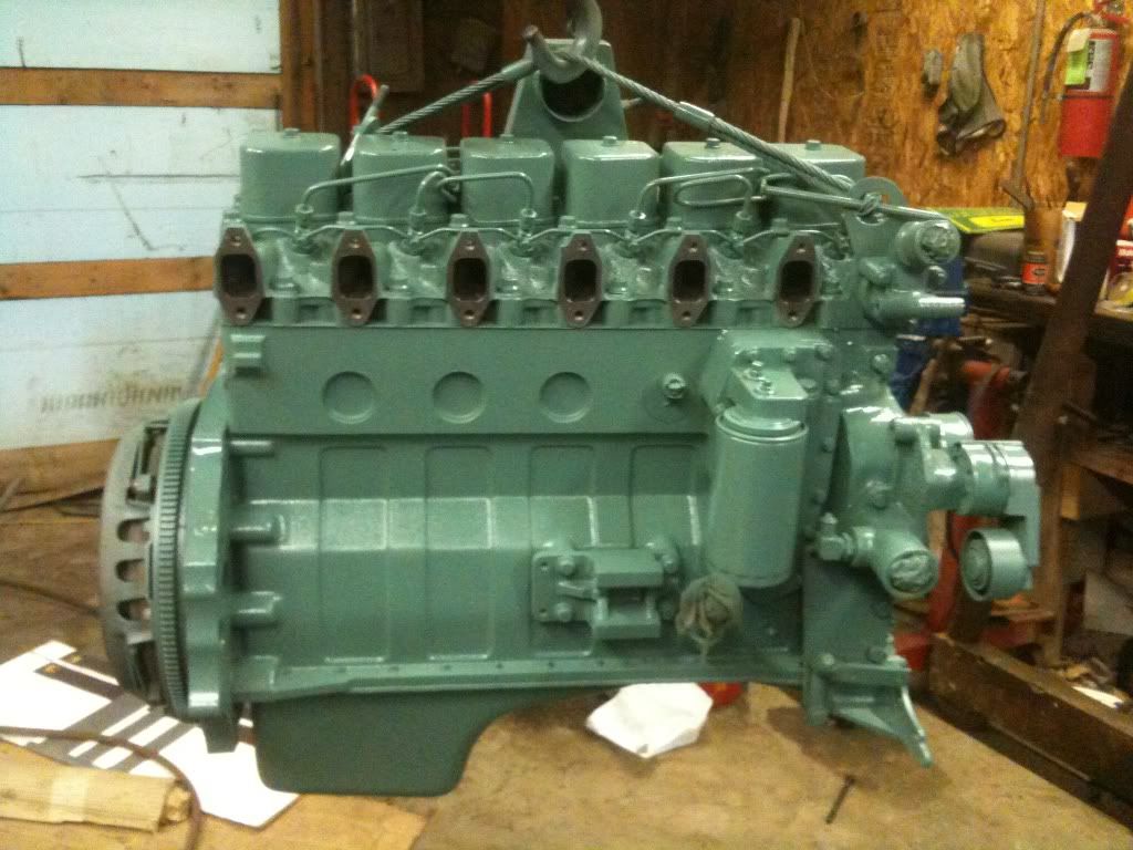

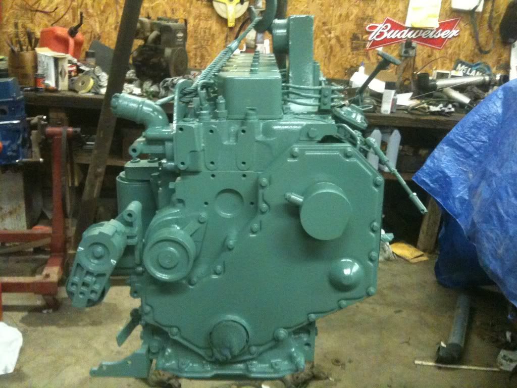

In all it's DD green glory:

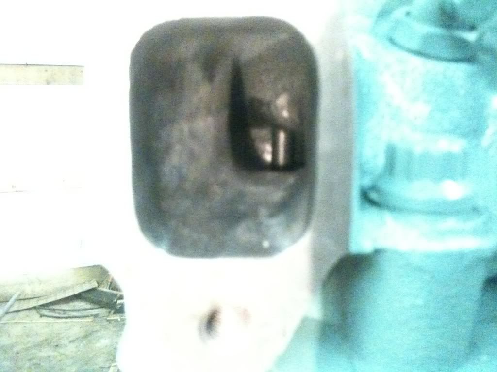

And here's the best pic of an exhaust port I could manage with my phone and a huge flashlight. :oops:

Postby ahale2772 » Thu Mar 08, 2012 9:15 pm
looks killer!
Re: Twin turbo support mods (last page)
Postby Tacoclaw » Fri Mar 09, 2012 5:35 am
Thanks, man. :grin:
