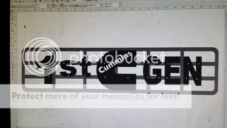

Postby 762frmafr » Fri Dec 19, 2014 9:12 am
I will be picking up my second gen intercooler today. I plan to mount it in front of the AC condenser. I know I will probably not be able to run the stock grille, but never fear, I own and run a CNC Plasma table. I worked up this proof this morning of what my new grille will look like. The grille part will be powdercoated A silver color and the letter will be black like on the proof. The letters will be bolted to the grille with blind studs. I will then be able to make brackets on the back to space the new grille out as far as I need it, and bolt it on. What does everyone think?

Postby PToombs » Fri Dec 19, 2014 6:35 pm
Looks cool to me! IMO you should put a mesh of some kind on it. It will be a little more background for the black and protect the IC too.

Postby 762frmafr » Fri Dec 19, 2014 6:59 pm
PToombs wrote:Looks cool to me! IMO you should put a mesh of some kind on it. It will be a little more background for the black and protect the IC too.
