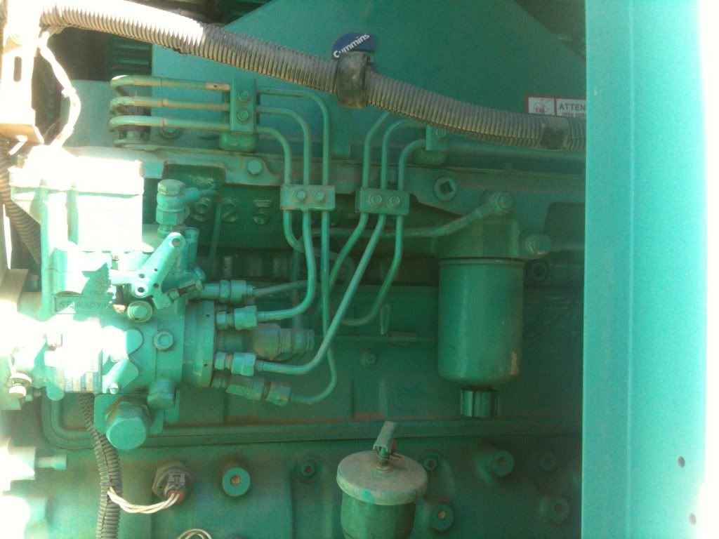

Been checking in on your build thread often and wonder what you are using for fans. Trucks looking real good !

As embarrassing as this is, we've got one of those gensets sitting outside right now that I did some work on. I didn't even pay attention to the color... :oops:
Roosa pump, 6bta with the water "a"...
Think they'd notice if that aftercooled got replaced with my old non-IC'd intake plate?
I'll check on the fans when I get home. I can only hide in this generator so long before a boss catches me. :mrgreen:

lol well atleast scrape that emblem off before you leave it! i got probably a box full of those
