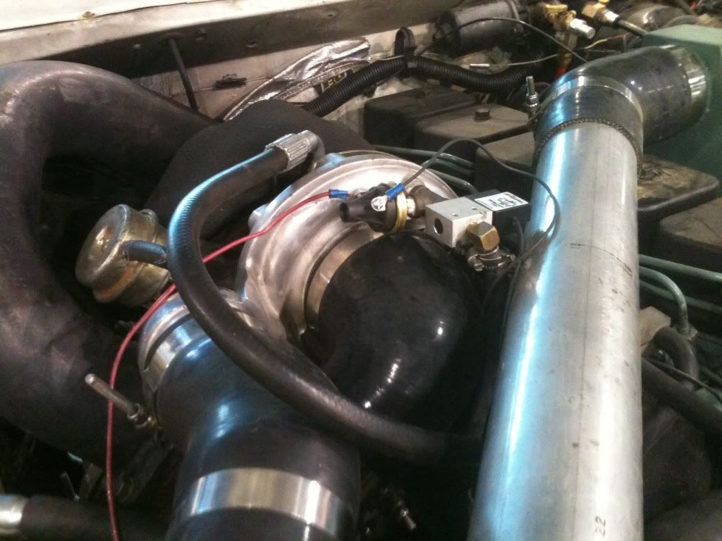

Oh, and here's a pic of my new boost controller setup:
It's an adjustable pressure switch from Napa and a 12v spool valve. I just turn the switch to wherever I want and it opens the valve and dumps the boost to the external 'gate. I don't even have the internal 'gate hooked up anymore. It seems to be working great, as boost comes up fast and when it gets to where I set it it stops right then.
I do intend to relocate it and clean everything up, but I wanted to get some testing in with it before I went through all the trouble.

Tacoclaw wrote:Oh, and here's a pic of my new boost controller setup:
I might have to steal this idea for limiting my hx on my truck :lol:. What boost can it go up to?

I don't have the part number on this phone, but I'll grab it when I get home. There's more than one switch, and they deal with different pressure ranges.
Also, so I don't get anymore tear-filled texts, the switch was Hineman's find. I'm a filthy copycat. :mrgreen:

I've got to grab a shower and some food, but before I do here's a post I found on some Mustang forum:
napa has them..here are some of the part numbers...701-1603,701-1605,701-1575,701-1576,701-1608,701-1609,701-1577,701-1578,701-1604,701-1606 nd dual circuit p/n's 701-1591,701-1592, nd 701-1607....you can go on napa online to check the psi nd factory set point...just remember if you do..just type in "bk" before every part number..or just go into your local napa store with these part numbers nd someone should be compitant enough to help you
Mine is "BK 7011604" They apparently are good a little past their limits, but I wouldn't expect them to be as accurate there.
Here's the stats on my switch:
Attributes:
Circuitry Type : Normally Open
Connection Size : 1/8"-27 NPT Male Thread
Contact Setting : 51 - 90 psi (+/- 7)
Contents : Switch, (2) Screws
Factory Setting : 60 psi
Manufacturer : Honeywell Hobbs
Manufacturer Part Number : 76054-60
Material : Plated Steel Base / Polyimide Film Diaphram / Silver Alloy Gold Plated Contacts
Pressure Rating : 250 psi Operating (500 psi Proof)
Series : 5000 Series
Specifications : Single Circuit, 2-Terminals
Temperature Range : -40 - 250 Deg F
Terminal Type : #8-32 Screw Terminals
It is repeatably accurate to 25 psi at least, as that's as low as I've had it. I've checked it with a regulator with a gauge on it.
