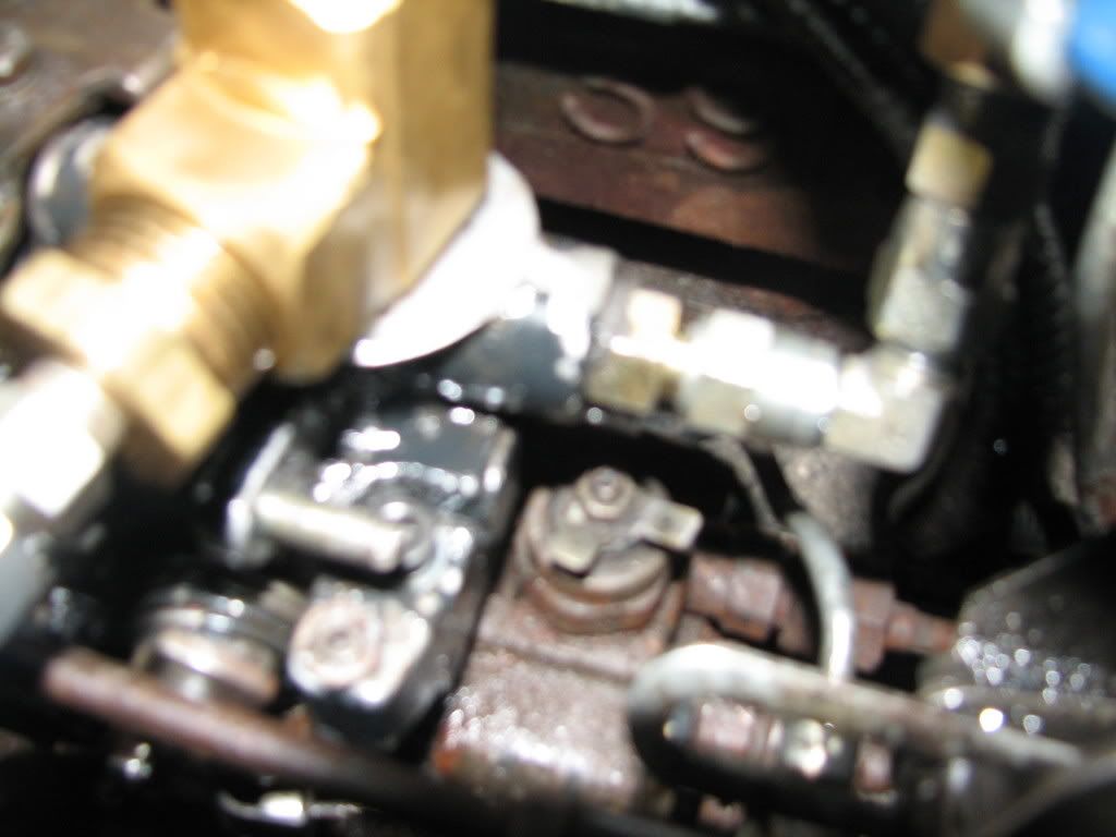

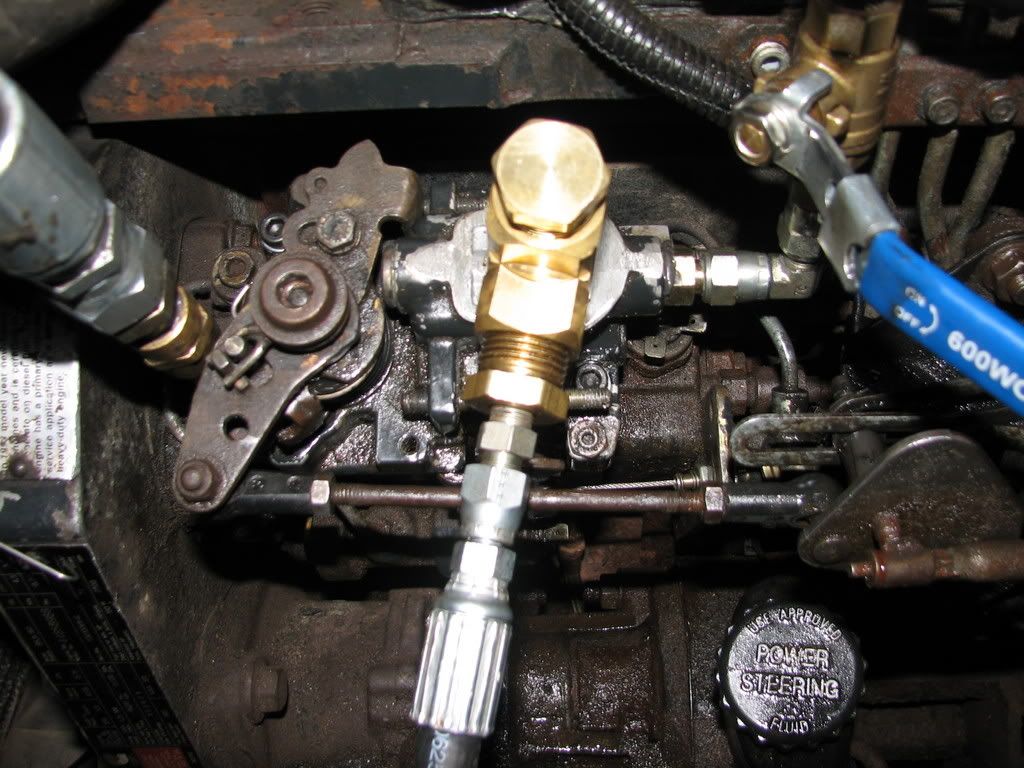

okay heres what my dual feed set up looks like
http://i274.photobucket.com/albums/jj25 ... G_1110.jpg
http://i274.photobucket.com/albums/jj25 ... G_1111.jpg
http://i274.photobucket.com/albums/jj25 ... G_1112.jpg
this is what i did to get those high numbers, i dont know if i should of done that or not i was told buy a expert that it would give me a nother 20psi in the pump not 100psi or more, in this picture there is a little nut, beside the line and between that nut i took a punch and i punch it down 1/8 of an inch
http://i274.photobucket.com/albums/jj25 ... G_1113.jpg

sorry the dual feed isnt hooked up yet the one line is for the gauge, and the plug on top is were the second line is going, i put the ball valve in so i could blead off the air, its 1/2 inch all the way into the pump
oh i almost for got, this is the most puzzling part, i lost 10pounds off boost, before i punch that thing down, and it made no difrence after i pumched it down, need help there
