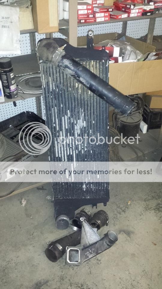

Postby Tacoclaw » Fri Dec 19, 2014 7:11 pm
Was it as bad as mine?
Re: 1989 W350 want an intercooler
Postby 762frmafr » Fri Dec 19, 2014 7:44 pm
I honestly think worse tacoclaw. The thing was COVERED!

Postby 762frmafr » Sat Dec 20, 2014 9:51 am
Picked up my intercooler and piping. Gonna order the reducing elbow now and some clamps. Hopefully it will be in before the holidays but I won't hold me breath.

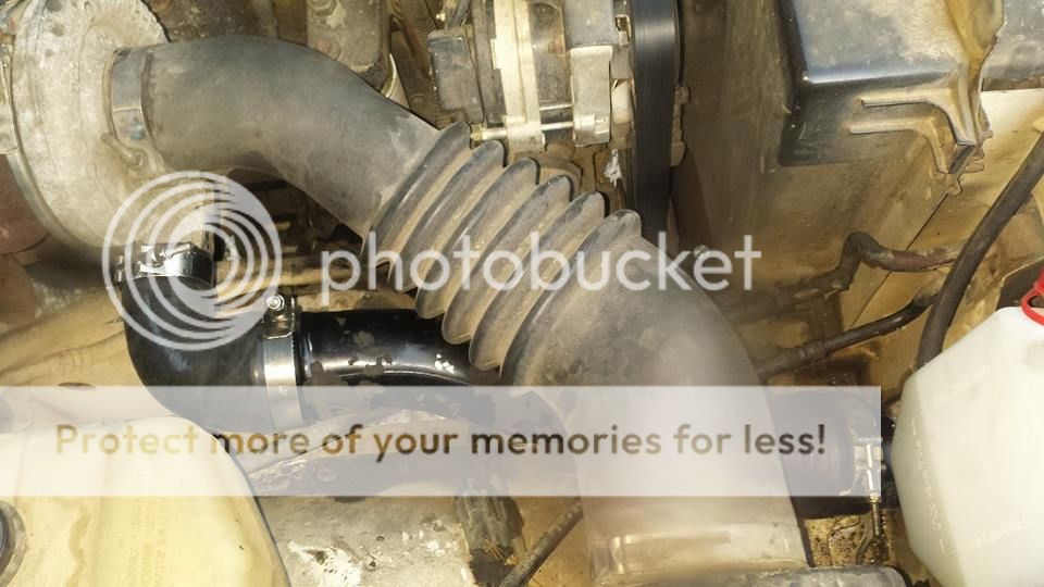

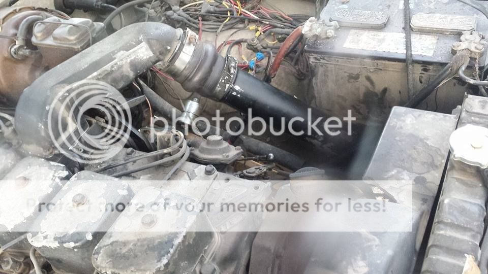

Postby 762frmafr » Wed Jan 21, 2015 4:51 pm
Well, I am a little behind schedule, but I finally got around to installing the Second Gen intercooler. Pretty straight forward. I haven't taken it for a test run yet, but I will report back on performance when I do. Thanks for all the info no this thread. PICS!!!!!!!!

Postby 762frmafr » Thu Jan 22, 2015 2:48 pm
Finally got the 2 longer bolts for the intake manifold today. Driving impressions? I don't have an EGT gauge so I'm not sure on that end. But seat of the pants feels like it is all on the top end. I goes from 60-defuel in 5th gear a whole lot quicker. I think I even gained a few MPH on top. I am happy with the install and I am sure once I upgrade the turbo it will be much better.
