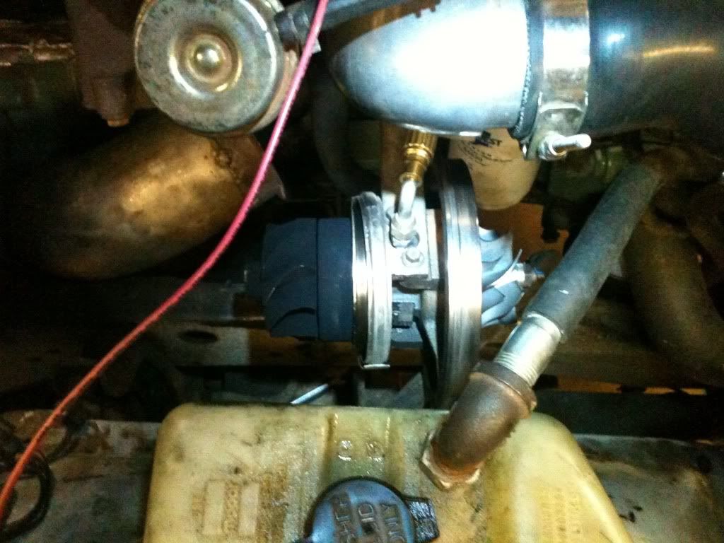

I popped my hood today when I noticed my boost wasn't quite climbing to 50psi when I gave it a nice run on the way home from work today. My hotpipe has once again started leaking at the V-band, even with RTV, foil, and fireplace door sealer stuffed in there. I even had the clamp double-nutted to keep it from backing off.
It seems as though this truck is going to force me to work on it whether I want to or not, so I'm gonna take the S400 off tomorrow after work and see what's up. :grrr:
I should have left it stock. :lol:

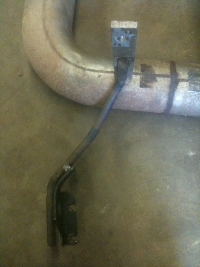

Got a good brace under the S400?

Meh, it's got a brace. It supports it's weight vertically, but I didn't brace it too much so the turbo could still flex side to side if the flanges weren't perfect.
I'll try to go back and find a pic of it.
Found some! It's 1" bar stock heated and bent, then I've got 1/2" strap welded to it that comes over and bolts to the top of the turbo. It's bolted to the two small boltholes on the motor mount that the trans cooler used to bolt to. I bent the bar 90* and ran it under the strap for about 5", it's welded the full length that it's under there. I'll sniff through my photobucket and see if there's a better pic I never put up.

It may be that when you get on it, you develop a boost/exhaust leak.

I found the pics, Oldest. ^
Those were when it was just tacked together.
I need to put a system pressurizer on it, I just haven't done it yet. I'll get on it this week, but no matter what happens I'm gonna have to address this damn V-band flange.

Well, as you can see there's nothing visibly wrong with the turbine side of the turbo. No shop rags to be found anywhere, either. I took the opportunity to file both V-band surfaces flat, so I'll try to get it back together tomorrow night and throw some shop air on it to test for leaks. :sad:
