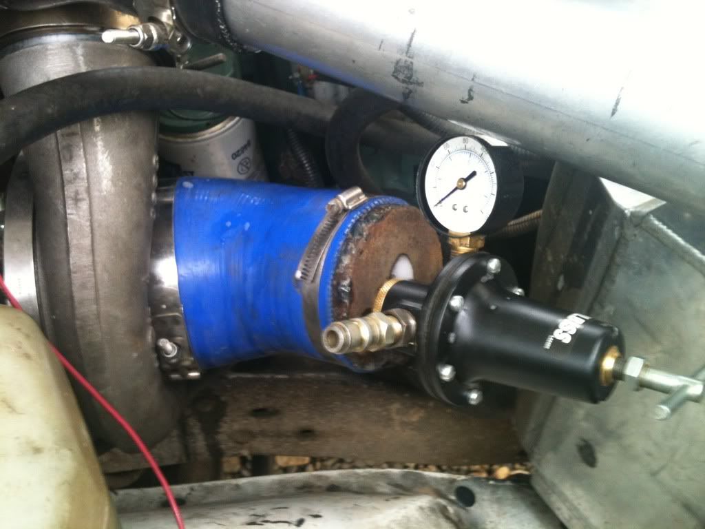

Well, my plan was to put the tester on and take a picture of the couple of leaks I had. More on that plan in a second.
First thing that happened is I stuck the tester in my intake, tightened it down, cranked it up to 20psi, and it shot the tester out at me like a cannon. Whoops.
I sanded and cleaned my pipe up, clamped it down extra tight, and tried it again. At 15 psi I had a decent leak at the outlet boot of my aftercooler. ;). Cleaned it up, filed down a burr on the outlet, and tightened it back down. The cowbell, of course, was full of pinholes all over and there was one intake bolt with a leak.
I ignored the last two, cranked the tester up to 20psi, and it was like someone set off a bubble bomb under my hood. :(
I'll have to get a bead on my tester and crank it up to around 40psi so I can be really depressed.

Why didn't you use PVC? Most guys do. I wouldn't worry about the leaks on the tester, unless the compressor won't keep up. It's not really part of the system, so it won't affect the way it runs.
And as for it shooting off there, must be you never read the posts on doing this test. They all say to be careful and cover the alternator or it can be damaged when, (notice I said when, not if ;) ) the tester comes out.
And yes, I did see the 45* boot, I'm sure it helped.

I've got to practice my welding somewhere, Pete. I know the leaks on the tester don't hurt anything, but if I don't mention them one of my so-called "friends" will. ;)
My tester actually shot into my aftercooler since that's where the location puts it. No harm no foul, besides me running away like a bitch when I saw it start slipping out of the coupler. :lol: Also, on that 45* boot, that could be the scariest part of the whole test. I'm almost terrified to turn the regulator up any, because that coupler swells up like a freaking football at 20psi. The other ones start swelling, but none of them even touch the size that that thing swells to.

Get a total seal muffler clamp and put it over the 45, it may hold a little more.

Actually, I found a 4" T-bolt clamp in my giant box of silicone couplers. Doesn't matter though, it's still embarrassing to go near my intake system system with soapy water when it's got pressure in it.
