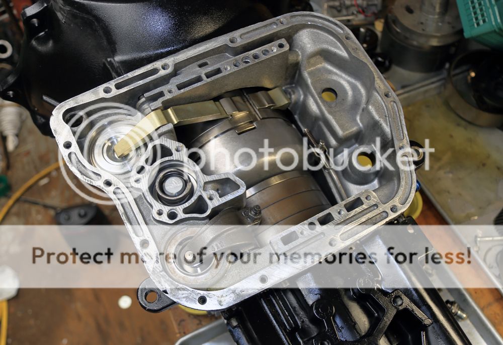

Remember earlier, I'd flat forgotten about the rear-band change, never mind I new nothing of the servo size change.
Well, once again the good folks at Suncoast saved my hiney. I needed a rear band servo BUT! I also need all the other components to complete the install in a 47RH case.
Wet everything with trans fluid and slip that boy in there.
Installing the rear-band servo lever completes that section.

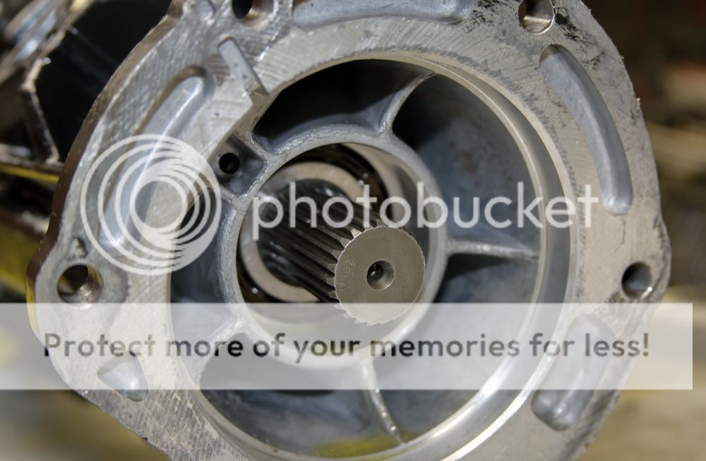

From there, I moved on to the pump body/stator assembly.
My original 46RH to the left and, the "reconditioned" 48RE to the right.
The pump from the 46:
And that from a 48RE:
Hmmmmm. See the difference? I wonder which is more desirable and why.

It turns out the trans fluid pump from the 48RE is, in addition to the larger lobes, is larger in overall diameter. The guy telling it said it might be around a 10% increase in volume.
OK.
I got the so called rebuilt. . . . whatever 48RE stator support from the same place I got the 47RH valve-body from. One of the pump-body's hydraulic fluid passages has crap in it that I can scrape loose with a pick. I've got it soaking in some stiff metal-safe cleaner. I'll get the pressure-washer after it tomorrow.

Alright. Got the pump body fluid passages clean. I then installed the mo'betta Gerotors in the oil-pump body.
Then installed the oil-pump cover/stator shaft assembly. Torqued the bolts to 180in/lbs.

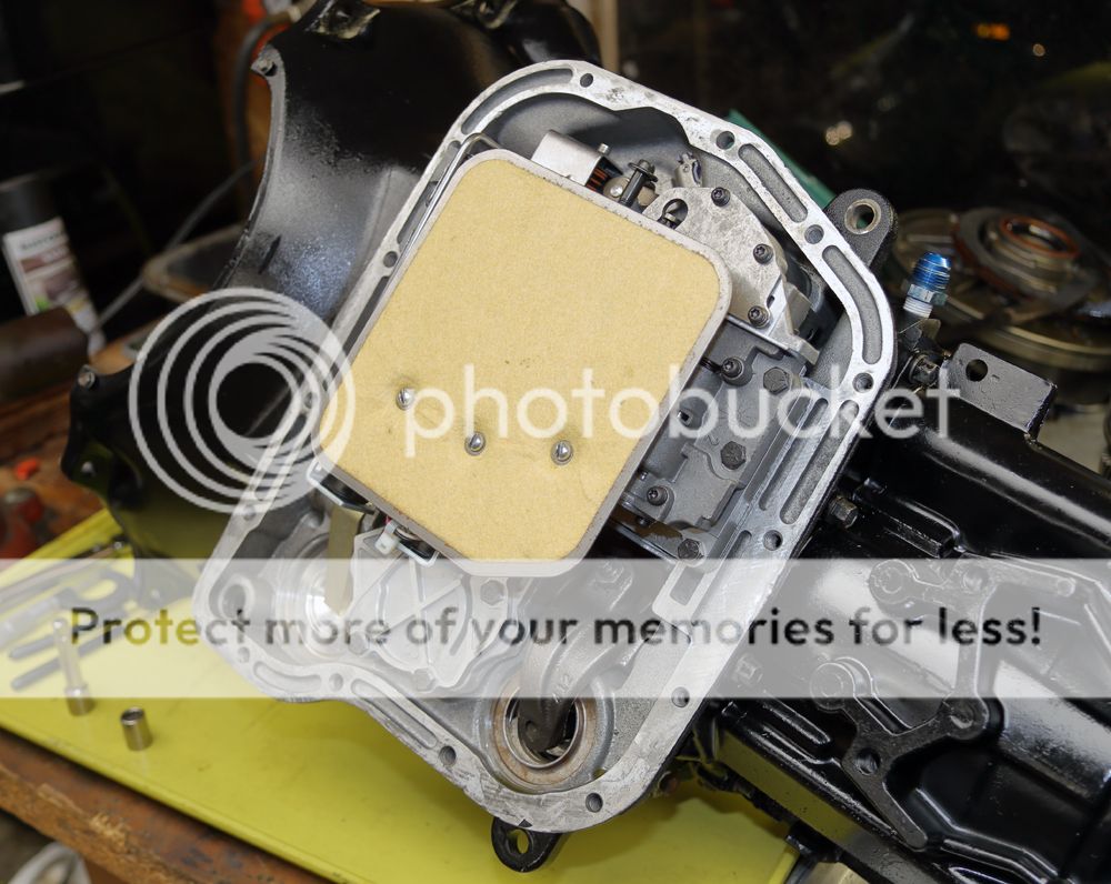

I forgot to mod the valve-body for 2nd gear lock-up. :shock:
Crap.
Disassembled the VB enough to remove the lower housing. Using PermaWeld epoxy, blocked one of the worm-tracks associated with the 3-4 shift spool-valve and the converter clutch spool-valve.
Put it all back together, . . . . again. Then installed the overdrive and converter clutch solenoid-valves.
Nailed down the solenoid plug and reset the line-pressure adjustment.
Before I install the valve-body, I want to check the operation of the bands and clutch-packs. I do that with a regulated supply of dry Nitrogen gas.

Got the dry Nitrogen and pressure-tested the clutch-packs and servos. Nice and smooth with no "What Is That?!" hissing.
After lubing the shifter and electrics-plug ports, I installed the valve-body, park/neutral safety-switch and oil filter.
