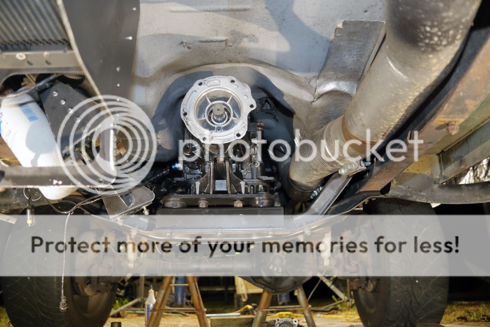

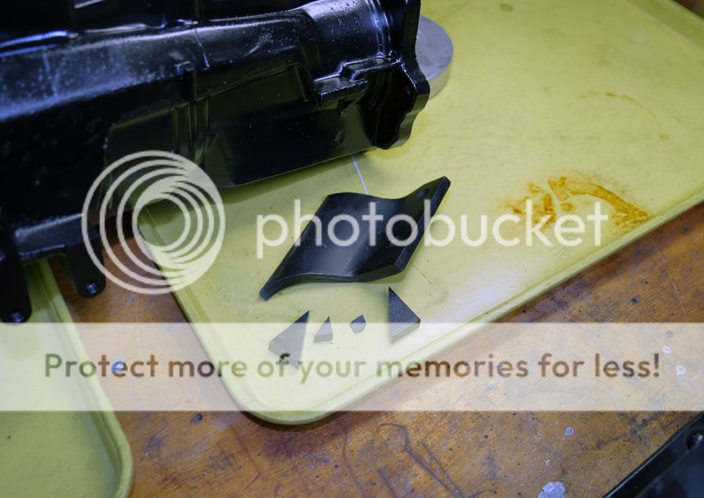

I've moved on to the transmission's rear mount cross-member.
From what I've gathered, most folks doing such an install move the entire cross-member/transmission mount assembly rearward 1.5" ~ 3".

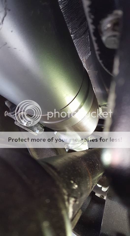

I can't do that. I've got 5" exhaust sthi all up close and personal with the cross-member's diagonal on the passenger's side. In the following pic, the transmission's oil-pan is to the right. The front drive-shaft is on the bottom. You're looking at the 5" mess changing over to triple-lock stainless flex to get over and around that diagonal brace right there. NO room to move anything.
On the driver's side, I've got the transmission's fluid-to-fluid heat exchanger with a supplemental trans fluid filter all mounted between the big cross-member and the skid-pan's rear cross-member.

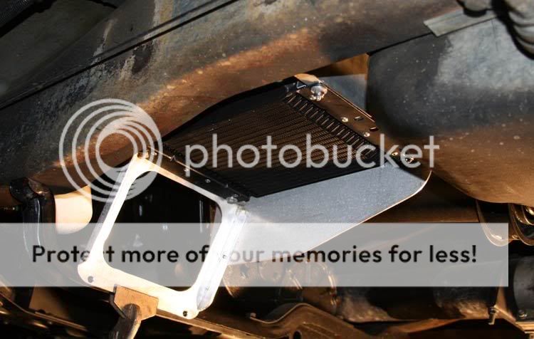

A little further back, I've got a fan assisted transmission fluid cooler mounted between that skid-pan rear cross-member and another, upper cross-member just in front of the fuel tank.
With all that. I can't move that big cross-member back without having to do a lot of . . . .other stuff.
So, I did this . . . .

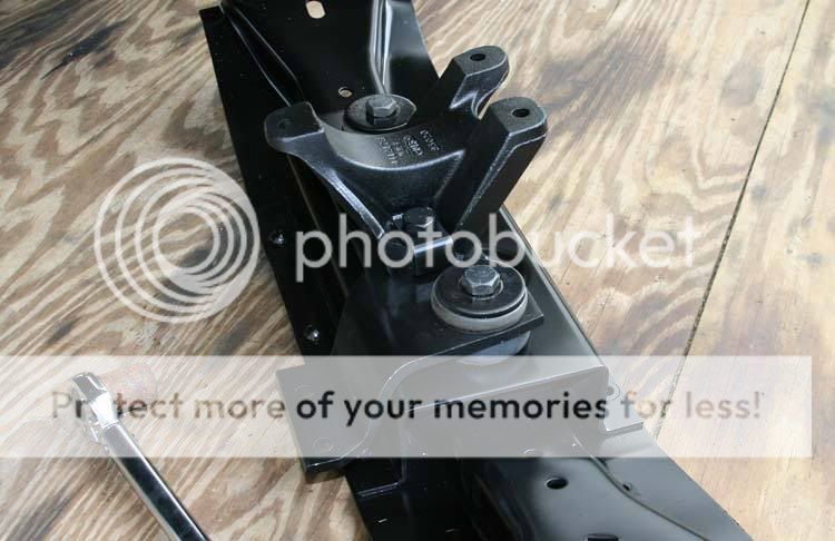

The stock/OEM frame cross-member/rear transmission mount for my truck looks like this.(The left side in the image faces the rear of the truck).
The bolt-holes in the cross-member for the resilient-rubber rear trans mount, . . . I moved those holes 1.125" rearward.
The lower/rear of the transfer=case is now gonna be in the same space the skid-plate cross-member is. I expect I'll have to whoop out my paring-knife.
Speaking of the paring-knife, While I had the trans mount stuff apart, I cut I bet three or four pounds of useless iron from that plate between the rubber isolators and the actual transmission mount thing.

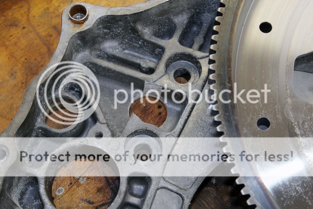

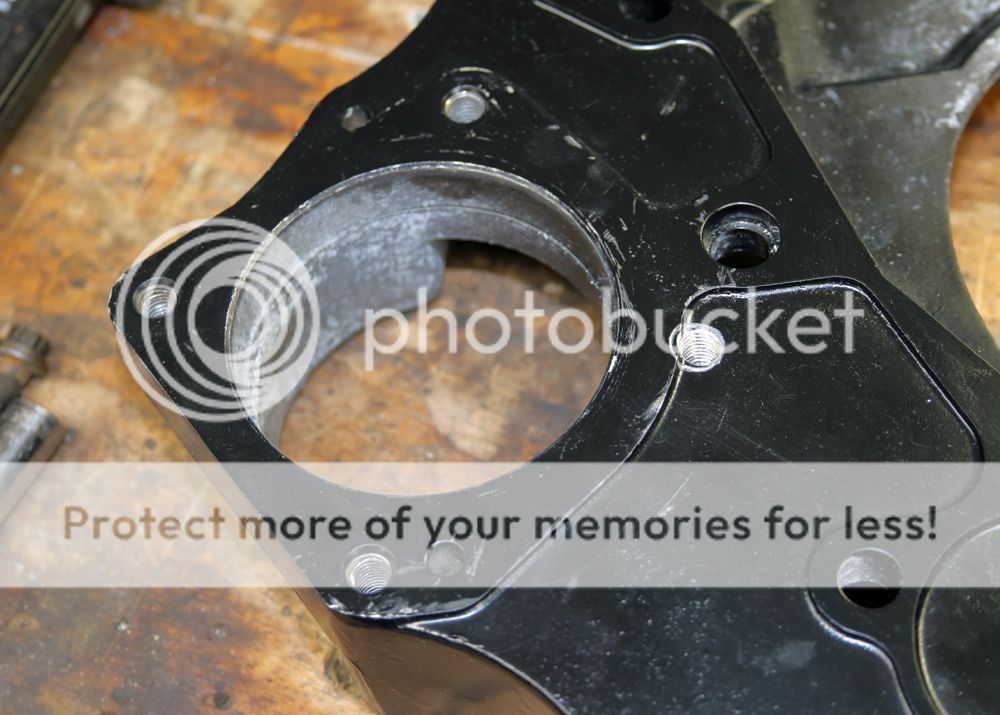

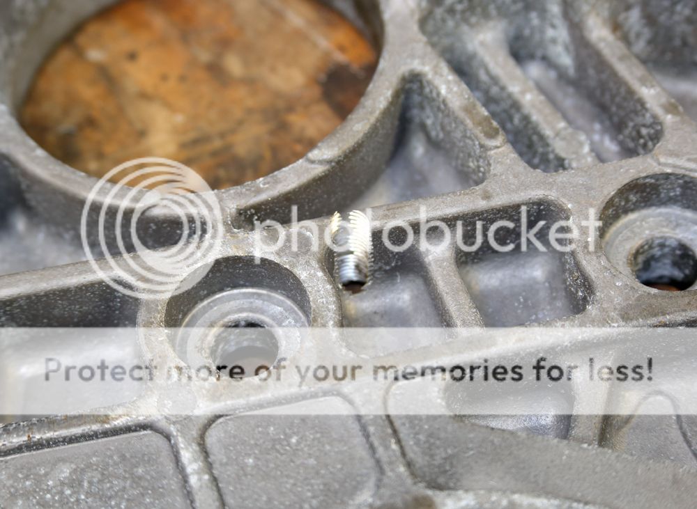

I started with using a tap to chase all the bolt-hole threads. Then I set the new 2nd Gen starter in place.
It's immediately apparent that Dodge changed the clocking of the starter going from the 1st Gen to the 2nd Gen. I've confirmed I got the right starter doing research about the thing. One fella commented about a 1st Gen swap to be ready to bend a driver's frame-flange a little to stop the thing from rattling against it. I read somewhere else were a fella was doing a 47RH swap into . . . something and was wondering if he could use a 1st Gen starter he had. Another said no as the 2nd Gen was a little longer and clocked differently compared to the 1st Gen starter.
Well chit. Naturally I can't do that as I've got a bunch of fuel and transmission hoses running through that space.

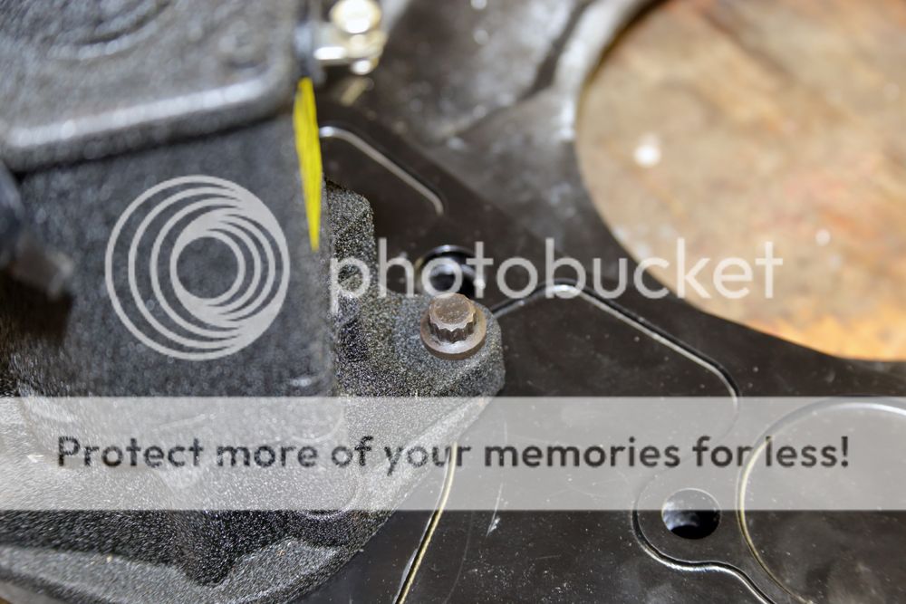

So, I re-clocked the thing. I had to drill and tap a new bolt-hole in the engine/transmission adapter.
It just so happened to fall right at a rib of the adapter.
Now, the new 2nd Gen starter falls much more into the space the OEM 1st Gen starter was in.
That new starter mounting bolt-hole was just off the milled surface the starter's suppose to be against but, it easily holds the factory spec torque of 32ft/lbs.
The mounting bolt engages well in the threads. In hind-site, I suppose I could have drilled shallower but, I figured I needed a little more depth to accommodate those first four thread dies of the tap that taper to start the tap.

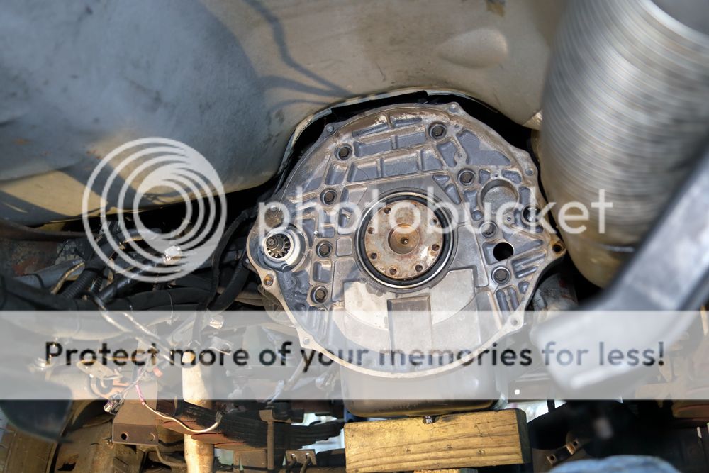

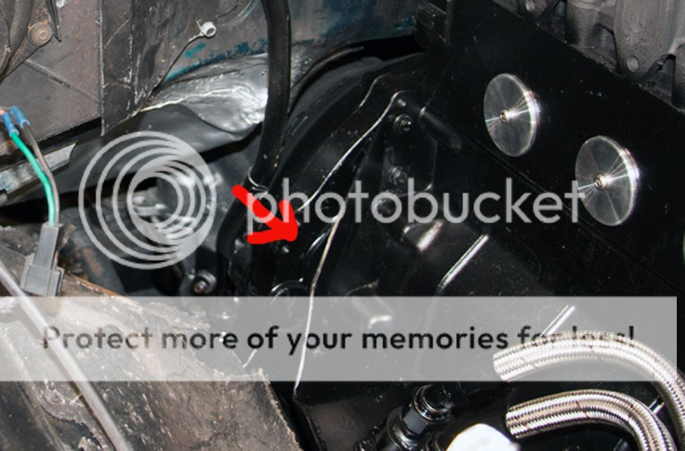

When it came to installing the 46RH torque-converter bolts, I've always just stuck a wrench in that space at the bottom of the trans bell-housing.
I can no longer do that as that access to the bolts is no longer there. The converter moved deeper in the engine/trans adapter.
Well, I reckon I could use the stock/OEM converter bolt access-port in the engine/trans adapter right?
Hell no, not on my heap. I've got the custom engine oil-filter relocation bracket passing in front of that access-port.
Crap!

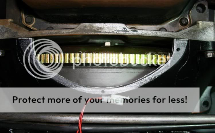

Perhaps I can cut a hole just down, and in the flat of that triangle space ('93adater shown for reference). That would give me relatively straight access to the converter bolts without needing 5 3/8" socket-wrench swivels.
Hmmm . . . .
We'll see, huh?

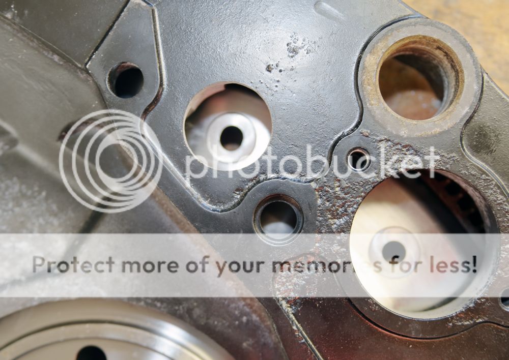

Postby BC847 » Sun Nov 24, 2019 6:24 pm
Today, I ciphered where the new bolt access port needs to be and cut a hole.
That location came at the expense of a web in the casting between two engine mount bolt points. Dang it!
Before mounting the thing, I chased all the engine block bolt holes. While I was there, I looked hard at that camshaft bore plug. It and the smaller freeze-plug next to it present as being corrosion free. At least on the exterior anyway. I got a replacement cam bore plug thinking if it looked to be in distress, I could replace it while I had everything in front of it out of the way. Still, if I replaced it, and I ultimately somehow failed at having the new plug being oil leak free, it would be a damned mess.
I left well enough alone.

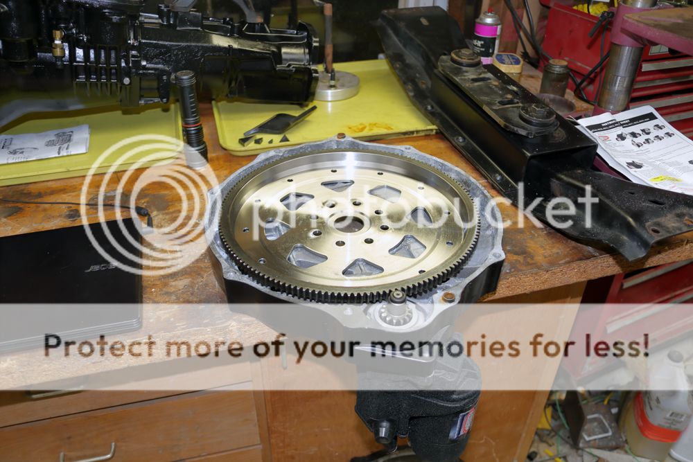

Alrighty then. I got the new transmission/engine adapter installed. The bolts are at 30ft/lbs with blue Locktite. The starter location fits just fine with seemingly ample room around it. I did have to ding the stupid 5" exhaust down-pipe about a quarter-inch at that 2:30 bell-housing bolt hole though. Dang it. That's the kind of chit one has to accept if everything on the heap is custom crap!
To add insult to injury, now that the adapter is in place, it appears there would have been workable access, albeit quite restricted, at the OEM converter bolt access port. Dang it!

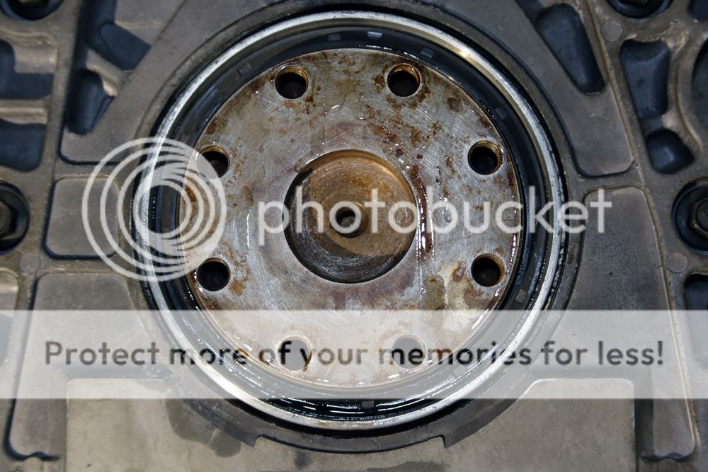

Next, I'm replacing the crank-shaft's rear seal. With the disassembly for this project, it was found to have been drooling appreciably although I suspect less than parallel cylinder walls has a big effect on seal integrity with big boost on my heap. Here, I'm pulling the old seal out with a self tapping screw and a hammer. Like pulling a nail.
With having wiped clean all the seal surfaces, then oiling the crank-shaft and interior surface of the seal, I used a fancy seal install tool I got a while back. It assures the new seal is square to the crank-shaft and is installed at the correct depth. Quick and easy.
NICE!

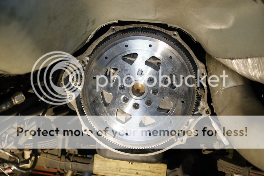

To end the day (it's getting dark outside), I installed the new billet flex-plate with new ARP bolts, torqued to 120ft/lbs with blue Locktite.
(Of special note: I've had an engine barring tool for some years now. I've never used it because there was an HT3B in the way. The tool came in quite handy today holding the flex-plate steady while I pulled the bolts up). Kewl!

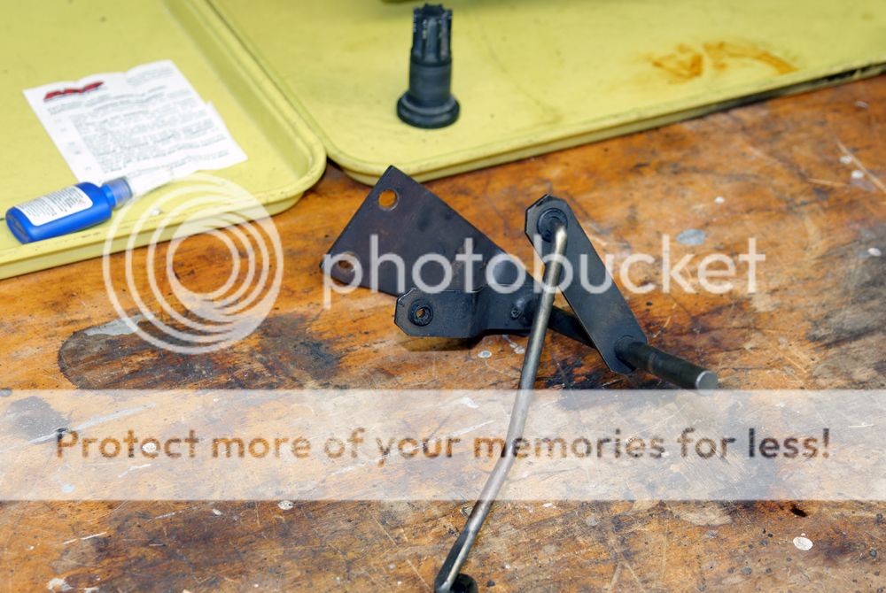

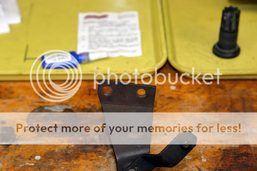

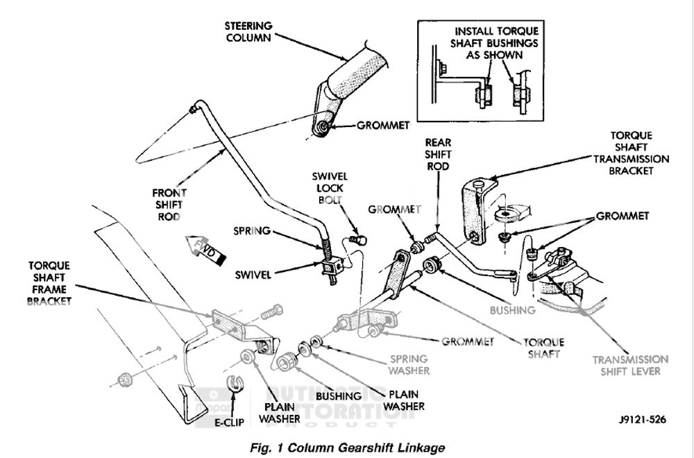

The transmission's gear-shift linkage on the other hand, isn't so cut and dry. Either folks who've done shut a swap don't talk much about it or I've just plain missed such in my research.
Knowing that I'm dicking with not only the gear-shift linkage, but the TV-cable too. I'd rather not try something that might require modifying the cable so, that narrows things down in my head. Here's the gear-shift torque-shaft assembly.
I figure if I move the torque-shaft's frame bracket bolt-holes forward (to the right in this image) 1.125" will be the only thing needed to make it all work. I "think" tweaking the front shift-rod will keep it out of the firewall. We'll see, huh? I'd love to simply drill two new bolt holes in the truck's frame but the inner-fender mess is in the way never mind getting a drill in there and punching 1/4" or so steel.
