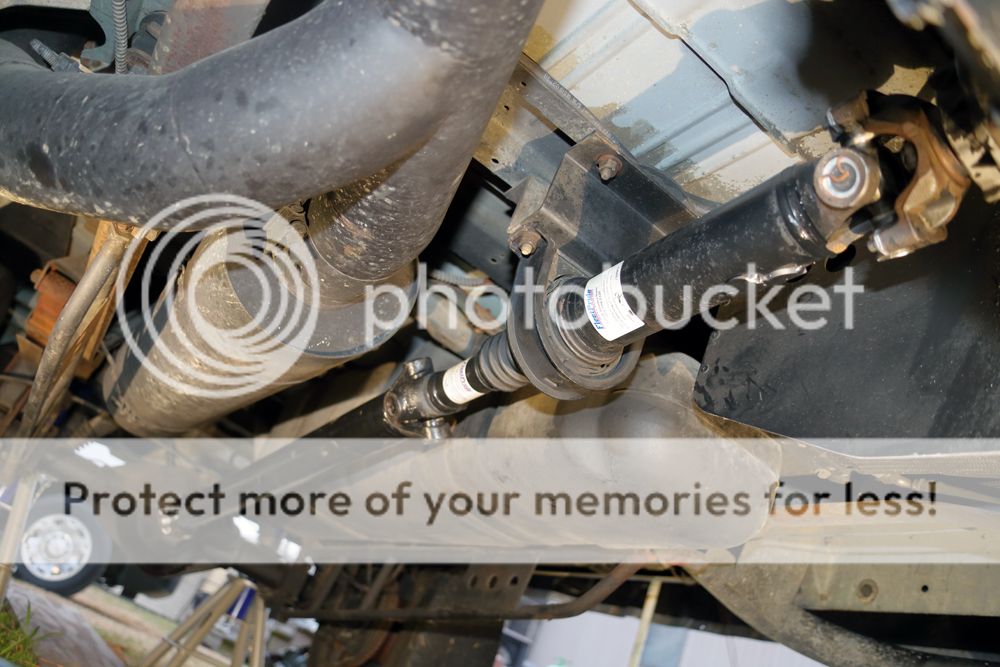

Well, I did manage to install the driveshafts, . . . for the most part.
I started with the front driveshaft's double-cardan CV joint and torqued it's bolts to 65ft/lbs.
I apparently failed to look in the box and ensure I got the correct universal-joint mounting straps. DOH! One can see the new telescoping-joint in the assemble. I believe there's suppose to be a bellows-boot on the thing. Anybody have suggestions?
The rear driveshaft was pretty-much straight forward (with it being the correct length). The carrier-bearing mounting bolts to 50ft/lbs and, the universal-joint straps to 25ft/lbs.
While I was under there, I checked the torque of the transfer-case's case bolts. Got the transfer-case vent assembly installed.

Postby PToombs » Sun Dec 08, 2019 6:32 pm
In my experience, the front slide joint should not have a bellows on it. It has the seal under the screw on cap on the front piece. You can add one if you want, but it's not necessary.

I saw the seal in there. Yup, I can see where a boot could hold moisture/debris. Thanks for the reply.

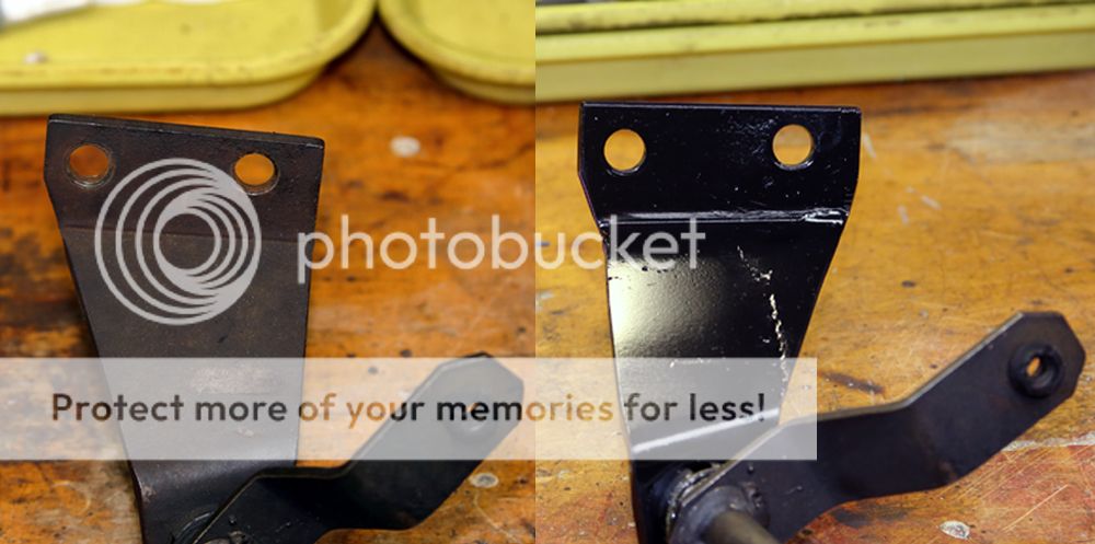

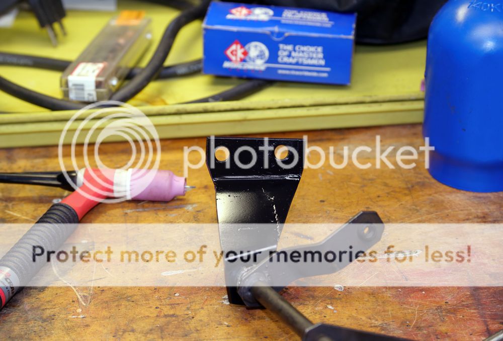

Alright, remember the stock/OEM transmission shift linkage torque-shaft bracket? It too needs to move back 1.125".
I whittled on it some and moved the location of the torque-shaft's bushing rearward 1.125".
Compared:
I like to think things will just fall into place.
We'll see, huh?

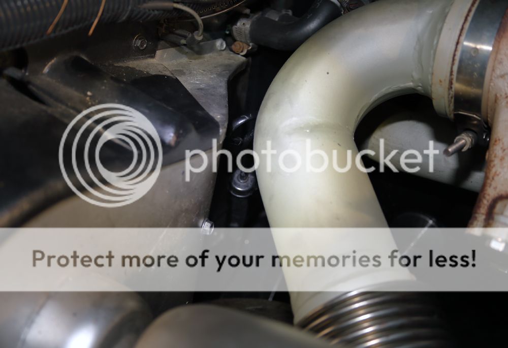

An example of my world . . . .
All I wanted to do was add a 90* Ell to the pressure switch for the CompuShift right there at the front servo port.
But NO! I had to look back there at the tranfer-case shifter thing!
The damned Governor Pressure port plug and a rib reinforcement on the 47 case was under the transfer-case shifter's mounting bracket. When I blindly installed the shifter, I tighten it on down and apparently bent the mounting flange.
Dang-it!
So, . .
- I pulled the shifter out and ended-up cutting the corner off the shifter bracket to clear the case's reinforcement rib. That required me to weld a plate adjacent to the cut so as to reinforce/hold things together.
- I know pipe-plugs are available that have a recessed Allen-type hex-head. I searched the shop high and low. Nuthin.
- Went to Lowe's to confirm they only had what I didn't need. (DUH).
- Bought a brass plug that had the external four-sided wrench head thingy. I was thinking I could just fill the thing with solder, cut the square wrench head off, and cut a flat-blade screw-driver slot in the thing.
- Got back home and figured I'd need a female 1/8" NPT fitting to hold the plug safely while I cut it.
- Naturally, I only then found the phacking recessed Allen Hex pipe-plug I was looking to start with.
Dang-it!
It's hard to see but, it all fits like it ought to now. PITA!!
