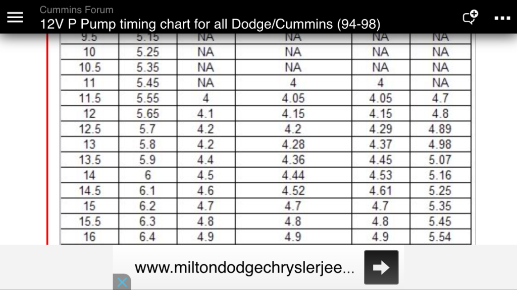

Postby dazedandconfused » Mon Oct 27, 2014 5:55 pm
To many differing numbers. I attached the page shot above of the download.

Re: Cummins/82 C10
Postby KTA » Mon Oct 27, 2014 6:19 pm
It is easiest and cheapest to just time the truck with a tape measure. You don't need any special tools and you don't need to pull any delivery valves. You can't go by mm lift anyway unless you know the exact pump you have as dodge used different cams in different CPL pumps so you have to know what lift is right for what pump. Assuming the pump you have is correct to your motor the factory timing is marked on the front cover. Then what you do is pull the big 15/16 plug off the side of the gov housing in the back and roll the engine over till you can see what looks like a flat blade screwdriver pointing out the center of the hole. When you took the plug out you can actually turn it around and it should freely slide back in over the blade, this is factory locked time as to how it was installed. When you have it centerd where the plug will slide in and out nice break the gear loose off the front, don't leave the plug in as sometimes they can break. After it is loose stick the plug back in locking the blade. You can then roll the engine over till it is on TDC using the pin in the timing cover. Assuming it was in time already you should be already there. If you want to advance it turn it backwards rotation how ever much you want to advance it and lock it down. Pull all your timing pins back out and lock everything down and you are good to go. You can measure your dampener diameter and determine how much movement is a degree with some basic math. I always just draw a line at the fanbelt when it is on TDC and measure from there. Just remember that at TDC with the pump locked it is already at what the timing cover says so if it says 12deg and you want 16 you only move it 4 advance because it will already be at 12 when the engine is at TDC. Depending on the rpms you operate at, your injectors and how much abuse you want to give your headgasket will determine the best timing. 30+deg for a street truck with 5Kgov springs and big injectors would not be too high.
