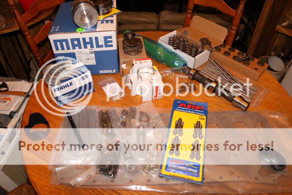

Postby BC847 » Mon Jun 08, 2020 7:40 pm
Starting to get replacement parts in. Gotta get one of the pistons to the shop so they can do the final honing/lapping stuff. They have the service/replacement valve-guides on order (should have them by now). Having to outsource the crankshaft balancing (the shop's machine is broken).

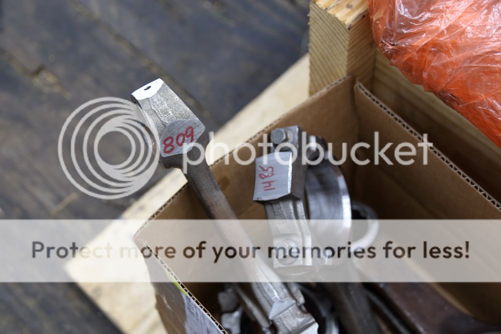

I actually got a phone-call from the machine shop saying they've got everything done but, they found a set of connecting-rods on the bench with my name on them. Asked what I needed done to them. :roll:
I like to think they will call again this coming week to tell me to come get it all.

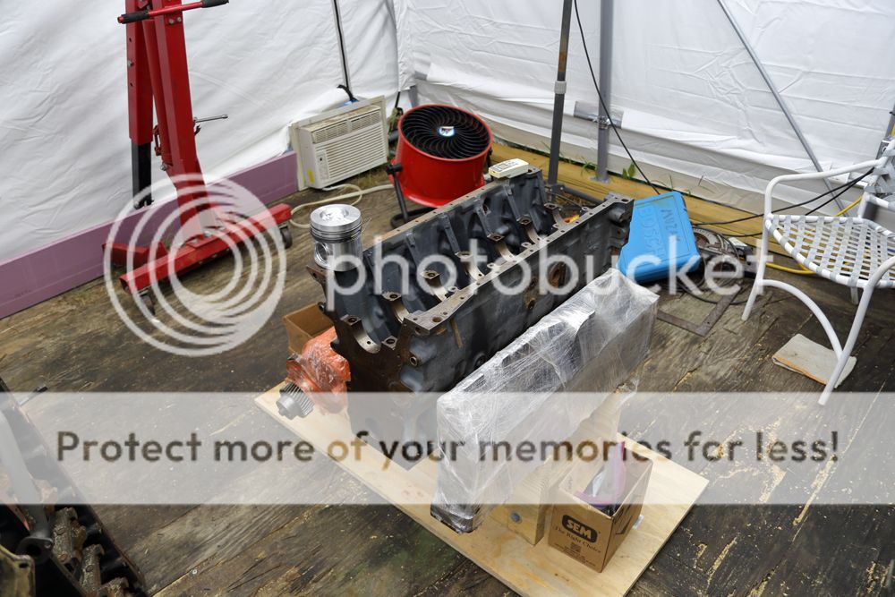

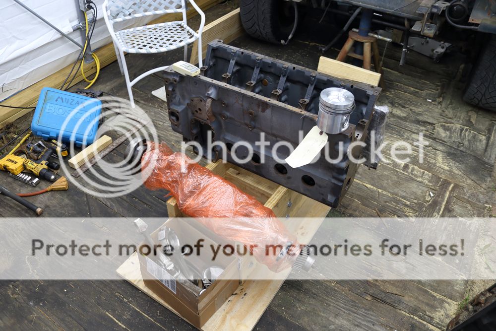

Postby BC847 » Wed Aug 26, 2020 7:07 pm
Holy Crap, Batman!
Head: New valve-guides. Still using the Top-Hat style valve-stem seals. Refreshed valve-seats.
Valves: Reused with refreshing machine work. (These have been Back-Cut).
Block: Bored 0.020" over. New camshaft bushing.
Crankshaft: 0.010 over both rods and mains. Balanced. (I've got Speedy-Sleeves for both end seals).
Rods: Big-ends resized. Small-end bushings inspected/replaced as needed. Balanced.
We'll see. Huh?

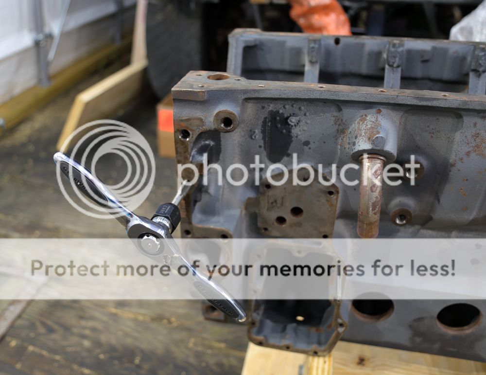

Postby BC847 » Sat Aug 29, 2020 9:13 pm
Managed to start with chasing block fastener threads. Got all four sides as well as the oil-pan rail.
- Still have to bottom-tap the mains for studs.
- Still have to do the top including bottom-tapping for head-studs.
The typical gunk found in the exterior bolt-holes.
