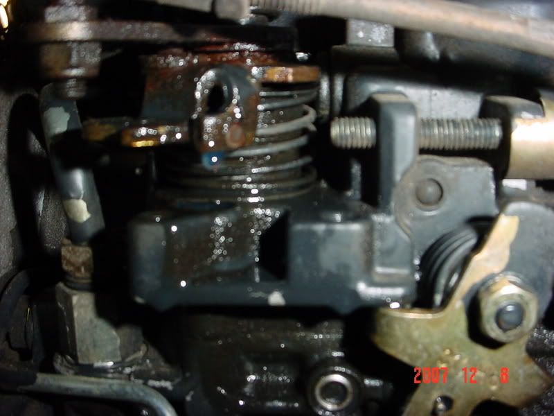

After doing all 6 lines, the truck fired right up and ran great, except fuel was leaking from the IP. (pictures below) I ran it for a little while, shut it off and went to bed. The next morning it fired right up but didn't leak anymore! It ran for about 35 minutes while I jockeyed trailers around my yard, then it quit running again. It hasn't run since.

Here is where it was leaking: (sorry for the blurry pic)

You have fuel leaking from the throttle shaft. Have to pull the cover to replace the O-ring. The bushing may be bad too, with that many miles. While the cover is off, spend the $20 on a governor spring. You'll like the difference! ;-)
