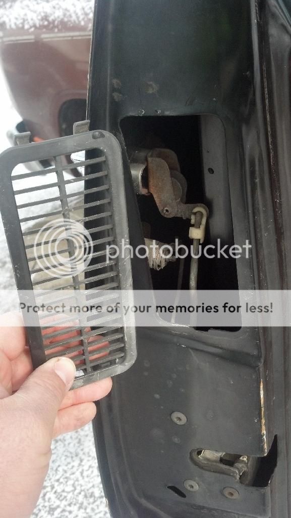

Postby RumbleFish » Mon Jan 06, 2014 11:31 am
Just started my turd. Had it on the plug all night and the grids still came on. I was cussing but it cranked and fired fine. Then my fawking door latch decided to take the day off and the door wont stay shut. Been fighting it for a while. Not sure if its just froze up or broke for good.
Postby dazedandconfused » Mon Jan 06, 2014 11:37 am
Jeff mine did the same. Pop the cover off the side of the door and spray out with penetrating oil while working it with your finger.
Postby RumbleFish » Mon Jan 06, 2014 11:44 am
A tarp strap to the headrest will do for now. Not sure if my pb blaster will work this cold lol
Postby dazedandconfused » Mon Jan 06, 2014 11:51 am
I just popped it off and pushed the latch up with my finger. It took 10 seconds. I don't have anything at the house so I left it off.

Postby RumbleFish » Mon Jan 06, 2014 1:37 pm
Well after letting it warm up it seems to work. I blasted everything i could see (door panel was already off) and adjusted the striker post. Shuts pretty nice...for now lol
