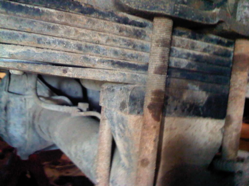

you can see them here:

Postby BILTIT » Sun Oct 02, 2011 1:09 pm
oldestof11 wrote:Derick, not to rain on your parade but if DOT of IL (don't know about other states) finds you added "blocks" to the front axle, MAJOR violation. The blocks are not approved nor safe.
They are not blocks, they are a thick add-a-leaf. They are part of the spring pack and held in by the centre bolt, not just the u-bolts like a regular block.
