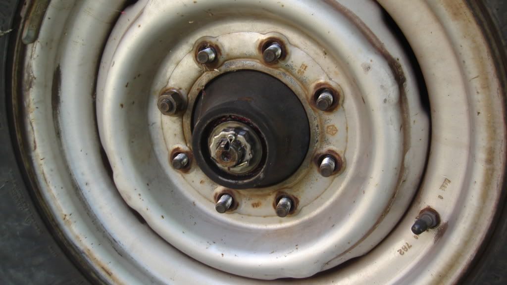

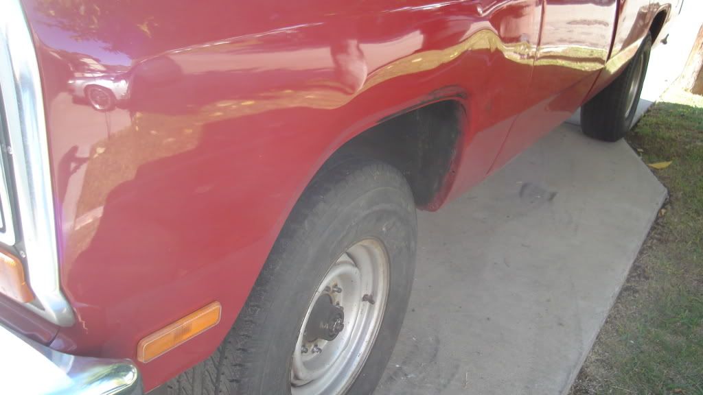

Why did my lugnuts decide to all fall off at 65 miles per hour on the freeway? Are these rims incompatible with the stock hubs and lugnuts, or was I the victim of stupid wheel monkey/ sabotage/ seriously absent-minded wrenching on my behalf?
I got these aluminum rims back in May sometime; they came with crappy rubber, so I bought new rubber from a tire shop and had them swap rims for me. I've driven 1,000 miles at most since then, probably closer to 500; for the last two months it's been sitting in my driveway while I installed my new turbo. I sure don't think I ever loosened them or took off my tires during that time; I didn't even realize until I was on the side of the freeway that I needed a low-clearance socket to get to the nuts, and I don't imagine that would've surprised me if I was the one that loosened them up to begin with...
Pretty amazing how well these things handle on only three wheels, if ya'll haven't had the opportunity. :shock:

Sucks that it caught your fender... :evil:
