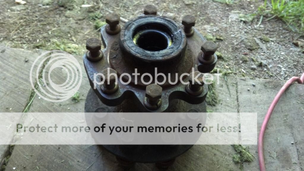

finally have started to throw dually hubs on my truck (up front), looks like I can reuse my old rotors (allready 1ton rotors), they have about 1.5 inches of rotor thickness (parts store guy says the most popular rotors are 2 inches thick)... yet the distance from the rotor to the inner bearing race is the same, so im reusing my old rotors.
anyways... long story short, hub needs 8 14mm bolts (best fitting bolt I could find), that go thru the rotor 5/8 hole (about 17.8 mm)...
so I need 16 bolts, that are 14mm coarse thread, with a 5/8 shank, only about 1inch long....
anyone have these bolts? or know where I can get some? Dodge told me to pound sand, napa has no clue...

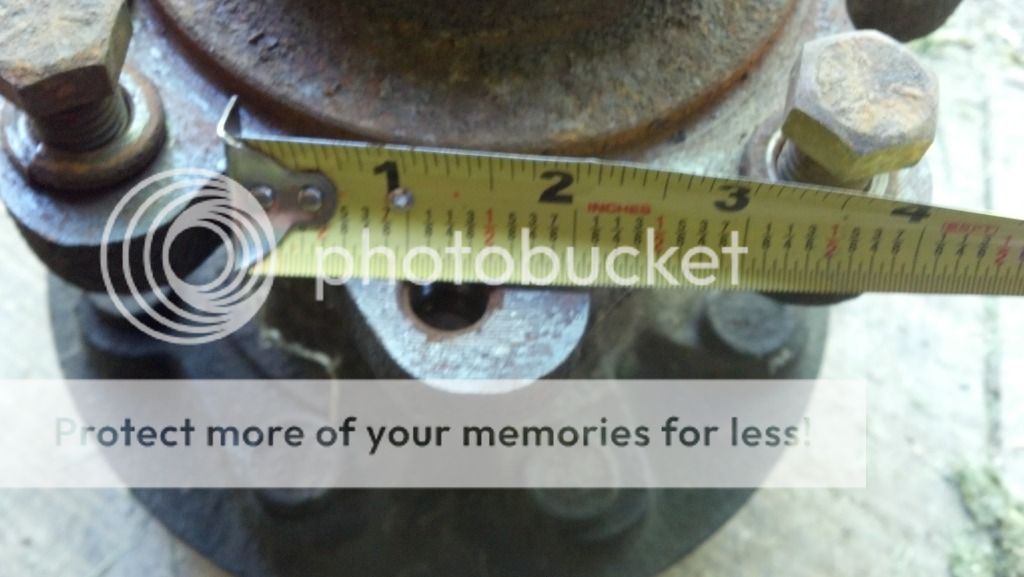

so the 2wd hubs have 1/2 bolts... interesting, tried a 9/16 bolt in my 4x4 hubs and they fit perfect, still weary about the fact that its a 9/16 bolt in a hole that is about 18mm... almost 13/16 with no shank.
anyways, guess ill just use lock washers and call it good, thanks

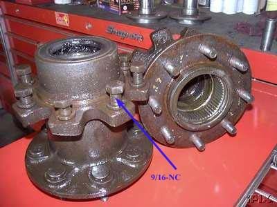

Postby Mark Nixon » Mon Apr 30, 2012 9:58 pm
You might have better luck using a Chevrolet application to source the bolts new.
Go with a 1985 1 ton Dually app.
They ARE 9/16s Standard thread, BTW.
