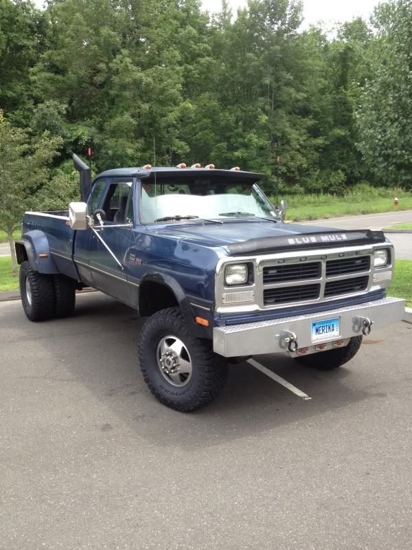

Well I decided I want to flatbed my truck.
Here's the truck as she sits now

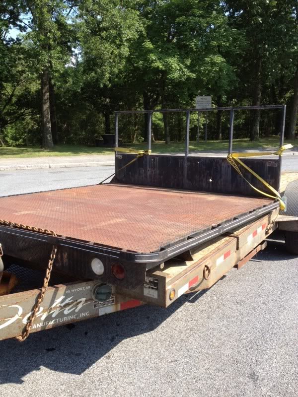

I picked this up last sunday
And I want a wooden bed so I cut out the diamond plate deck
Got rid of some of the headache rack too.

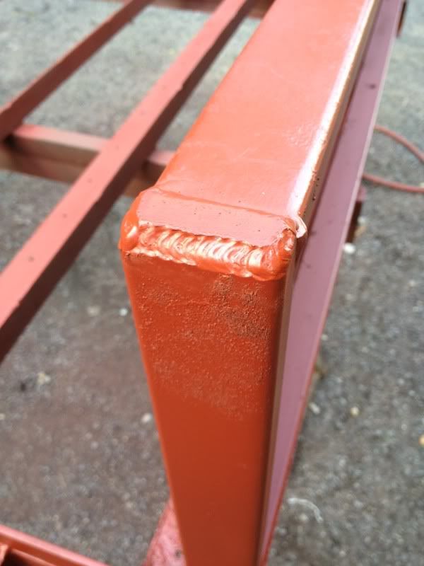

Hoping to maybe pull the bed off tomorrow. I also need another day to finish spraying the black paint on the bed. I ordered 2 inch red oak for the bed, and am edging it in 2 inch x quarter band metal that I welded on already. More pictures to come as it progresses.

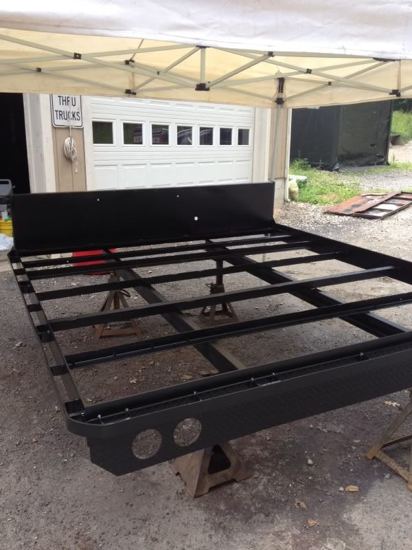

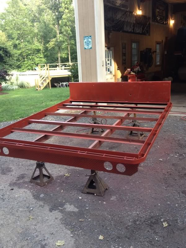

Got the flatbed frame all painted today. Pulling the bed off the truck tonight.

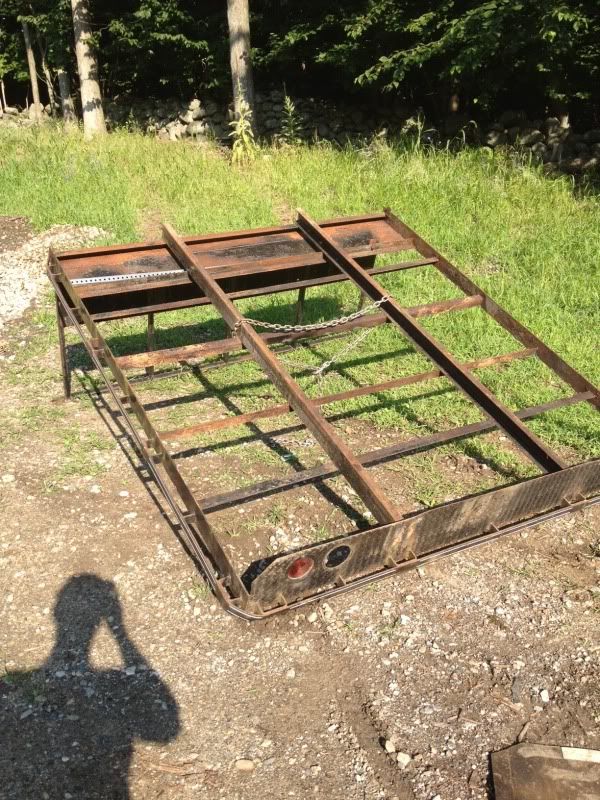

Postby Burritoboi5 » Mon Jul 30, 2012 7:23 pm

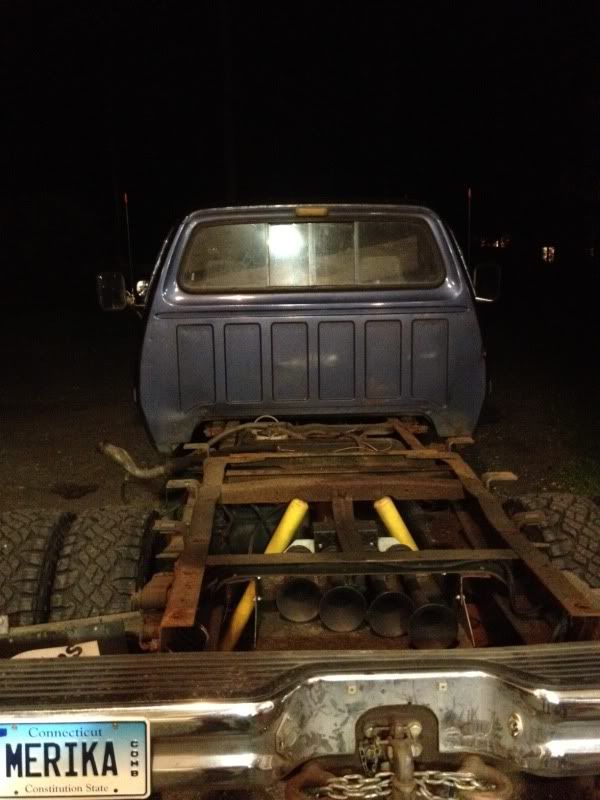

Well it took about an hour and a half, but I got the bed off. Maybe try to sandblast and prime it tomorrow if I have time.

Postby PToombs » Tue Jul 31, 2012 4:25 pm
Loks like somebody is horny! :lol: You should have those facing the other way! ;)

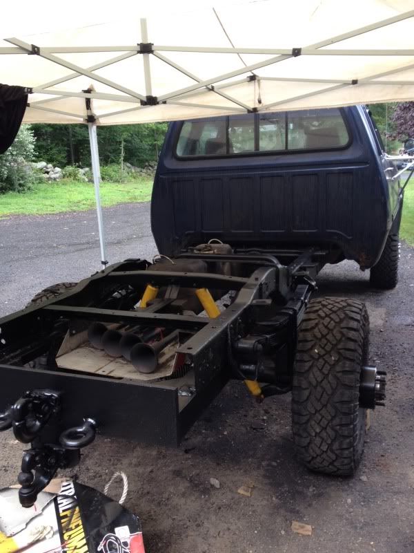

Well I got it all sandblasted, dropped the tank, pulled the shocks, the whole shebang.
Then primed/sealed/and undercoated with truck bedliner.
I also went ahead and redid the rear brake lines, hard and soft. Just left the ABS crap out. I mounted up my horns, and ran some of the wiring. Tomorrow I hope to finish my wiring and mount my rear lights as well as get some more woodworking done.

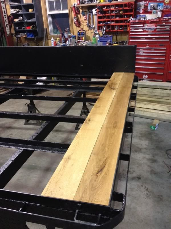

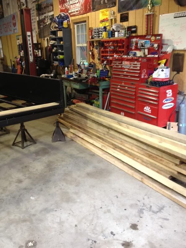

Here's what I have, just rough cut red oak 2 inch actual thickness.

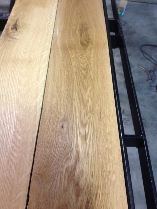

After a lot of sanding with the 4 inch belt sander I get this....
That's with two coats of tung oil. Going to apply 6-8 before it sees the light of day.
And here's a closeup. The pictures don't do the wood justice.

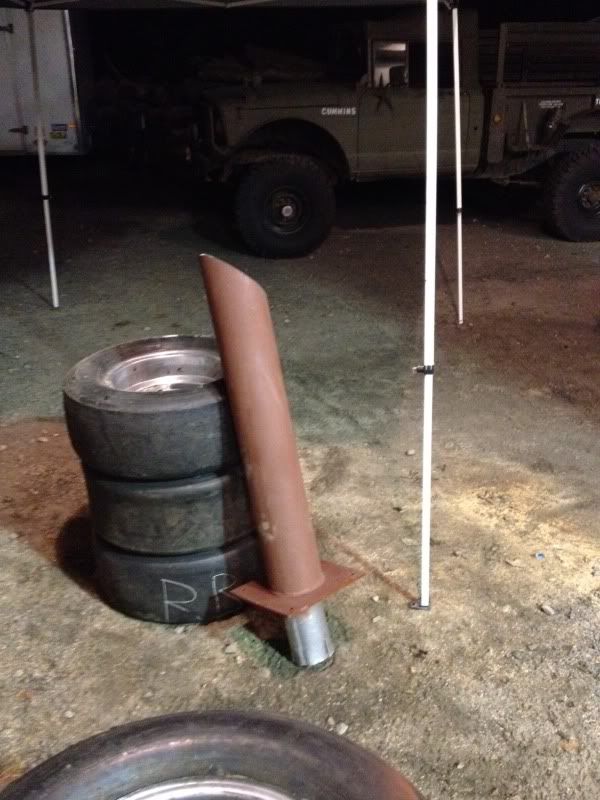

Today I was able to complete all the wiring in the ass end of the truck. Got my new lights mounted and functioning as well as auxilary reverse lights. Also got my trailer wiring and running lights loomed and ready to go for the flatbed. I bled the brakes while I had someone to give me a hand. And put in another board. Lastly, I was able to cut my stack down to the proper height. It needs more finish grinding and paint as well as provisions for my flame thrower.
Tomorrow I will fix the cab corner and primer the rear of the truck so I can prep it for paint before the bed goes on. Then hopefully knock out some more of the wood and start in on my exhaust. If all goes well I would like to put the bed on saturday.
