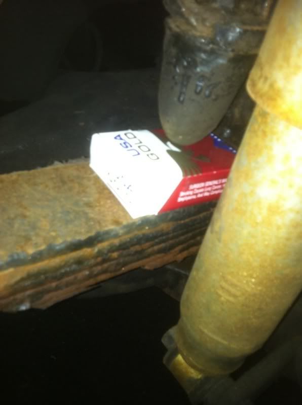

No stock height with standard saggy front. Zero rubbing.

Oh ok cool. I might even be able to get that size then before I level the truck.
If your front end is as saggy as mine, i bet your bumpstops are less than an inch off the springs... which will be a saving grace to your fenders ha ha

I just checked and I have an inch max as well.
slow_90firebird wrote:Oh ok cool. I might even be able to get that size then before I level the truck.
