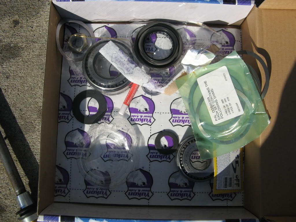

i got some new parts for a d71 ill sell ya for cheap to save ya some money if ya decide to rebuild it, not 100% sure what all is left, but here is a pic of it. if ya want it pm me.

Postby CumminsPower59 » Fri Dec 14, 2012 9:13 am
Well, it doesn't look like much can be salvaged, the gears are shot too. The ring and pinion look pretty good, along with the case and spider gear pins.

My inner cheapness is saying,buy clutches and the bearings it HAS to have and run it.......my "don't wanna break down in the middle of BFE" side says buy all of it. The cheapness would win ;)
Honestly.....I'd run it with what would make it live till my wallet got thicker

Postby CumminsPower59 » Fri Dec 14, 2012 11:17 am
I might just do that, besides maybe trying to tighten up the pinion a bit so that the seal would last more than a month... :?
