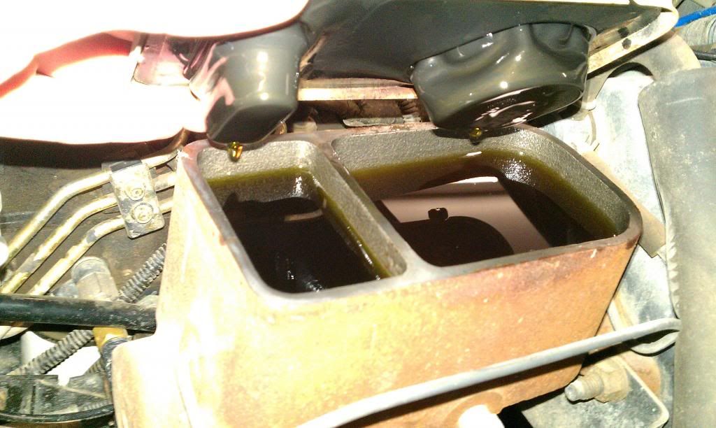

I checked my brake level thinking it might be high but it seems ok. You guys think i should add some?

Postby 93DodgeCummins » Tue Jan 22, 2013 4:24 pm
I pumped up the brakes and opened one the bleeders. Fluid just oozed out, but did not squirt so i dont think its my lines. Also the brakes did not fully disengage when i opened the bleeder either so im thinking it could be bad calipers.
