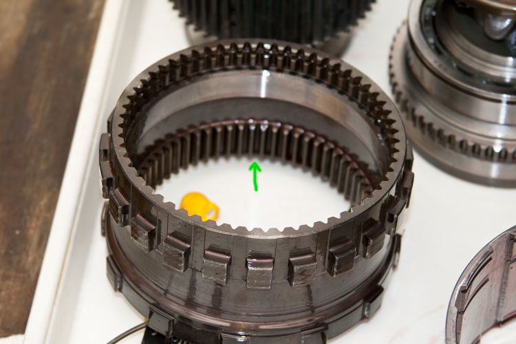

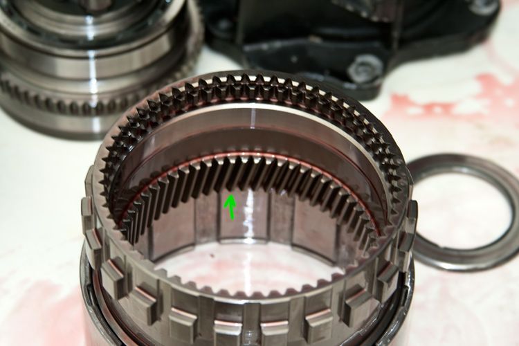

Stock/OEM Sun-gear TOP, 15* Sun-Gear BOTTOM:
Stock/OEM Spur OD Ring-gear.
15* Ring-gear.

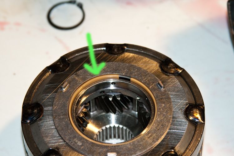

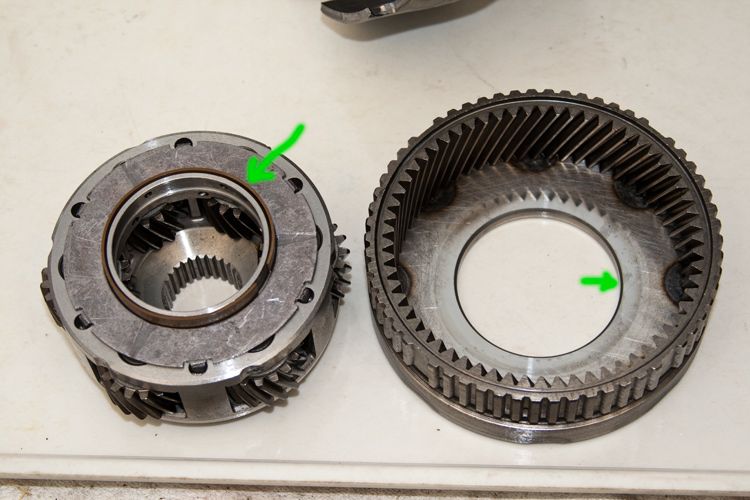

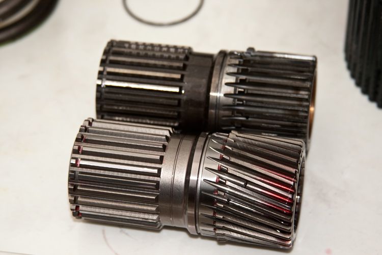

You must upgrade to the 2nd Gen intermediate shaft if you want a 5 or 6 pinion front planet (the splines between the two are changed). Also be aware that if you go to a steel front planetary gear-set, you'll need to get an additional (not OEM in the A518) plastic sleeve-bushing that fits between the front planet carrier and it's associated Ring-gear. (The aluminum OEM planet doesn't need it, switching to a steel-to-steel interface of the two, requires it).
Finally, be aware that the planetary gear-set thrust-washers became larger in diameter in the newer versions of this trans. You'll want to upgrade those as well but it's not critical.
In the following example, the front planet (as shown) has the newer, wider thrust-washer in place. Next to it is the front planet's rin-gear. You can see the foot-print of the OEM, narrower thrust-washer.
