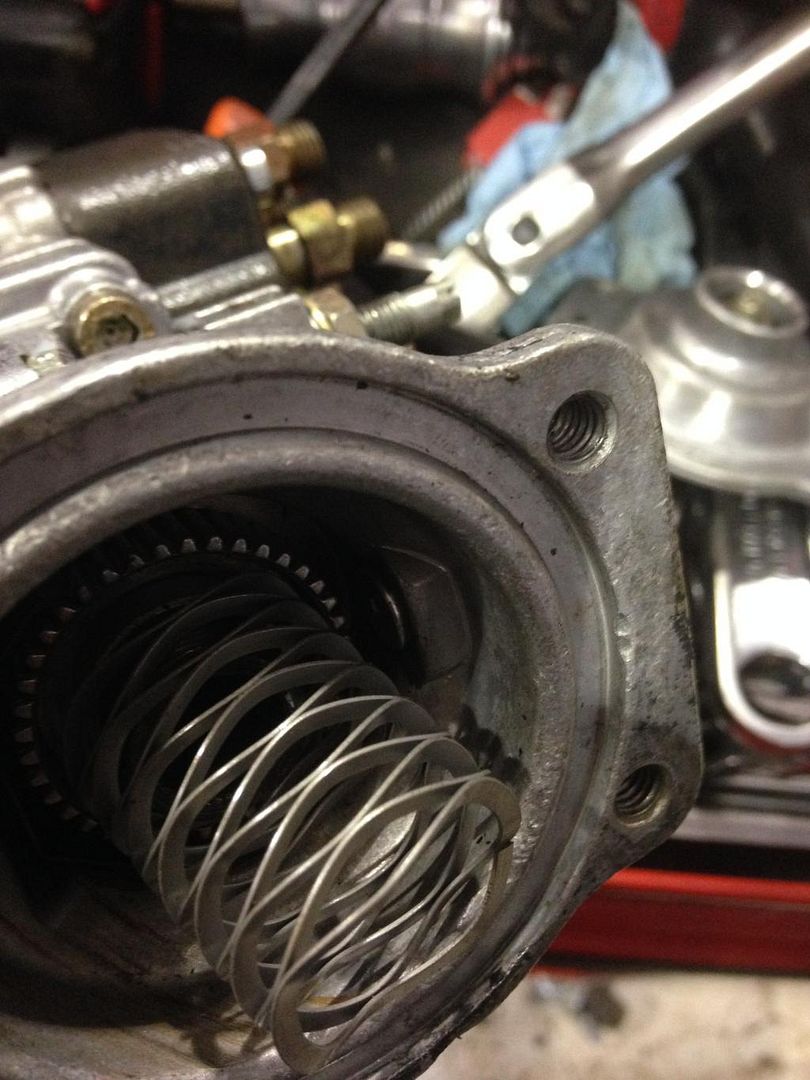

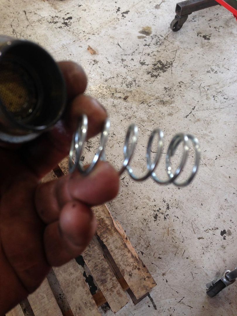

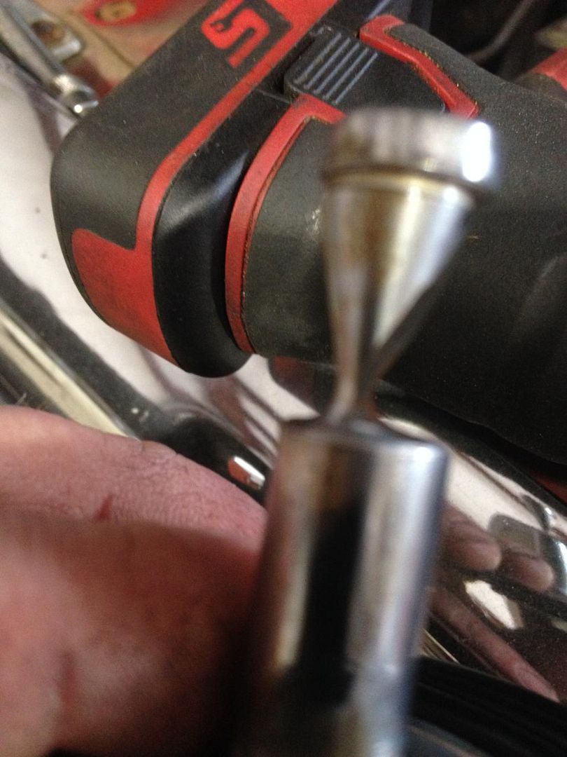

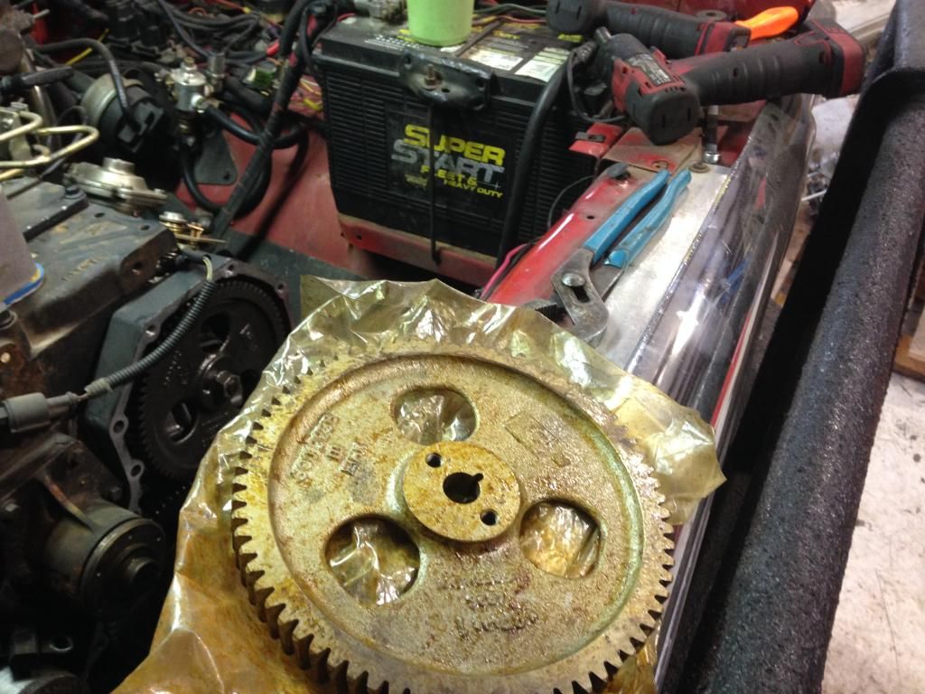

Went ahead and decided to kill the power some more.....plus I need the thing where it's not slowly killing itself. I owned this truck for 10 years before having any issues and since I've messed with it I keep having problems. Mostly small stuff...several ujoints,head gasket,clutch....I'm tired of it. It's going back working class. Stock low mileage pump,lightly ground pin,hungry diesel afc spring/12psi hplp spring (no mo clicking reg). Also throwing in a new old stock cummins pump gear(had some issues with the old one walking on the pump shaft) timed back stock. No more high timing,just the 1/8 bump.
Still has the goo on it
Hardly ground pin
Funky springImage
Supply pump spring
