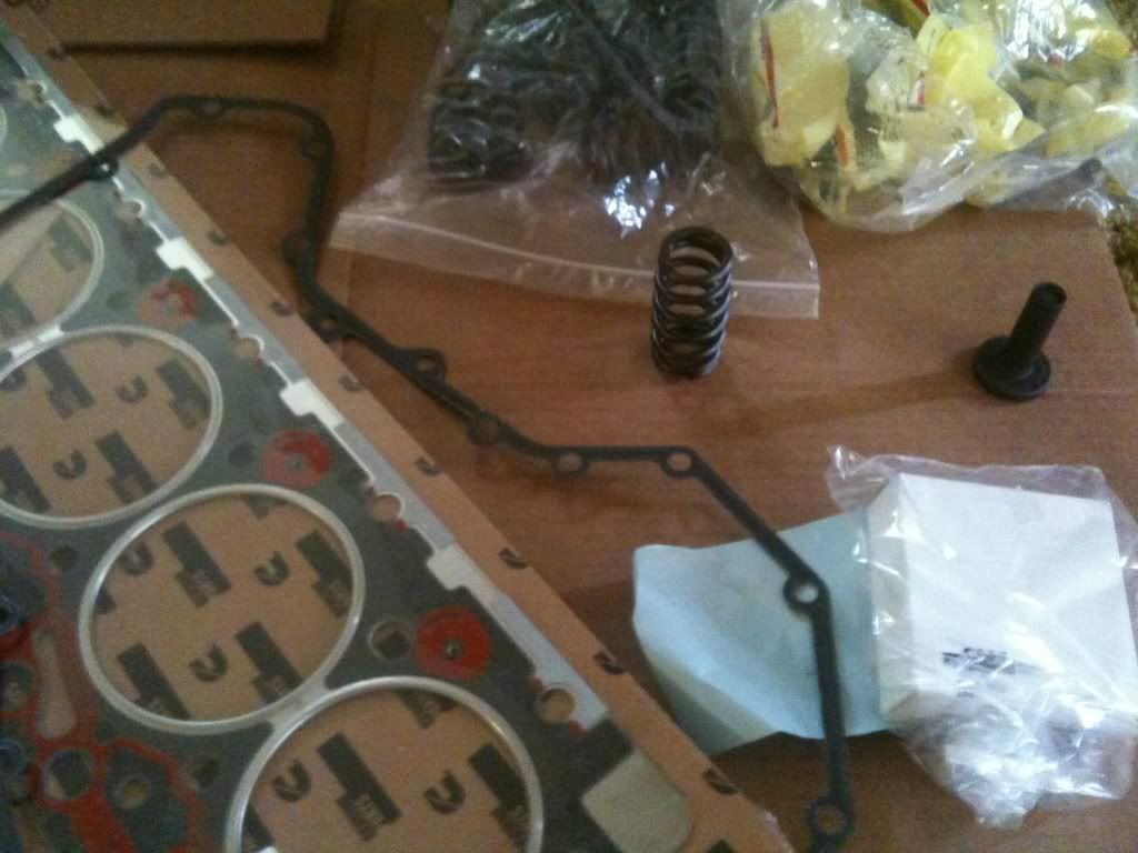

got all the stuff lined up for the cam swap?
Gona do valve springs while your in there? I ordered 60lb overs today, dont feel like coffing up the big money for hamilton stuff just yet.
what studs did you do?
Re: Next stage- Twins (last page)
Postby Tacoclaw » Fri Dec 30, 2011 7:41 am
Yup. I've got everything I need for the cam besides the actual cam itself.
I already grabbed some 60lb springs and I'm going to do A1 studs. I'm waiting to order them until I get a call about the cam.

why are you doing the headgasket? is it blown or are you just worried about it?
I'd like to see the bottom section of an A-1 stud and see if its got any more thread than an arp. I said it on CompD, but I did find that the ARP's bottomed on the shank of the thread before they got even close to bottoming in the block. I'd recon there is about 1/2 of an inch of extra thread in the block (at least) that the arp's do not use. Seems like BC hit thr nail on the head when he said ARP just took a variety of studs that "kind-of" work and called it a kit.
that being said, if the A-1's have more that 1 inch of thread on the bottom of the stud...then they are definently better than ARP's.
What did you work out for tools to do the cam swap? if your going to have the head off, I would do the lifter install then. Biggest PITA of the cam swap job was dropping the lifter install plug down the head and through the lifter bore. it would be 100% easier with the head off. BTW the engine has to be level otherwise you will never get the string down the hole.
either way... better pay someone in beer, its a bitch of a job to do alone
Postby Tacoclaw » Fri Dec 30, 2011 5:31 pm
one other issue with just making the threads longer is the load will still be placed in the same spot as it is now.
with the grade of fasteners we are using about 35% of the load is placed on the first fully engaged thread, then goes down and is about 5% by thread 6. This does not help us with getting a lower "bite" into the meatier part of the block
A quote off Turboford.org on a thread about longer studs there. I don't know what material our/their studs are, but it makes sense to me that the stud will stretch as it's tightened and that will put the most load on the first few threads. There's a point of diminishing return with longer studs, and I wouldn't be surprised if it's a lot shorter than even the ARP studs are. Regardless, I'm getting the A1s since I know they'll fit and I won't have to worry about leaving enough thread out for the nut. It's probably extremely simple, but not something I'm willing to risk.
I'm just replacing the HG for peace of mind. This one has over 200k miles on it so I wouldn't reuse it even if it looked brand new. I do plan on doing it all at once, since I'll have the head off anyways. I don't have any tools sorted out yet, but I'll get around to it soon. I've got a whole winter to burn, so I'm not beating myself up yet. :grin:

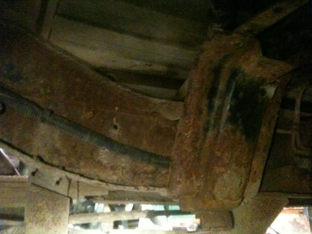

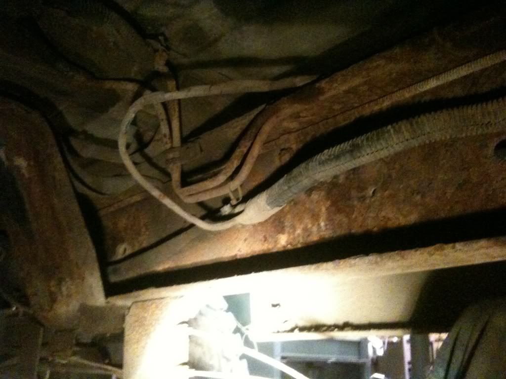

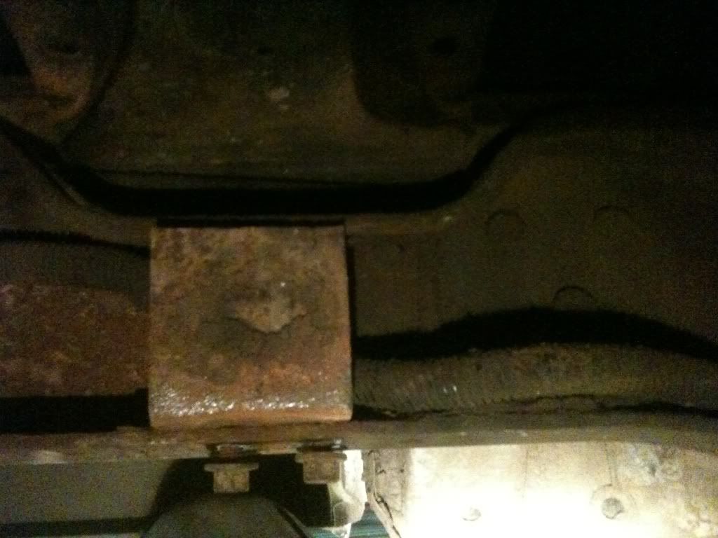

I found a big cancer spot on the framerail behind my tank. My external lubrication system has kept the frame completely rust free, but it must not make it back here. Here's the line where the oil stops and the tank starts.
It just gets worse from there 'till the other end of the tank.

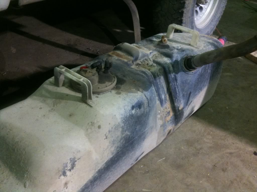

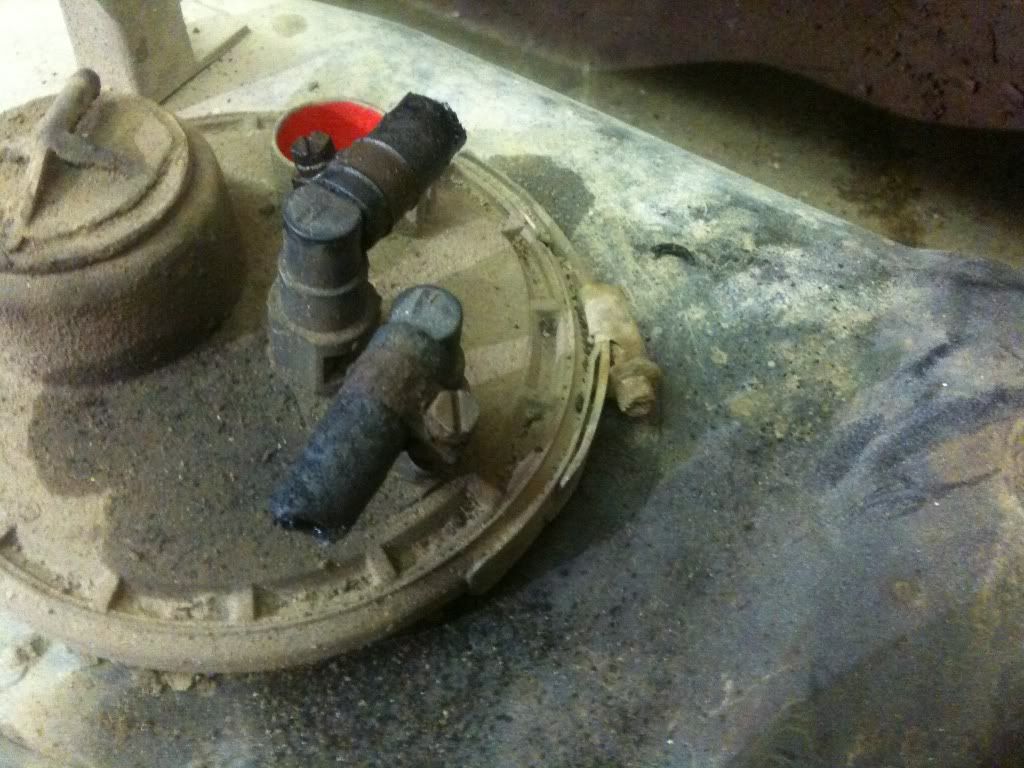

First surprise was the steel screw clamp that held my lid on. I assumed it'd be one of the big plastic nuts that pop right off with some taps from a drift. Not this fellow, this was a 1/2 hour long battle between rust, penetrating oil, brake cleaner, and a 6 point socket. I emerged victorious, though the emotional scars may stay with me years from now...

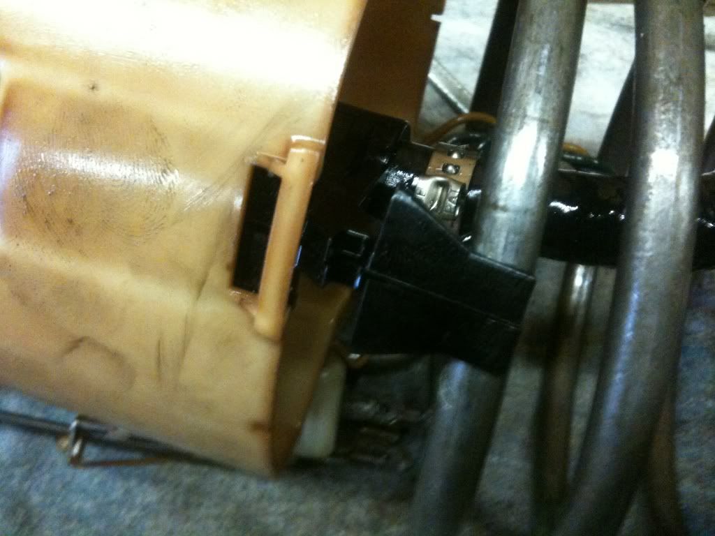

Finally wriggled the sender out of the tank and got it on the table. To pop the plastic piece off the bottom you just loosen this holder
and this one as well

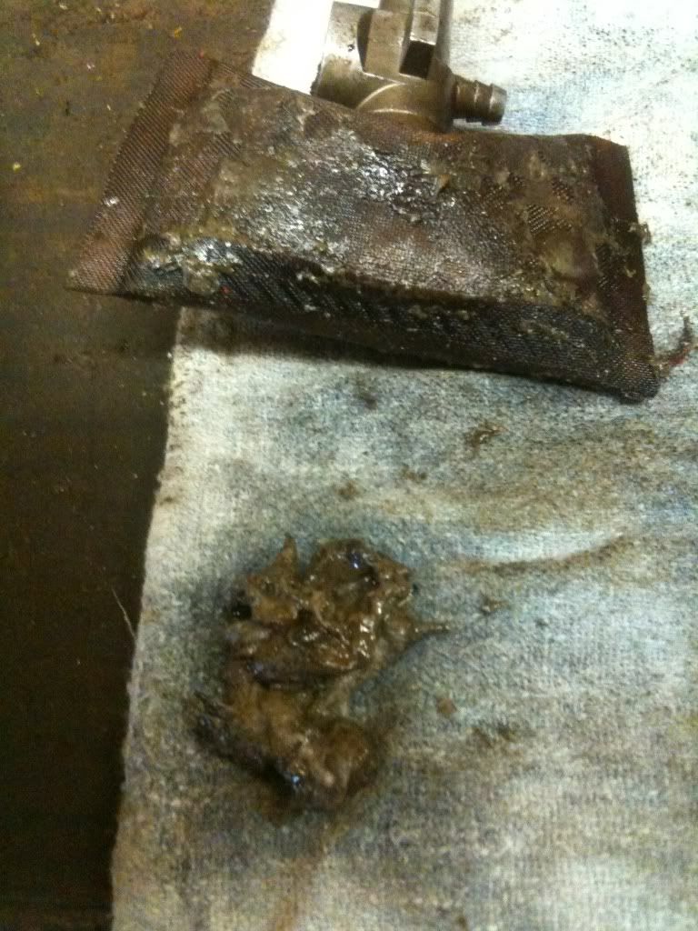

Then you get to enjoy whatever is stuck to your inlet screen. I hope yours doesn't look like mine.
I scraped all the clear goopy stuff off and piled it up, then took a pic of the actual dirt/grit in the screen

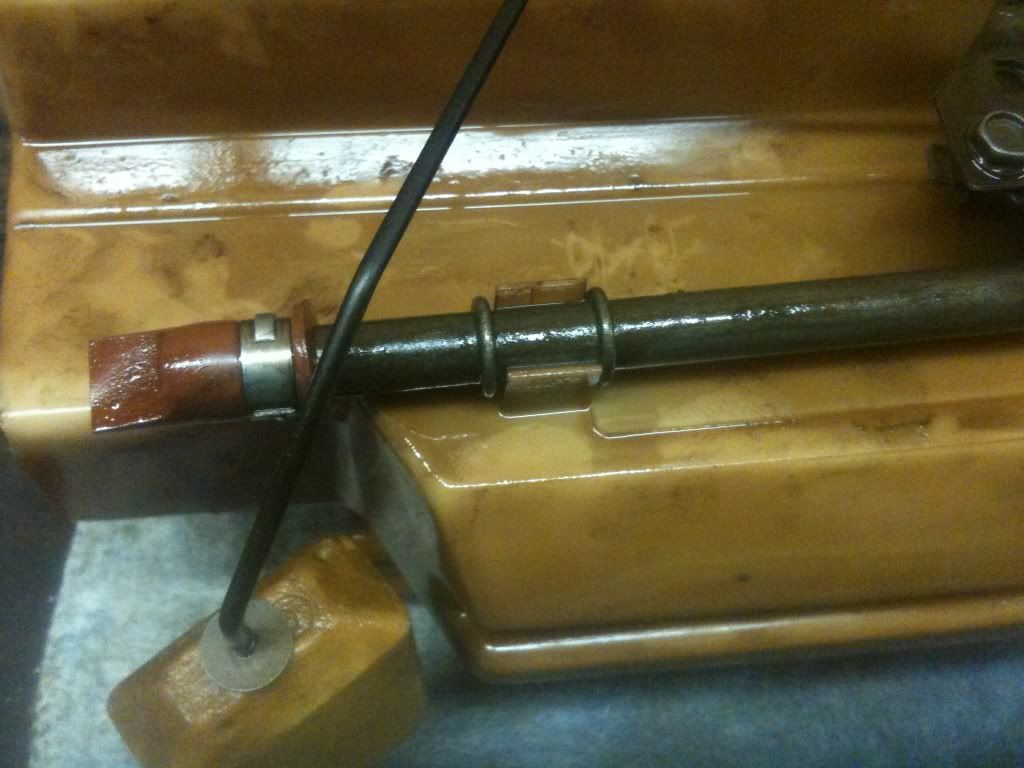

And here's the bypass valve that gets used if the screen gets clogged. I may need a bypass for my bypass...
I'm brainstorming ideas for how to run the big line in there while retaining the bypass and perhaps the screen, if I can find a new one. I've read the sticky on it at DTR, but I may go in a slightly different direction with mine.

my frame was the same way behind the tank except worse.
