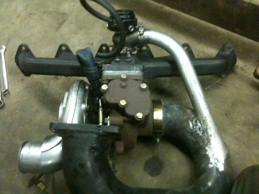

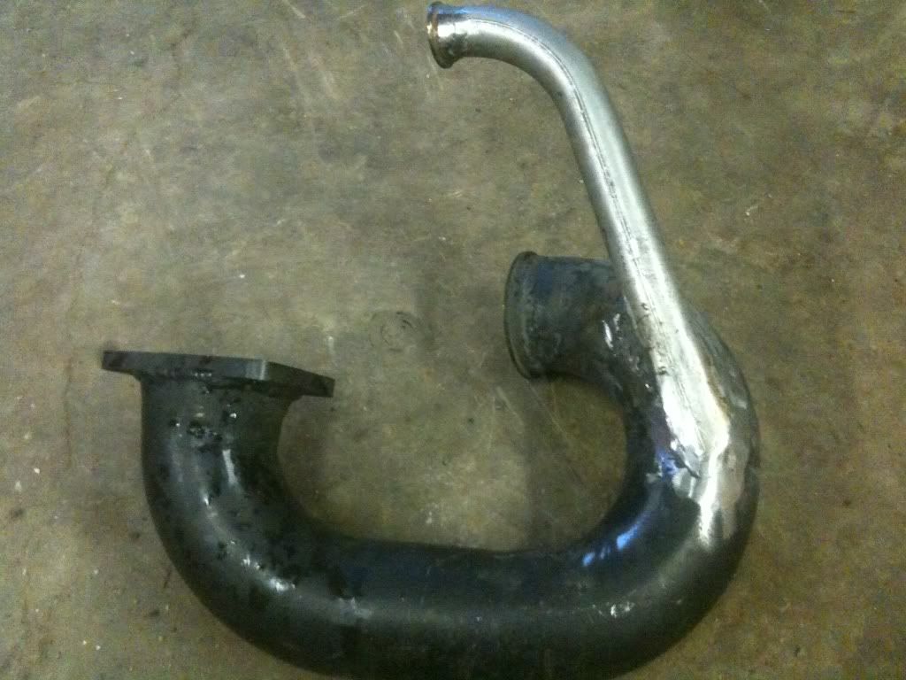

Anyways, we welded up my wastegate dump. Used a stick and my cousin refuses to find a chipping hammer so it's completely full of holes. :lol: I'll mig them over this weekend and grind it down pretty.
Whatever, at least it lines up and seals. I started playing with my intake piping too, but had to pull the head back off to clean the surface and get ready for the cam swap. This whole 90*-fest looks doable. 8)
