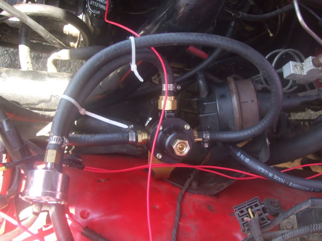

Just to give you a general idea of its location:

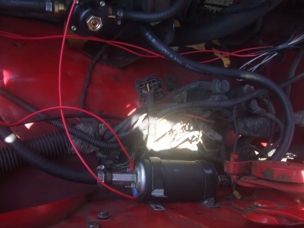

The pumps location. This it where (I assumed) a relay went but there was no clip....
The Regulator:

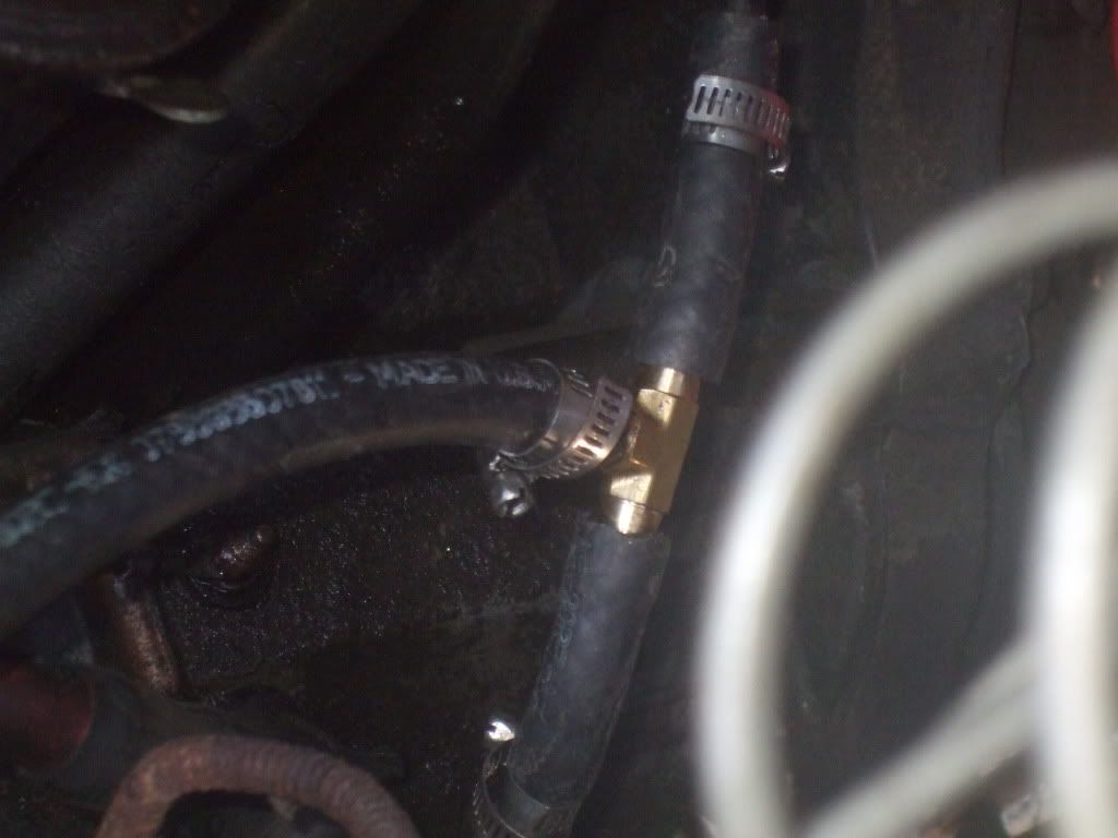

How I Tee'd in the return:

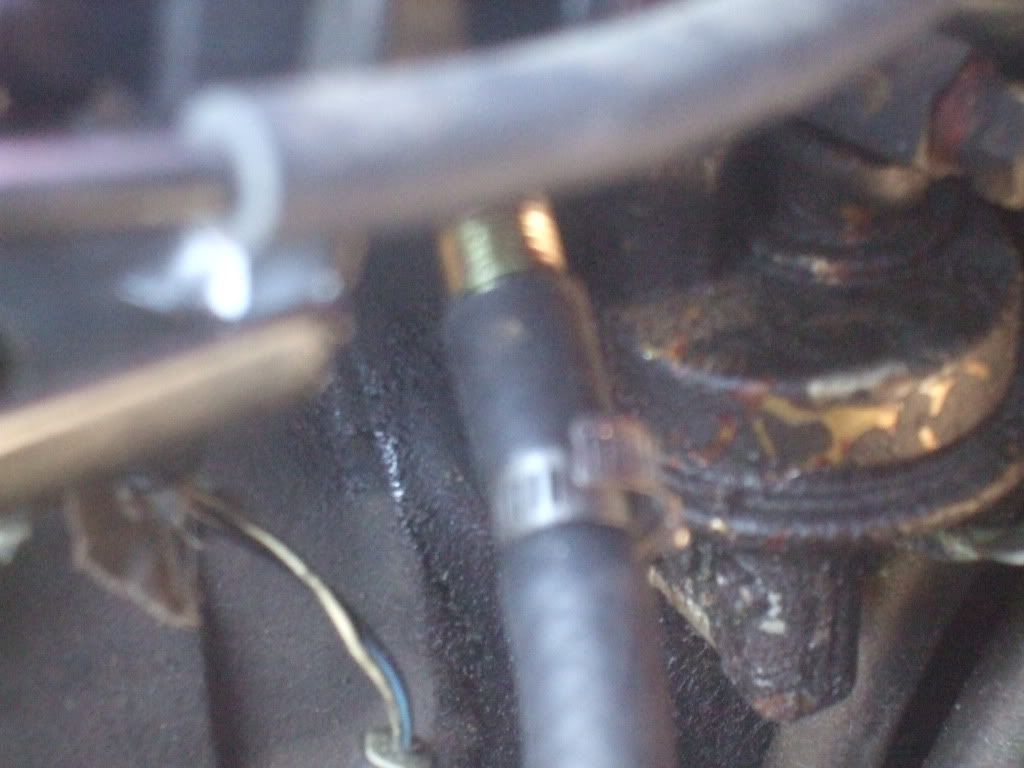

This is the line I bent outwards away from the LP. Notice the bulge right before the clamp. That is what seals the stock LP like a compression fitting.

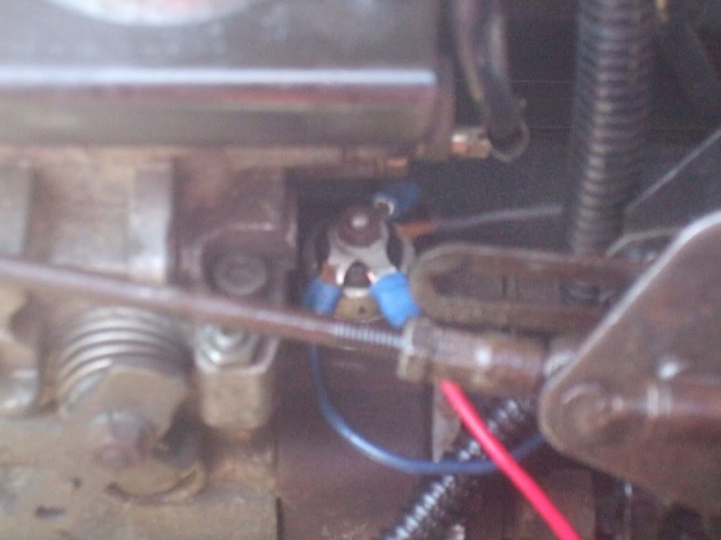

My power source:

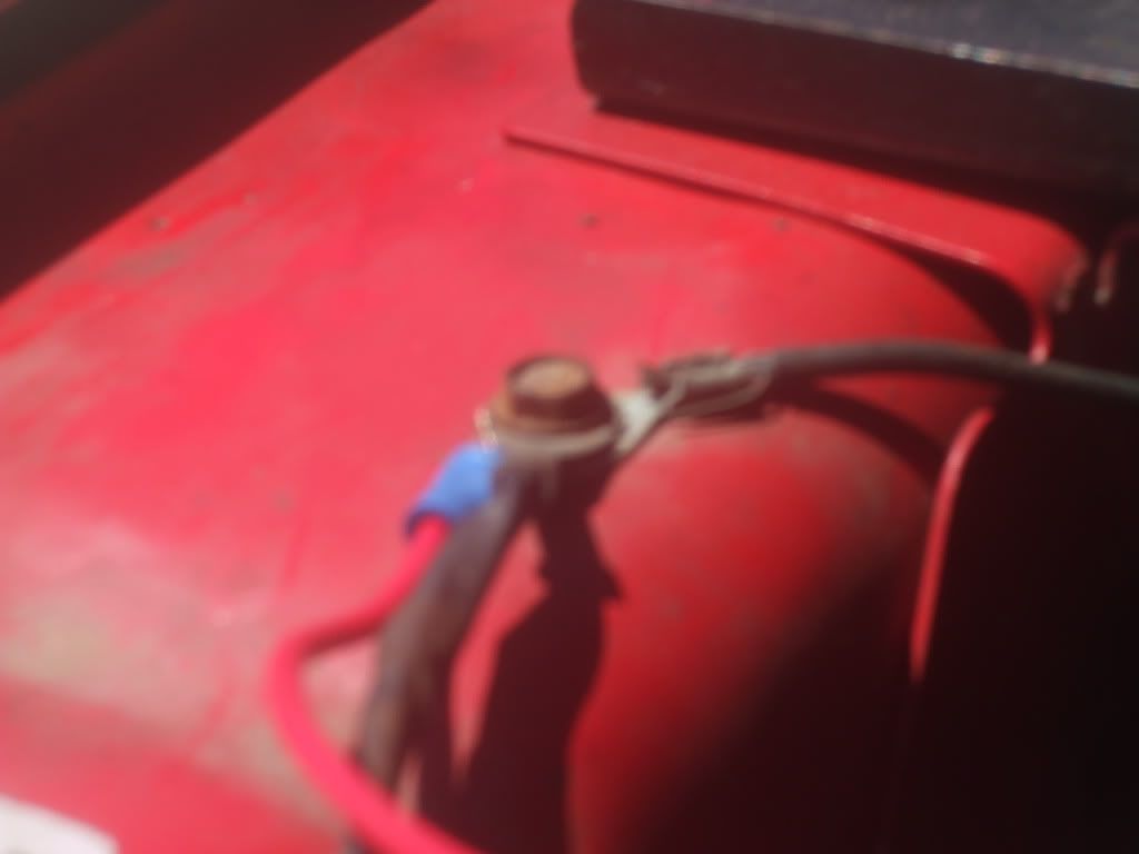

Ground:

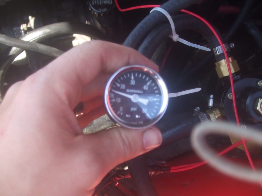

I HAVE PRESSURE!

Jon, you're running that pump off the shut off solenoid? :shock: You need to get a relay on that and activate the relay from there. The wires feeding the shut off are pretty small, you may melt them. You can get hot power for the relay from the grid solenoids, big wires and they're right there near the pump.
Re: Walrbo and Mallory installed!
Postby oldestof11 » Sun Jun 06, 2010 4:59 pm
The wire from the pump to the solenoid is the same size. I will get it finished as soon as I find that relay I bought 3 months ago but misplaced....
