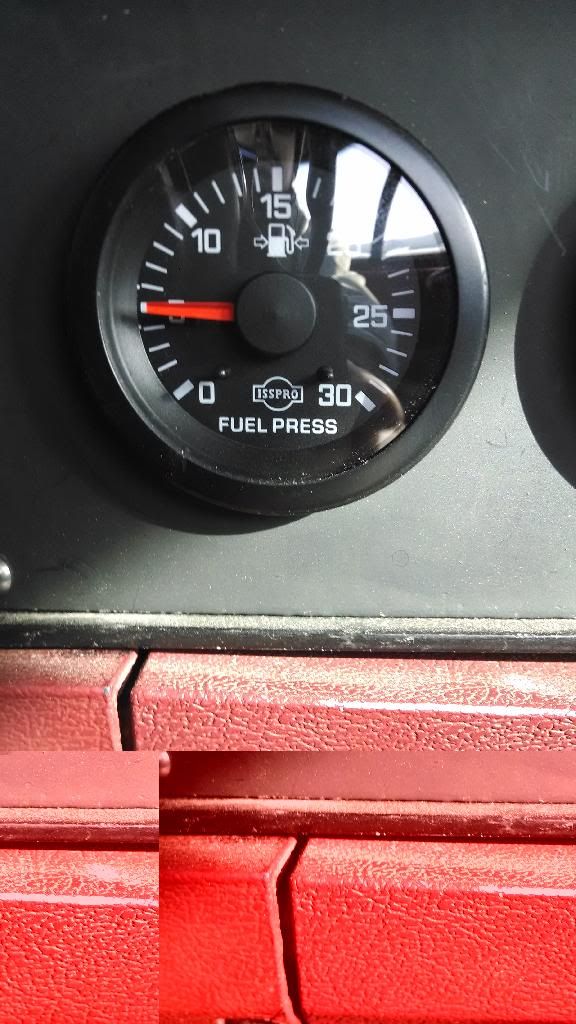

Well, I put 5 gallons of kerosene and 20 gallons of #2 in the tank, still got crap for fuel pressure...on it's second filter now, fixin to put on another new one...
This is what the gauge read on my way to work this afternoon...

As long as it's reading, it's ok. ;) The kero shouldn't make the pressure drop, I wonder if you have a blockage? You have the piston LP right? Do you have a strainer before the LP? In not, pull the inlet fitting to the LP and see if the screen is plugged in the inlet fitting.

PToombs wrote:As long as it's reading, it's ok. ;) The kero shouldn't make the pressure drop, I wonder if you have a blockage? You have the piston LP right? Do you have a strainer before the LP? In not, pull the inlet fitting to the LP and see if the screen is plugged in the inlet fitting.
I got a piston LP from the Hungry Diesel, I pulled the strainer a few weeks ago as it was catching all the chunks of wax and plugging. I might mess with it tomorrow, see what the screen looks like. If I had a way of heating that strainer, I'd run it. I was planning on putting it back on mid March or so...

CumminsPower59 wrote:This is what the gauge read on my way to work this afternoon...
If you find an issue with the pump itself, let me know.
Postby CumminsPower59 » Tue Feb 04, 2014 11:02 am
Will do.
