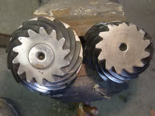

The 3:07 is called a Dana 71. It has the pinion offset about 1/2" to the passenger side of the axle. Here is a pic of a 3:07 pinion beside a 3:54 pinion.

You mean what's left of a 3.54 pinion. :mrgreen:

Postby Philip » Thu Mar 22, 2012 5:30 pm
Tacoclaw wrote:You mean what's left of a 3.54 pinion. :mrgreen:
Hea that is a lite weight model pinion. :lol: :lol:
Re: axle ratio
Postby PToombs » Fri Mar 23, 2012 5:40 pm
No, that's the medium weight pinion. The lite weight one has no teeth on it. :lol:
