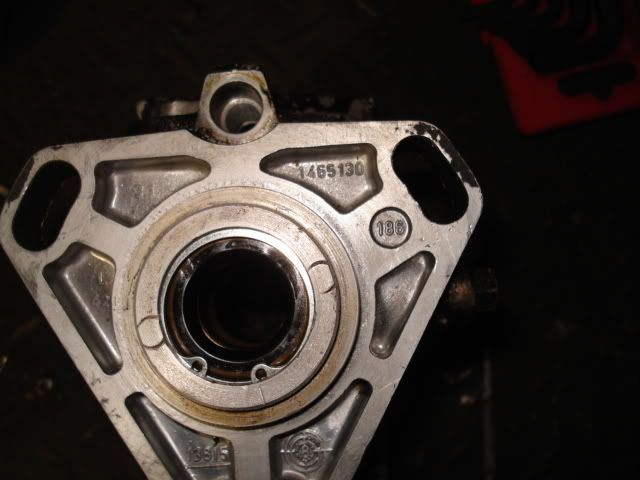

k i called them today and they have no more do you got an extra 4mm mr ford that you want to get ride of,
i got seal set back to day and a ring instaled want some pics
check my photo bucket page out below theres alot more

i have that done on mine but it will still seep around the shaft at high pressure but it does keep it from blowin out thats why i am still workin on gettin this double lip seal. if an ac compressor can see 200psi and keep a seal i think it would work fine for our application

have you tryed putting a thin space washer between the seal and the ring to keep every thing nice and tight
