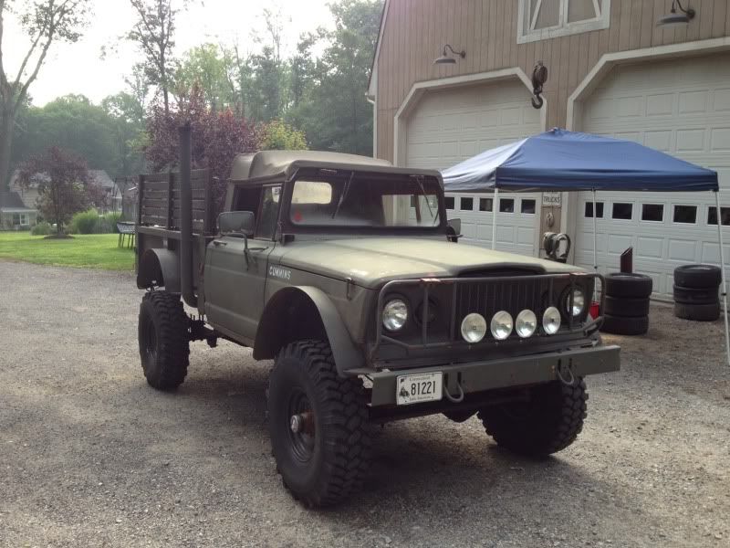

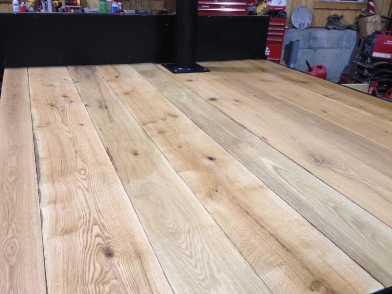

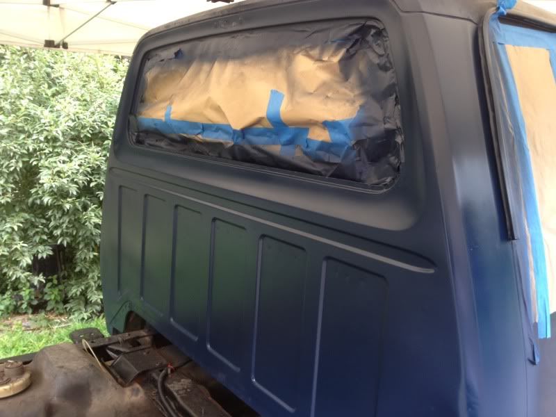

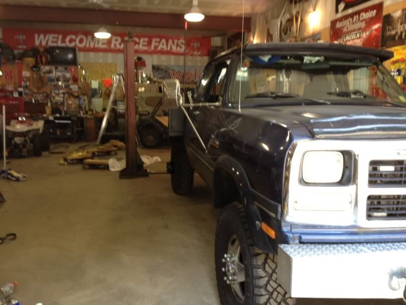

Hey gents got some more done today.
Here's my m715 4bt powered with an hx35 for those who commented

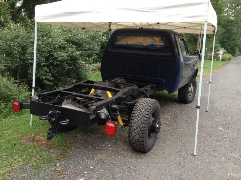

I sprayed the rear of the truck the color it will all be
And here's the new lights

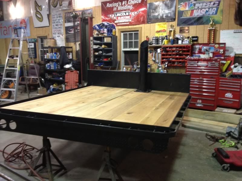

Got a lot more wood done, still one last board to get in
And here's the stack all mounted. Two of the bolts by some stroke of luck lined up with the angle iron beneath the wood
Hoping to finish the wood tomorrow and mount the bed

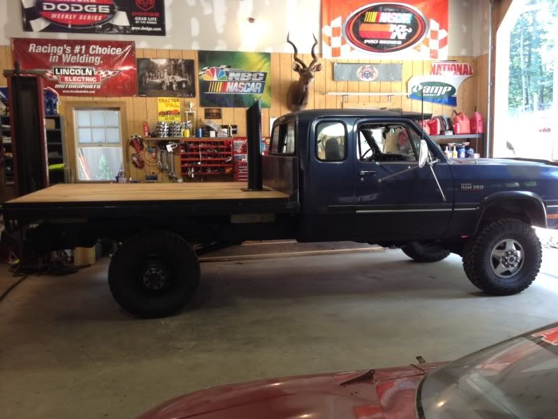

Postby Burritoboi5 » Sat Aug 04, 2012 12:46 pm

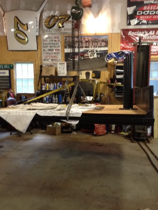

Got her on today gents.
Here's our lifting aparratus
Got the rear glass in again and made the spacers for the frame. Monday I'll get the Ubolts to hold her down.
Kriv

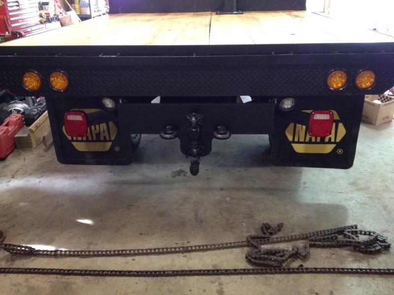

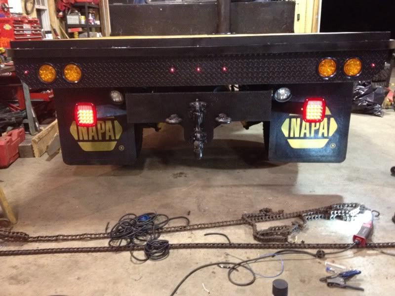

Postby Burritoboi5 » Mon Aug 06, 2012 9:18 pm

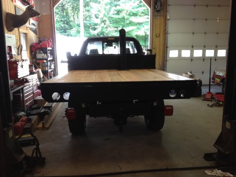

Hey Gents, I got the u bolts made today and the bed is securely in place. I also mounted and wired my rear clearance/marker lights. They're 3/4 round LEDs. They are a little brighter than they look in the picture.
-Kriv

looks pretty good, but can we see a pick with both rear wheels on it? how wide is that bed? does the bed cover the wheels? also if you only bolted the bed on with u-bolts, you should start thinking about welding a plate onto the channels that ride on top of the frame and then bolt it to the frame. otherwise if that bed gets hit your cab is going to be in trouble.also beds and boxes held on with u-bolts usually have complete contact along the entire length of the frame with a wood isolator in between. take a look at any medium duty truck and see how they do it. can you show some detail pics of the u-bolts and spacers? sounds like you kinda mixed bolt on and u-bolt on methodology. at any rate you need the plates to be safe(r).

Postby Burritoboi5 » Tue Aug 07, 2012 9:21 pm
comotionman wrote:looks pretty good, but can we see a pick with both rear wheels on it? how wide is that bed? does the bed cover the wheels? also if you only bolted the bed on with u-bolts, you should start thinking about welding a plate onto the channels that ride on top of the frame and then bolt it to the frame. otherwise if that bed gets hit your cab is going to be in trouble.also beds and boxes held on with u-bolts usually have complete contact along the entire length of the frame with a wood isolator in between. take a look at any medium duty truck and see how they do it. can you show some detail pics of the u-bolts and spacers? sounds like you kinda mixed bolt on and u-bolt on methodology. at any rate you need the plates to be safe(r).
Having my new wheels mounted tomorrow so pics of all six on the ground then. It should cover both of them based on my measurements though.
Also, the rear mounts are U bolts, and the front are 1/4 plate with 9/16th grade 8 hardware welded to the frame. Couldn't fit a Ubolt between the driver side front frame rail and the tank even if I wanted to. My spacer are wooden, and 2 feet long in the front and rear as well as the middle hump section for contact everywhere except the rise/run sections.
